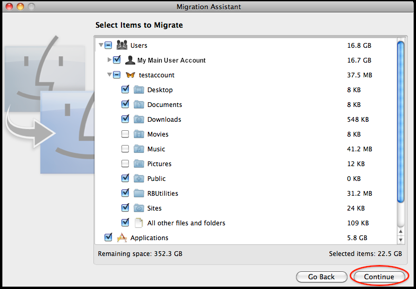

Sorry if i'm a bit slow! Can I chose which folders to move? My current Mac Pro has a 2 TB drive and my new iMac has a 500GB SSD so I'm concerned about getting the right folders moved to the SSD.
Yes... with some limitations. Once you start you will get to this screen where you can click to see the users folders. Then within that you could choose to migrate say Pictures but not Documents for example. But the choices in this screen are all you get.
