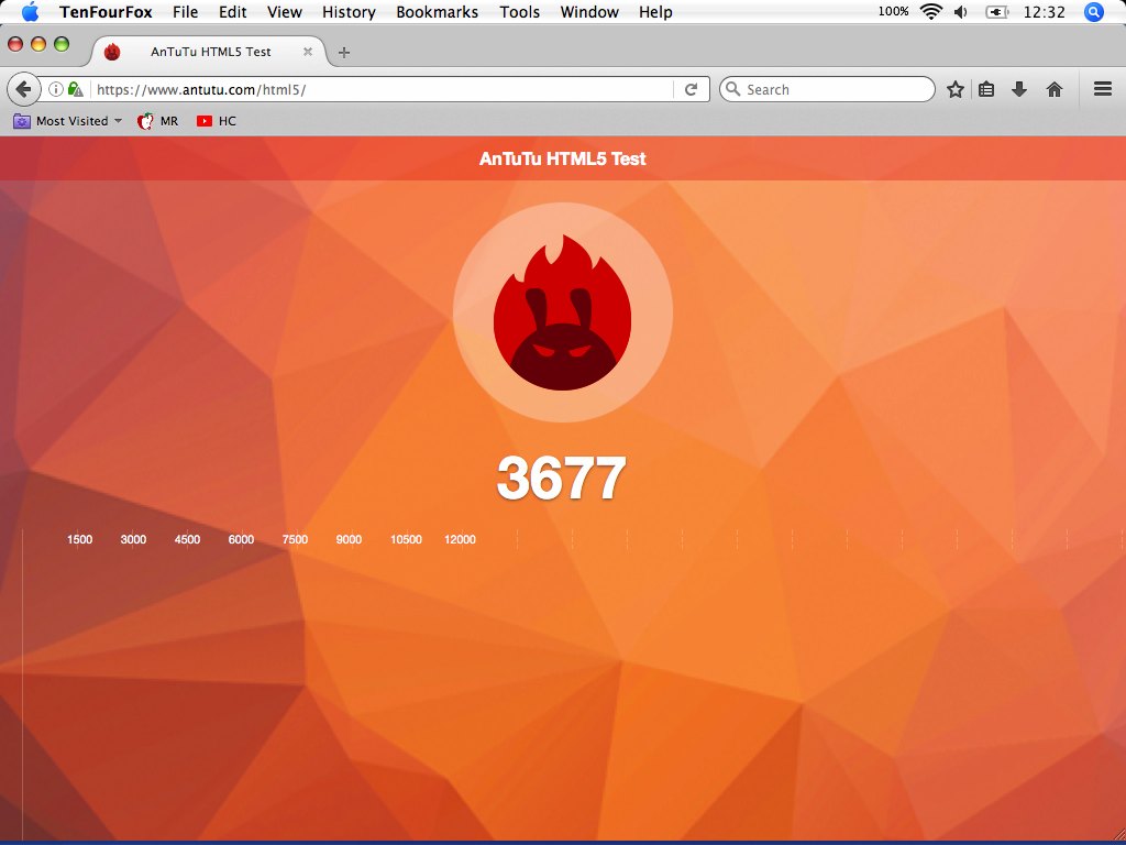

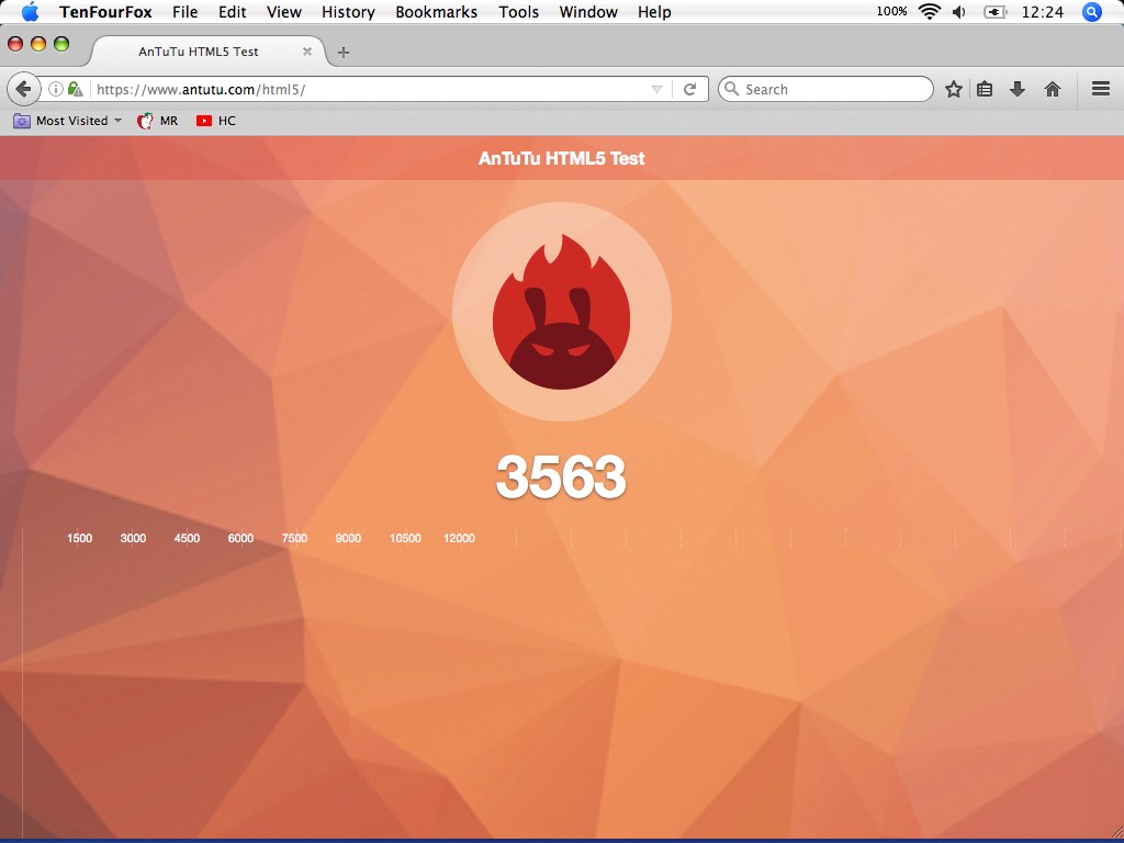

Gave it another go on my 1.33 Powerbook - first trying the Antutu HTML5 benchmark which gives rather bizarre results with UOC coming bottom below stock and my own tweaks.
However, I can verify now the latest UOC definitely improves Youtube playback without a doubt and although I wouldn't dream of playing HTML5 Youtube video on a portable with the CPU blasting away at 100% it will obviously reap benefits on multi G4/G5s.
UOC
Stock
Personal
