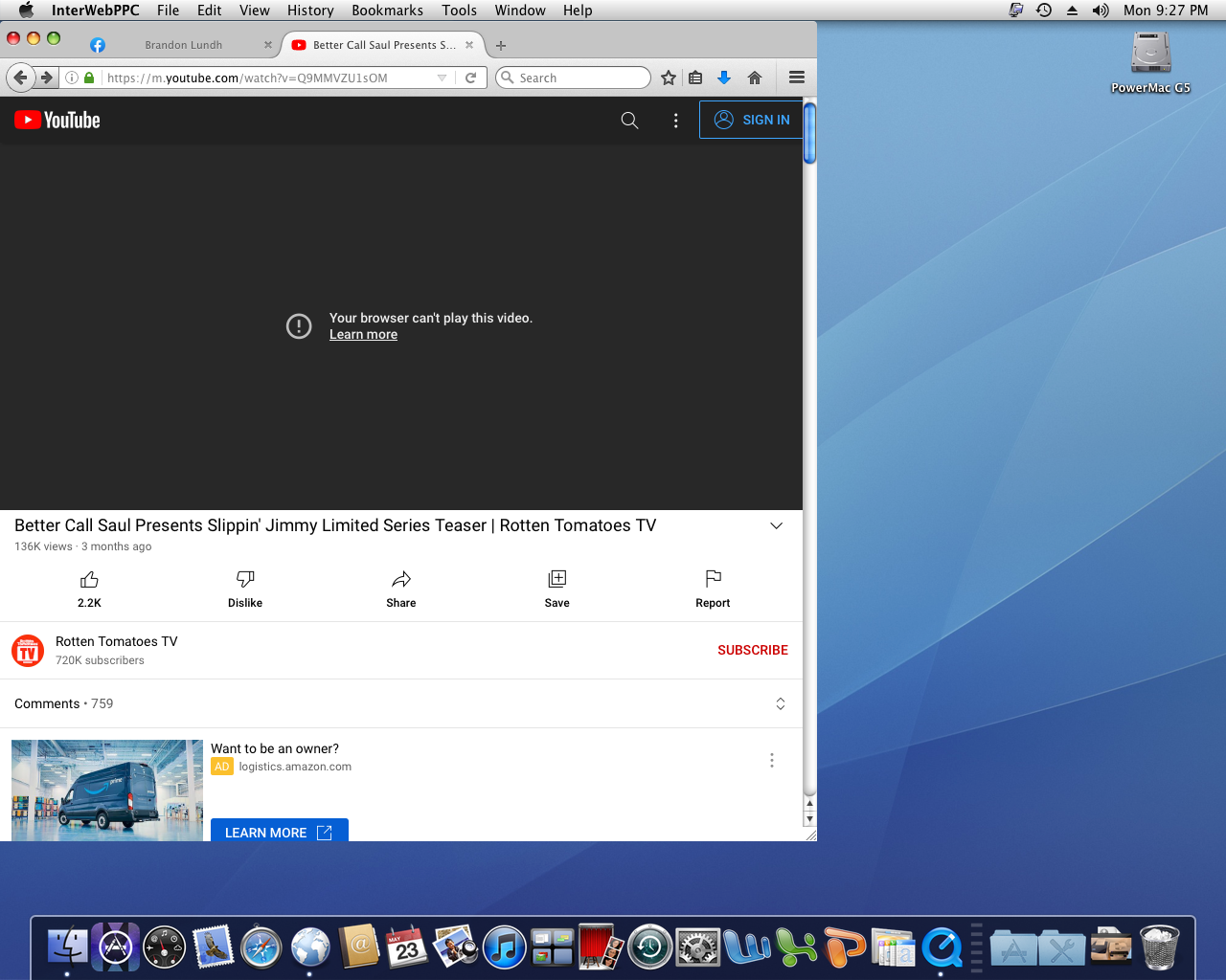

Since I installed TenFourFoxPEP on InterwebPPC, YouTube will not work. I am using a Power Mac G5 1.8 DP.
EDIT- I tried it on Safari, I am using Sorbet Leopard v1.5, and it worked just fine. Maybe I confused InterWebPPC with Safari.
@ww2_1943 The TenFourFoxPEP download page explicitly mentions needing the TenFourFox MP4 Enabler to stream online video whenever using a TenFourFoxPEP-boosted browser.
It's an additional (but necessary) step in the installation process, because online video playback will be much faster as a result.
Reactions: ww2_1943
It's an additional step in the installation process, but a necessary one because online video playback will be much faster as a result.
I must’ve glanced right over it! 🤦🏻‍♂️
I’ll install that tomorrow.
I appreciate the response! And Sorbet Leopard!
