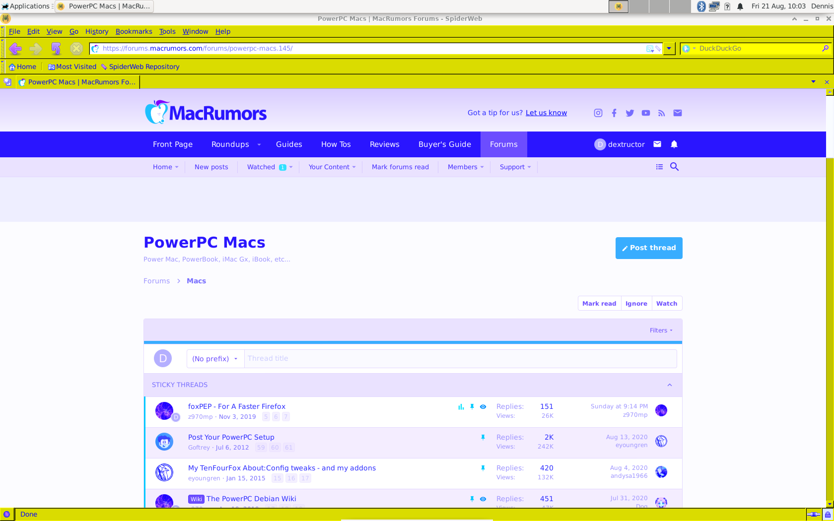

Hi @z970mp
I'm finally testing foxPEP on my A1139 with VoidLinux (5.7.15_1 glibc) and so far both Arcticfox(27.10.1) and SpiderWeb(2.2.2) presented some errors.
With SpiderWeb if I use ("layers.acceleration.force-enabled", true) the colors will be a mess (see the screenshot)
In Arcticfox if I use ("gfx.content.azure.backends", "direct2d1.1,skia,cg,cairo") the program crashes without starting (see crash below) but if I use on this specific preference the value "cg,cairo" works fine.
[32660] ###!!! ABORT: Could not initialize mScreenReferenceDrawTarget: file /home/matt/Development/Arctic-Fox-27.10.1/gfx/thebes/gfxPlatform.cpp, line 521 [32660] ###!!! ABORT: Could not initialize mScreenReferenceDrawTarget: file /home/matt/Development/Arctic-Fox-27.10.1/gfx/thebes/gfxPlatform.cpp, line 521 Segmentation fault
Since I aways copy the prefs.js to the destination folder and both of the browsers had some issues I tested every single entry on the about:config to isolate the problems but some lines wasn't present until I manually inserted on the prefs.js file. Below are the specific lines there wasn't present in each browser.
Arcticfox
gl.multithreaded, true layers.acceleration.enabled, true gfx.webrender.all, true layout.frame_rate.precise, true datareporting.policy.dataSubmissionEnabled, false media.navigator.enabled, false media.peerconnection.enabled, false network.http.referer.XOriginTrimmingPolicy, 1 privacy.firstparty.isolate, true) privacy.trackingprotection.cryptomining.enabled, true privacy.trackingprotection.fingerprinting.enabled, true network.dns.localDomains
SpiderWeb
gl.multithreaded, true image.mem.max_ms_before_yield, 0 image.onload.decode.limit, 0 layers.acceleration.enabled, true nglayout.initialpaint.delay, 0 gfx.webrender.all, true browser.tabs.animate, false browser.urlbar.delay, 0 datareporting.policy.dataSubmissionEnabled, false experiments.enabled, false media.navigator.enabled, false media.peerconnection.enabled, false privacy.firstparty.isolate, true privacy.trackingprotection.cryptomining.enabled, true privacy.trackingprotection.fingerprinting.enabled, true social.remote-install.enabled, false social.toast-notifications.enabled, false
There is any problem with manually inset any if the aren't present in the original? So far the performance and fluidity on the SpiderWeb exceed my expectations. I hope that some information could be useful to the future of the project.
@dextructor Although neither Arctic Fox nor SpiderWeb are officially supported browsers for foxPEP (for the reasons you discovered), I applaud your diligence and experimentation to attempt a working state in addition to compiling this information.
Arctic Fox does not launch with 'Skia' clarified as a content / canvas backend because the browser has been compiled without any support for Skia. And as for cg, it sees it as an unknown and instead falls back onto Cairo. The backend "cg" stands for Core Graphics, a native rendering library exclusive to OS X (which is faster than Cairo, but slower than Skia). If you are going to make a custom rendition for the aforementioned browsers, then it serves no place there.
I believe SpiderWeb does not support hardware acceleration due to an endianness anomaly, but I'm not totally 100% on that. In that case, that is a library / compilation issue.
