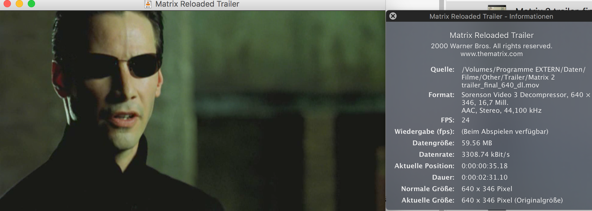

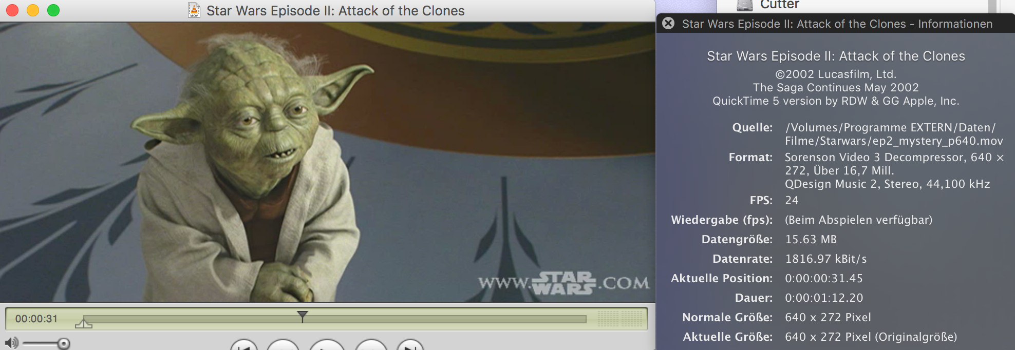

Older codecs like Sorenson or Cinepak are also options - but their file sizes will be far larger for a given resolution than any of the MPEG-2 or newer. Note that a G3 can play a 1080p Sorenson just fine, though. I remember watching a movie trailer on a G3 back in '99 that was available in 1080p - either The Matrix or Star Wars Episode I. (It was a B&W G3 connected to a high-end CRT that could be forced in to 1920x1600 mode at 48 Hz or something -*JUST* acceptable for watching 24fps movie trailers.)
Your memory plays a joke on you. All Sorenson 1 videos were normally at 480 wide, Sorenson 3 comes also in 640 wide

Ah, it was The Matrix Reloaded, and was 1000x540. Which still seems wrong. I know there was some trailer released at higher resolution than the 1280x1024 that was my normal resolution when I still used a CRT...

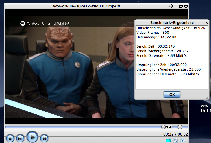

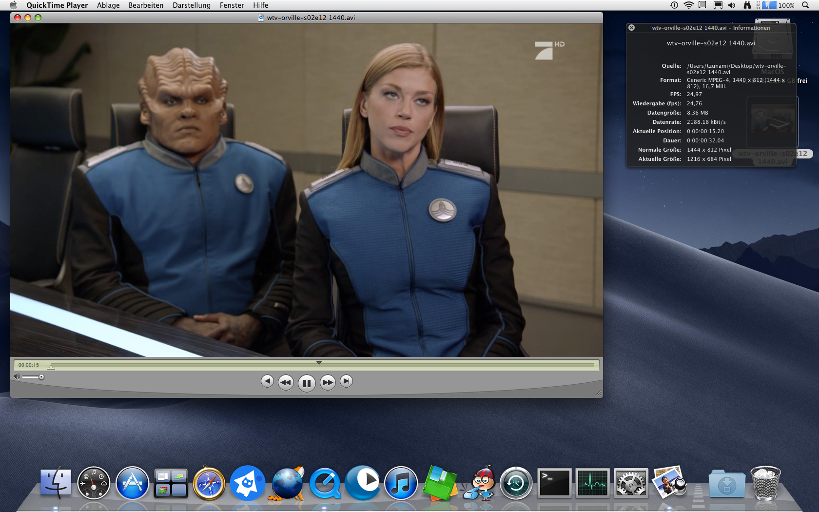

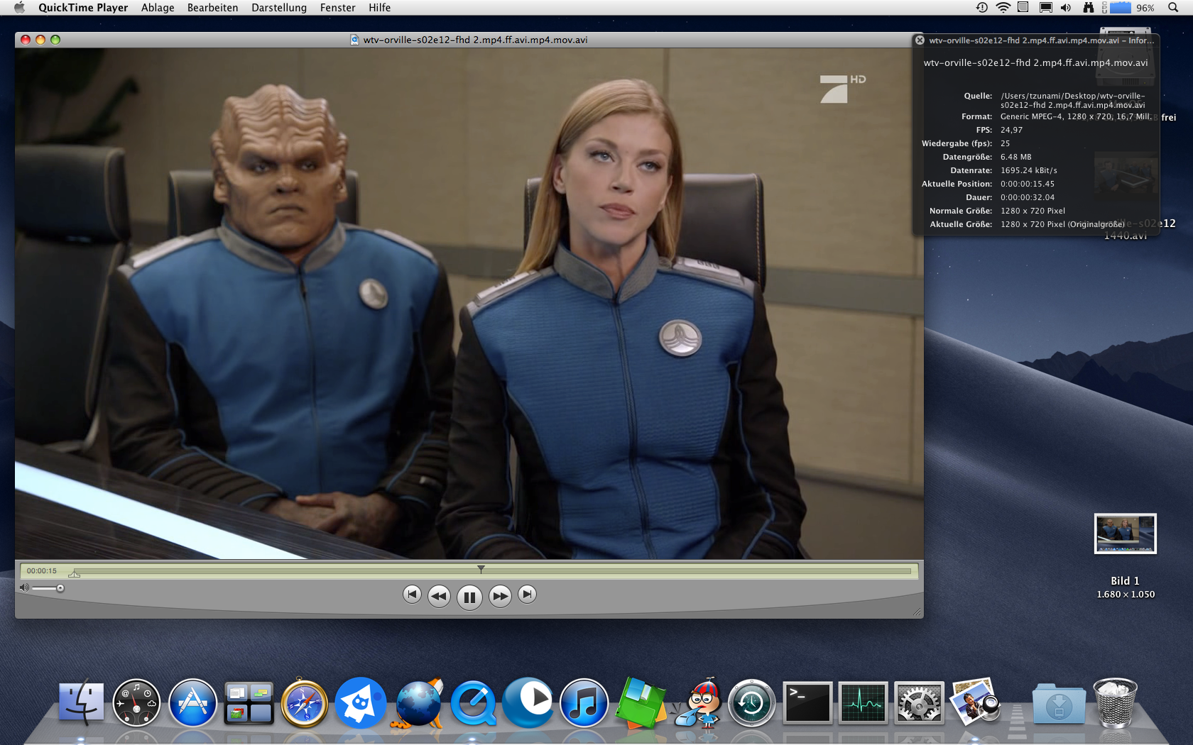

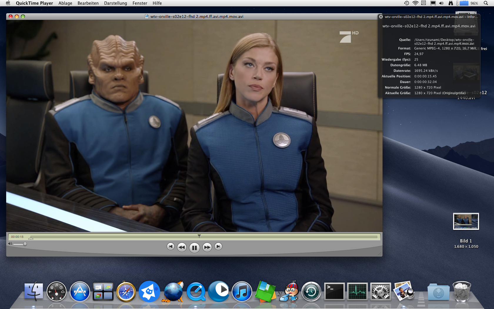

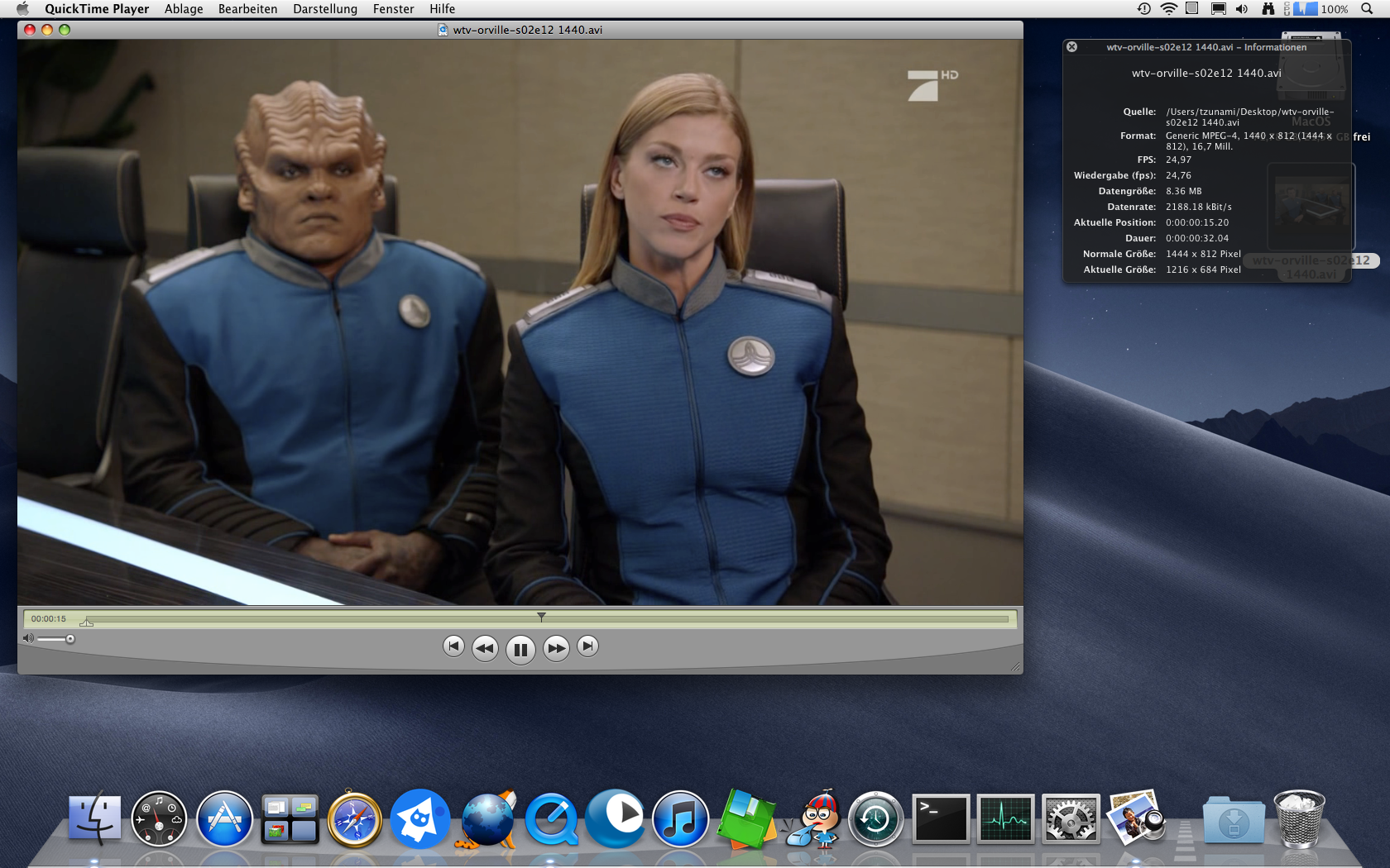

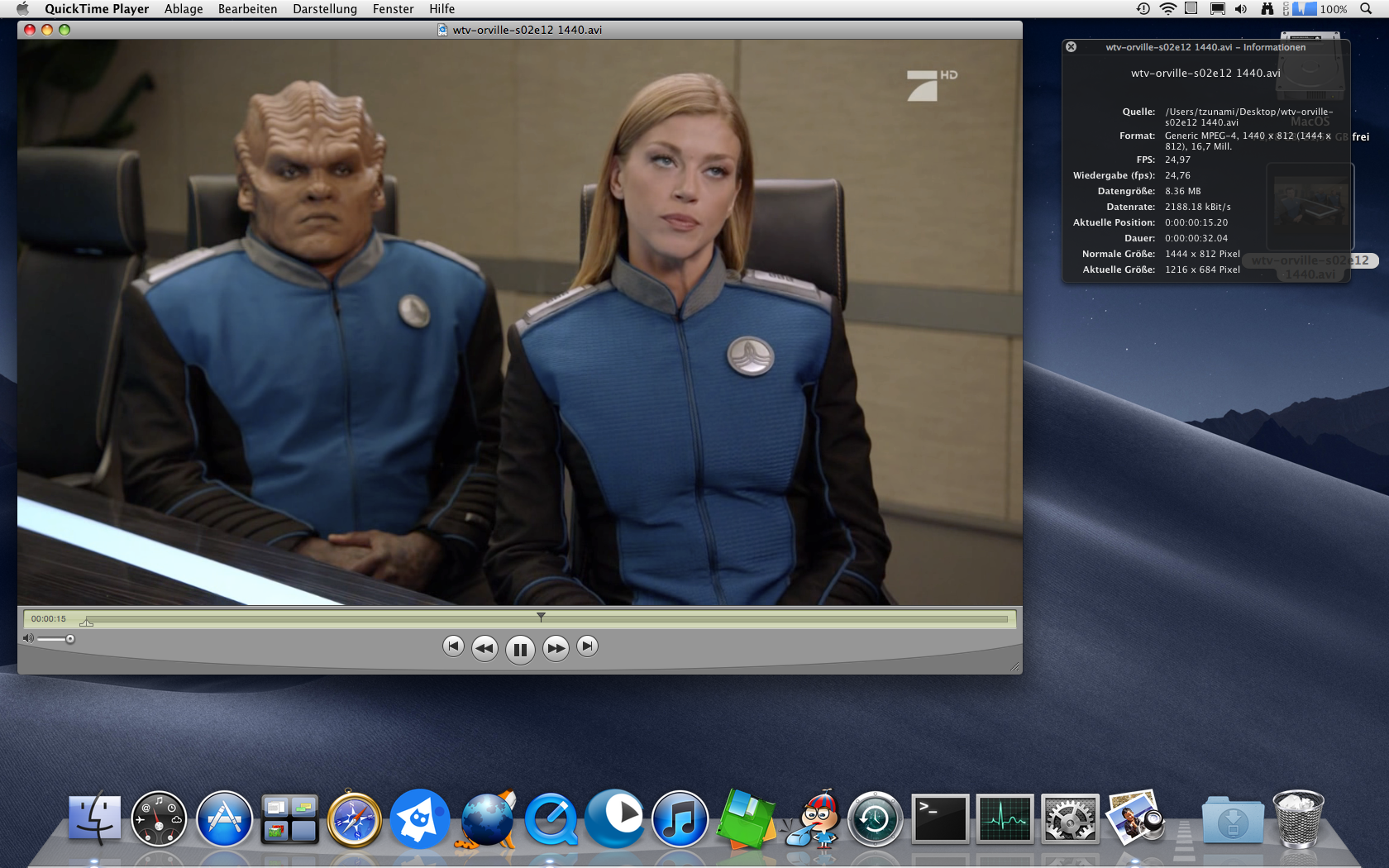

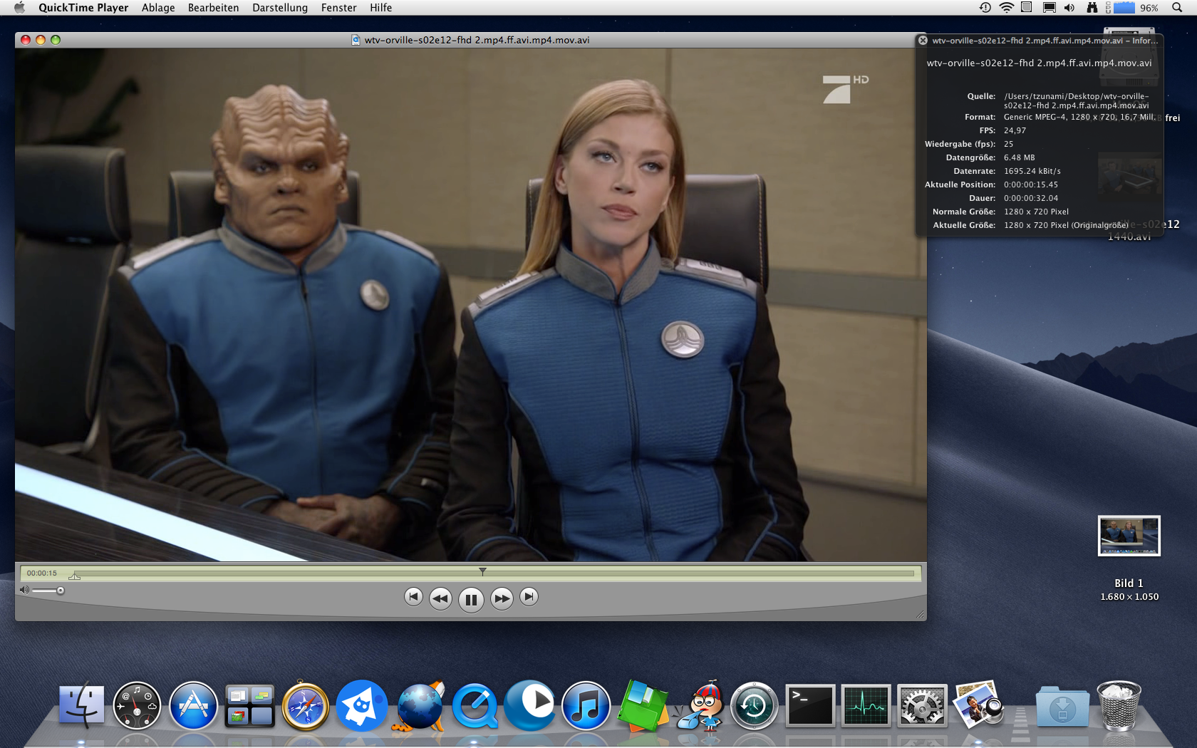

My iMac G4 1,25 GHz can play a 1280x720 Xvid Video smooth (made the picture on playback, framrate in the info panel)
The maximum of a smooth playback in OT is 1440x812. 1680x916 is a stop and go video.

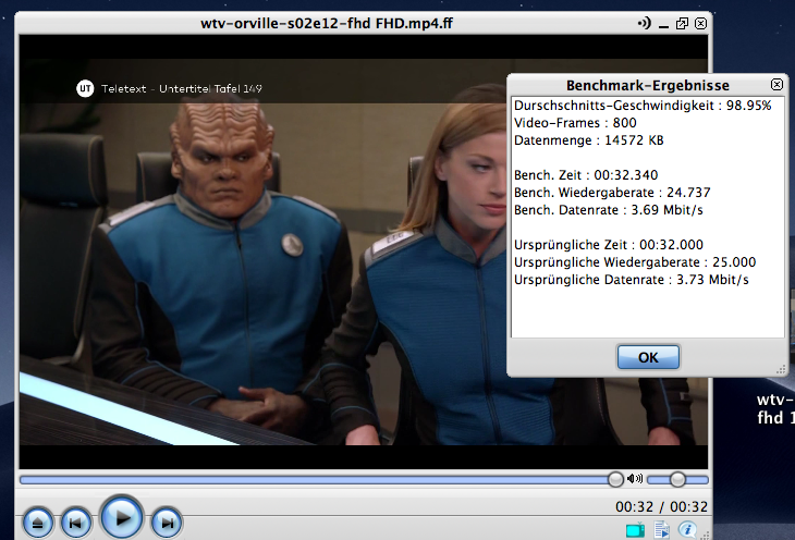

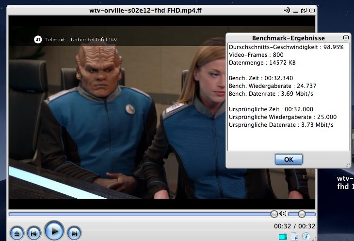

With Coreplayer i can play 1980x1080 nearly smooth
