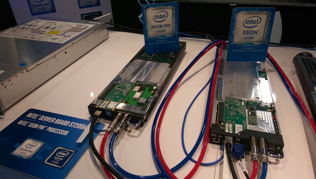

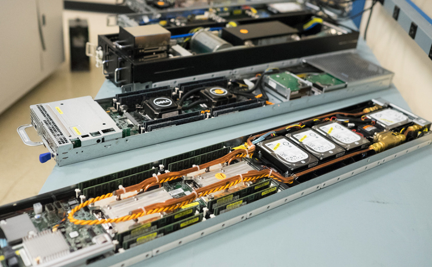

you may find few server racks with on-chip liquid cooling (as i mentioned in NY are more probable), but datacenters use forced air with liquid cooling not on chip, bt at the bottom or side of the racks to avoid leak damage and easy blade inspection/removal..
diy you check new Cray XC line ? http://www.cray.com/sites/default/files/Cray-XC50-Product-Brief.pdf
Yeah, you are a weird dude, i showed you an offering from Cray with on chip water cooling, then you for some reason refuse to believe Crays own information (they should know, they manufacture their on-chip liquid cooling offerings), i listed several other offerings with on-chip liquid cooling, you still refute it and claim no supercomputer uses liquid cooling even though there is several liquid cooled supercomputers on the Top500 list.
https://www.top500.org/news/aquila-takes-wraps-off-liquid-cooled-hpc-server/
http://www.asetek.com/press-room/ne...stallations-in-the-top500-supercomputer-list/
https://www.hpcwire.com/off-the-wire/rsc-tornado-72-core-intel-phi-achieves-1-41-pflops-per-rack/
The last one even breaking the world record for power density for supercomputers with its on-chip liquid cooling (which you time and time claim such a system does not exist...)
You can moan all your want about liquid cooled supercomputers does not exist, if you have a fetish for false information then fine, if that makes you happy. In the real world though, liquid cooled on-chip servers, datacenters and supercomputers exist and are fairly common, end of discussion, pointless to discuss this further, I'm going back to the Mac Pro...
