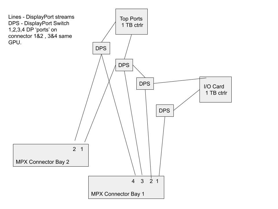

The Apple support doc literally says this will work (emphasis mine):
Two Pro Display XDRs with resolutions of 6016 x 3384 at 60Hz connected to any two of the following locations: Bus 0, Bus 1, or the Thunderbolt 3 ports on the rear of your Mac Pro. Connect one display for each location.
No. Read the document, specifically the part under "Connect displays to a single Radeon Pro Vega II MPX Module". It literally says you can use any two of the TB3 ports on the back of the Mac.
If you are using the HDMI port you can't "use any two ports". The section up above this one in the document outlining that the Bus 0 is stripped of a stream is still relevant here. It isn't all in that one paragraph. The HDMI port will eliminate Bus 0 since it won't have two. But yeah the switching appears relatively heaving to make the top two port and the MPX Bay 2 more relevant.
One thing to note there is that it is only two XDRs displays even though there are 6 DP streams. The load here is perhaps a bit much for these GPUs. Three 5K displays ( using all 6 of the DP streams) works fine. So two XDRs on a single GPU chip will bog it down in terms of even more medium-high resolution displays also added.
From the myriad of "if these then those ports " something like this block diagram.
In retrospect, it makes some sense since will need to 're-drive' the DisplayPort signals over longer distances. So passing them through a switch will effectively also do that. I haven't seen a three-input , one output switch chip but I didn't look everywhere. ( and hack it with just 2 two input switches in series).
If leave MPX Bay 2 open and use a Vega II solo or W5700X card then ports 1&2 on second connector and 3&4 on first one are "dead". It is a complicated path to get connector one's port 2 all the way to the top.
If divert it to the I/O then pretty likely that the top ports are "shorted on video' to make that XDR work on the back. ( folks seem to be shying away from hooking up major video to the top ports so most probably won't notice. )
The cards that do all four ports could get by with just four simpler re-drivers and lots fewer trace paths.
