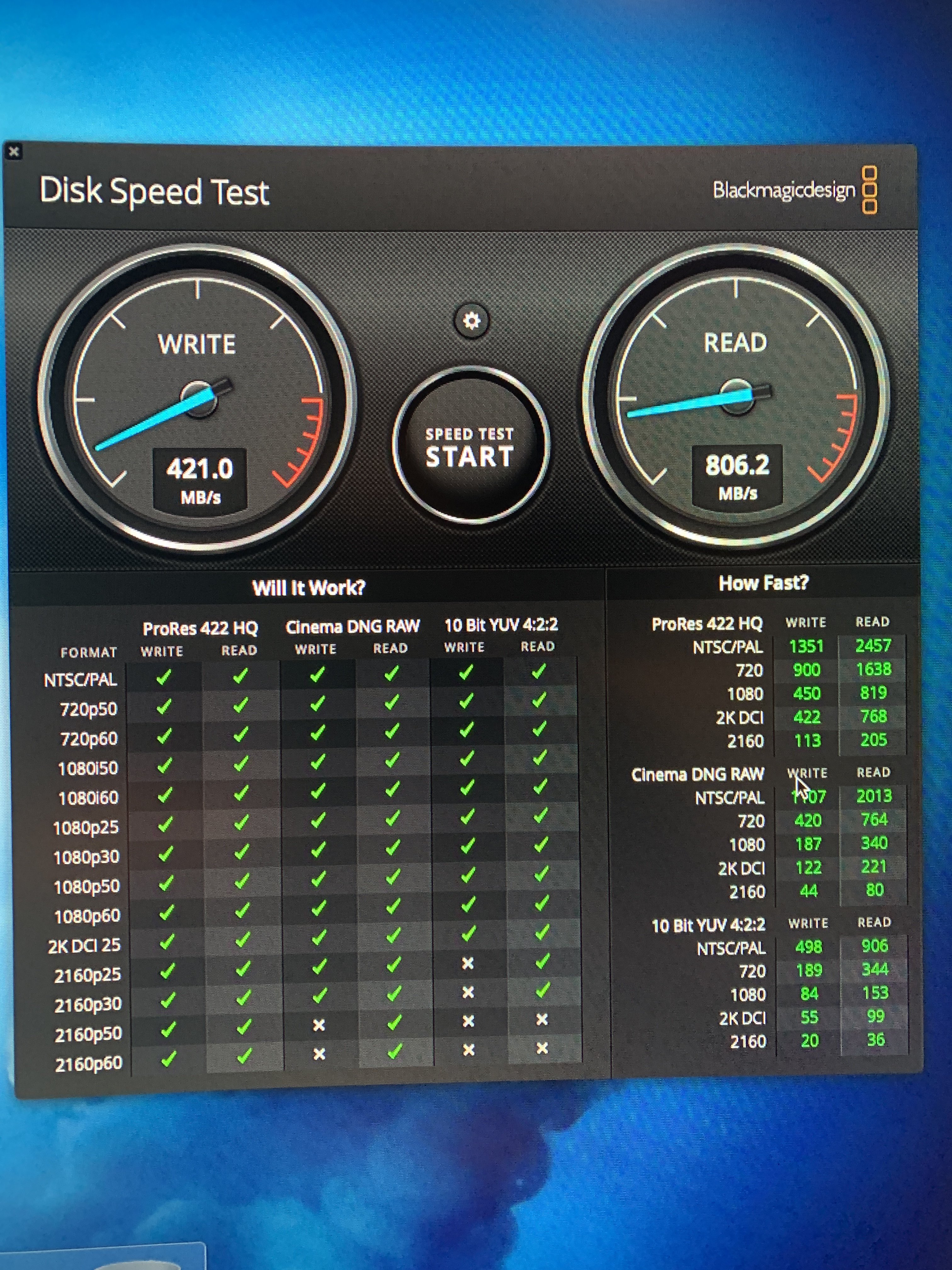

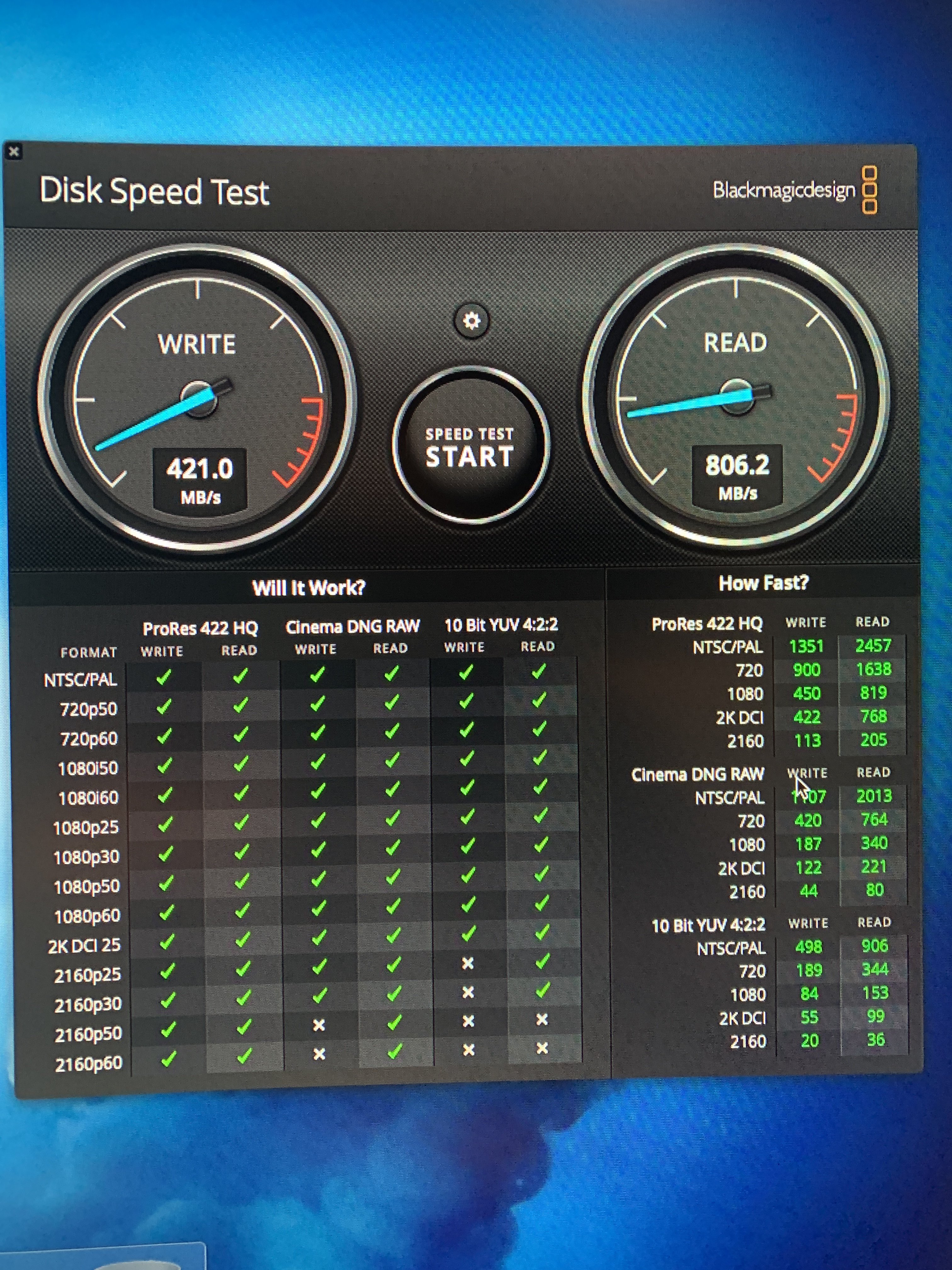

I recently added the Sonnet Twin10g, 10GBASE-T to my 2013 Mac Pro. Are my transfer speeds in line with what others are seeing? Thanks
Reactions: dabotsonline
Synology DS1618+ with 10Gb connection, Seagate Ironwolf Pro Drives
Speeds seem about right then. Not sure you’d get better performance from a 6 disk array of spinning disks.
PCIe SSD to PCIe SSD would likely see 900MB/s+ r/w.

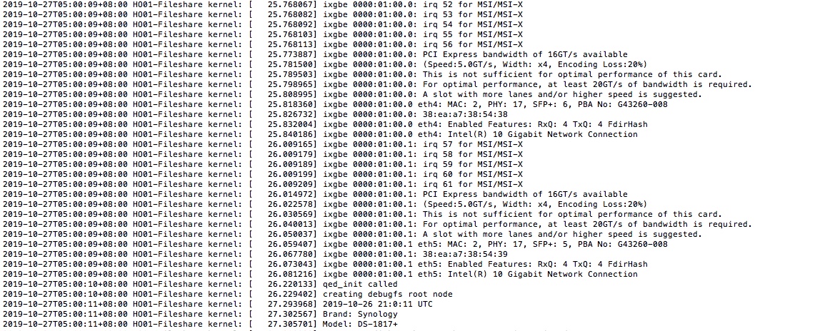

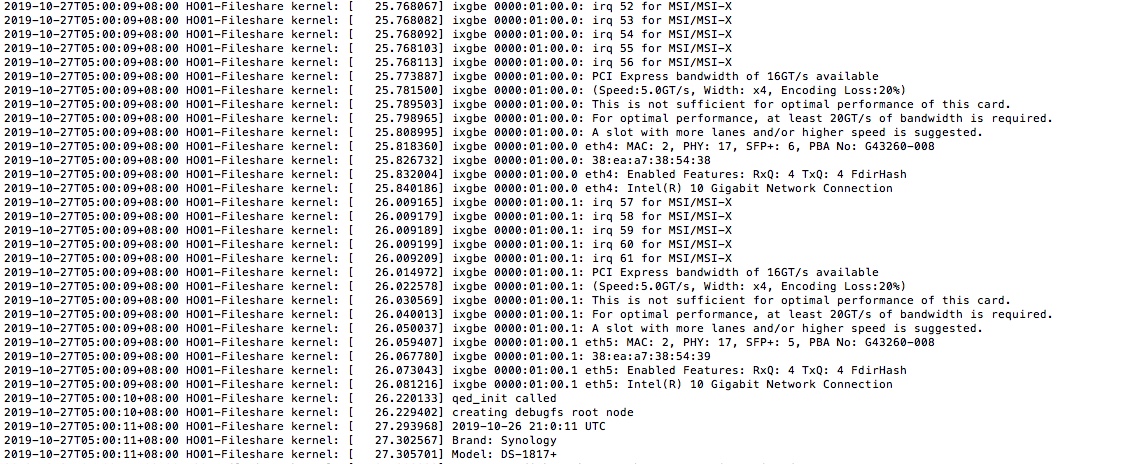

You can add "HP 560SFP+" to the list.... (intel 82559ES)
Just converted a couple for use on a mac pro... 5.1
Seeing about 820MB/s (RD) with synology 1817+
Interestingly, the one i shoved in the synology did not require any changes, but the kernal bitches about the card being throttled due to lack of PCI bandwidth. from the synology side
