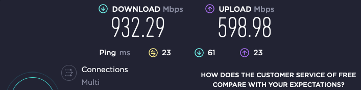

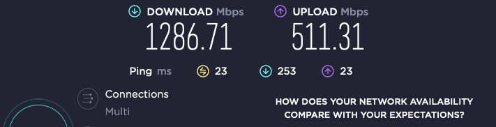

Is there a better way to have around 8000 Mbps, like other users of my ISP (Free-France here)

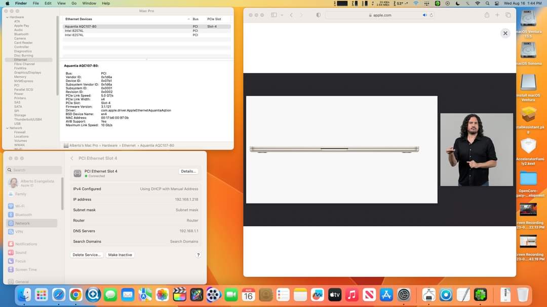

Fast forward to 2023. I am sharing a successful install of an Aquantia AN-107 10Gb NIC in a mac5,1 in macOS Ventura 13.5, OCLP 0.6.8; just set this entry in the config.plist "<key>ForceAquantiaEthernet</key><true/>". This entry default is</key><false/>
