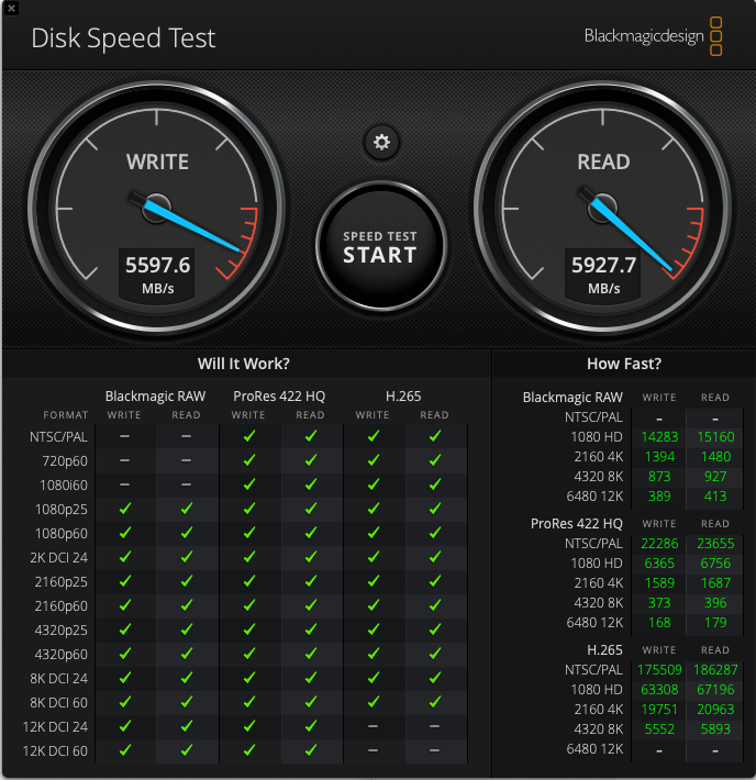

On my new Mac Studio:
Orico TB3 with Samsung 970 evo plus 2TB

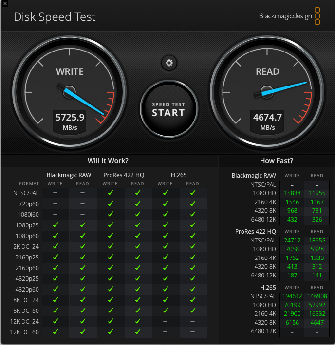

Next up is the Mac itself :

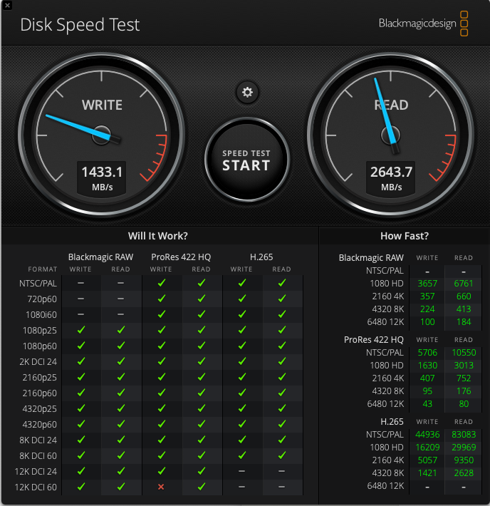

And Finally :
Acacis TB5 enclosure with a WD Black 4TB
