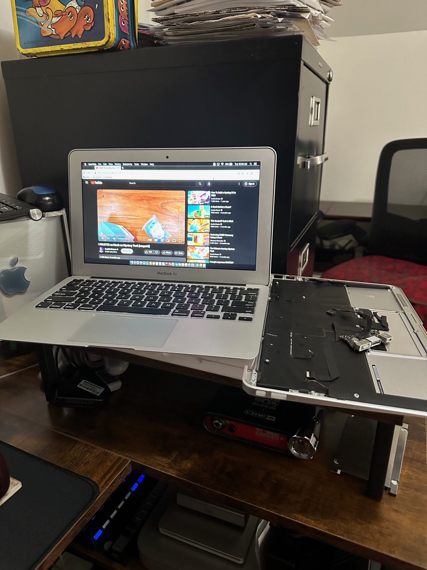

Top case arrived for my 11" 2011 MBA, and the transplant is done. No more sticky keyboard or mangled trackpad.

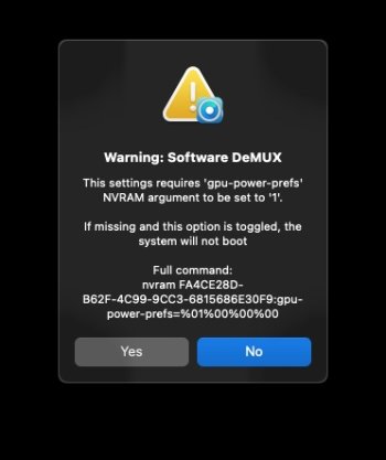

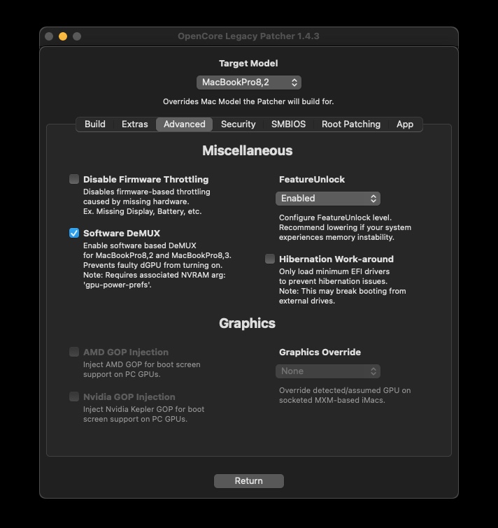

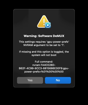

I imagine that when the 8,2 finishes installing, OCLP will, after reboot, install root patches, and at that point try and activate the Radeon GPU. If it fails, it's back to Linux MX permanently for this machine, as that is the only OS I can make run properly!
Yes, I think it will. It doesn't know automatically that your GPU is broken or disable them by default. You need to tell it to do so.
