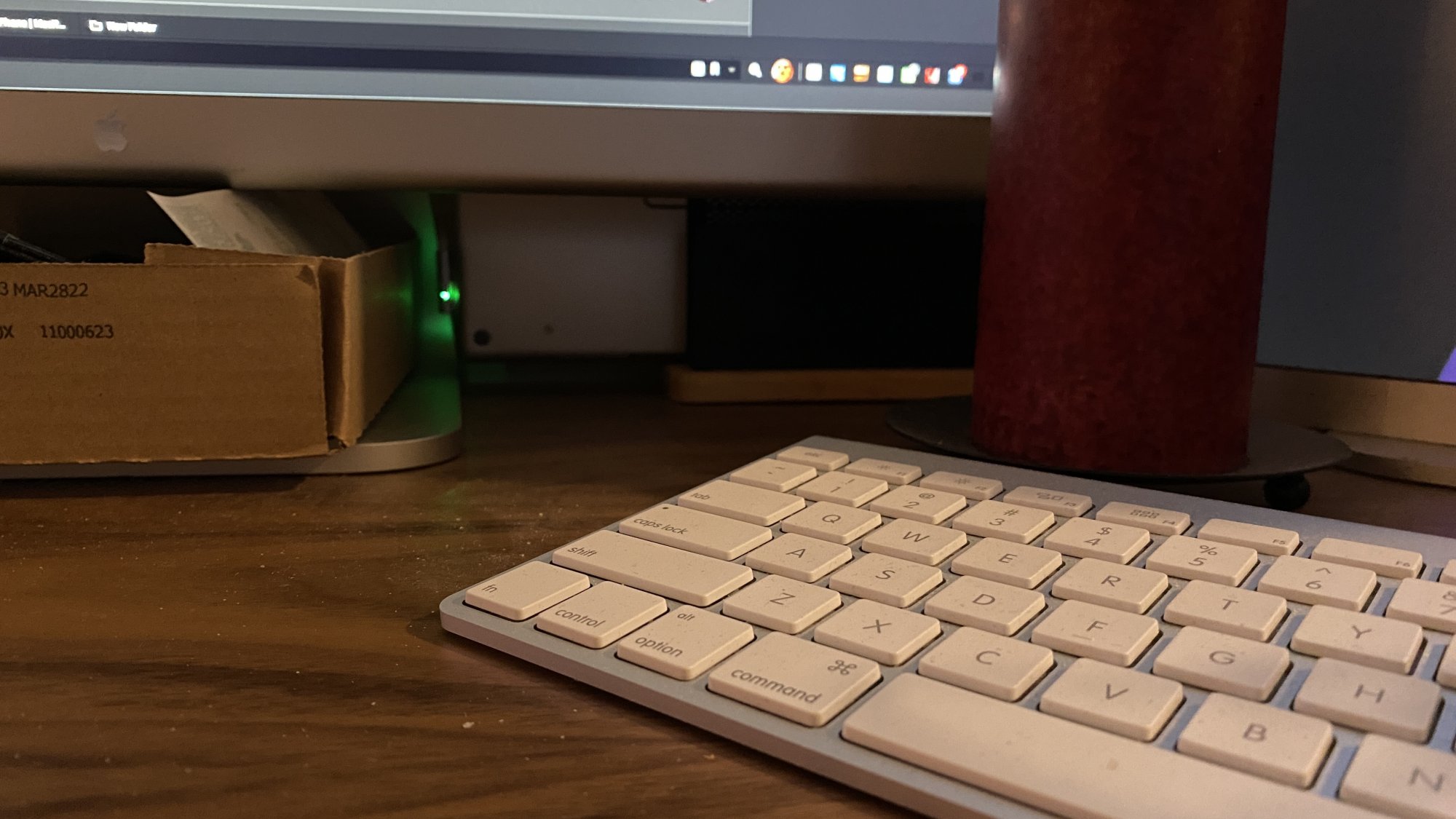

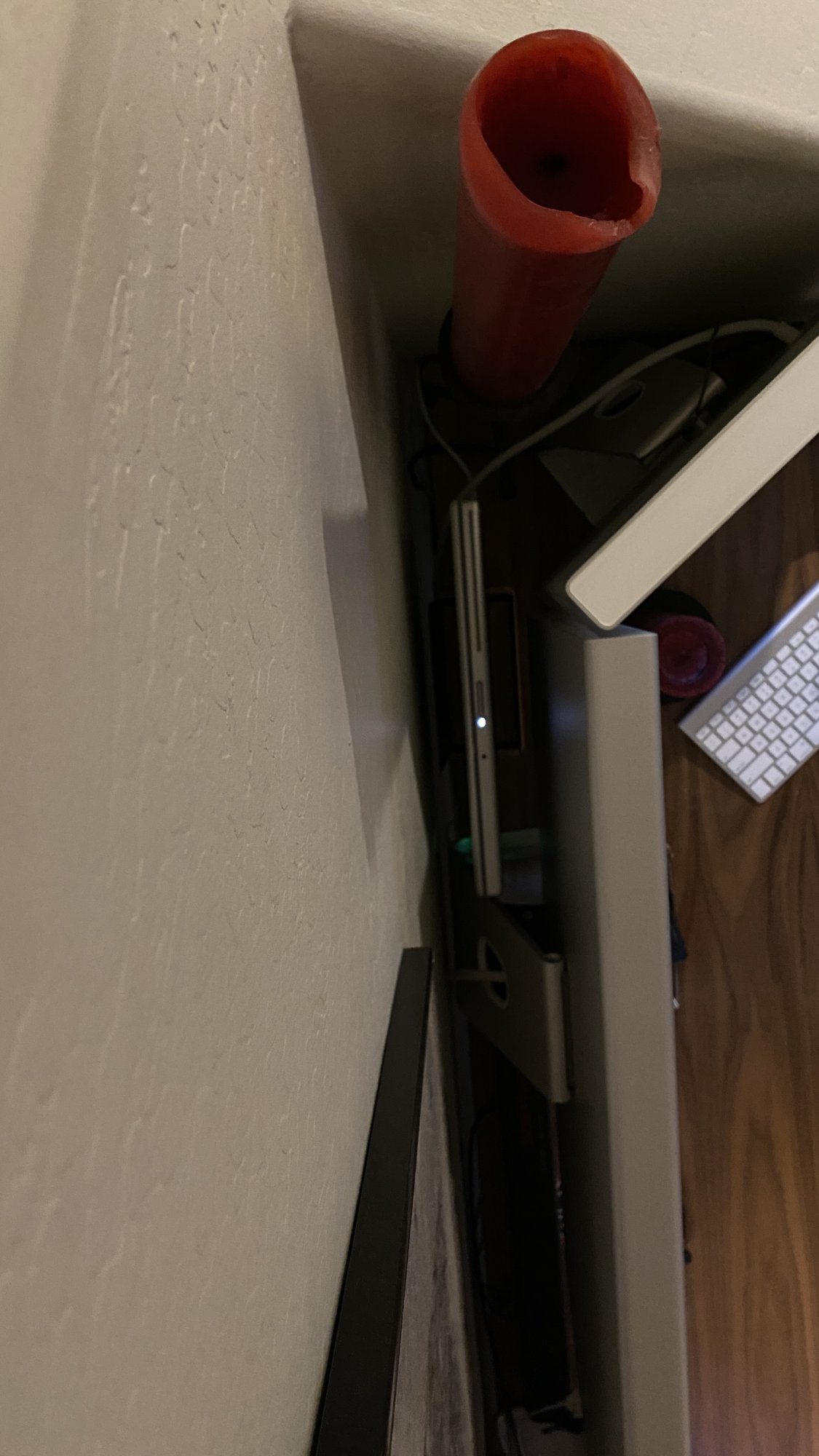

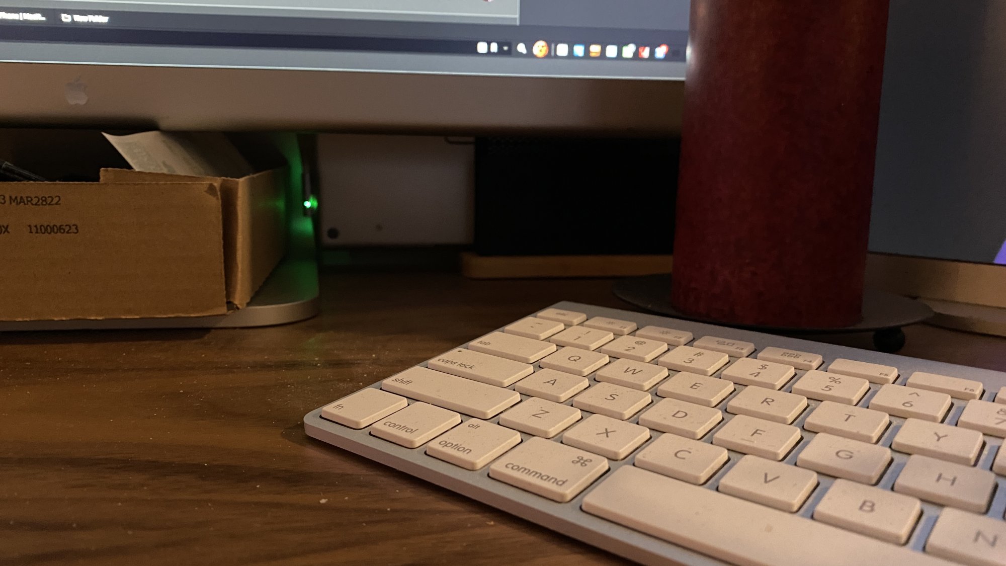

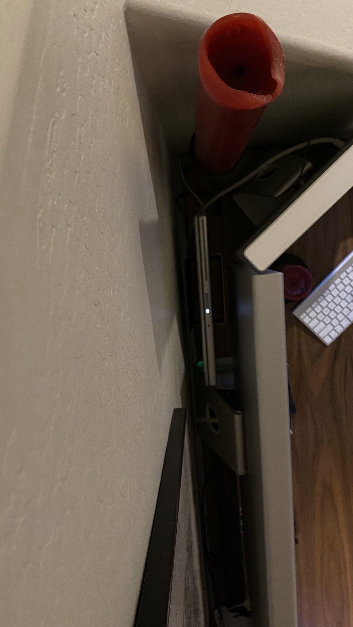

Moved @bobesch's 2008 MacBook Pro behind the 30" Cinema display. Gives me more room and does not block the monitor. Screensharing and BT keyboard/mouse are being used while it's in clamshell mode.

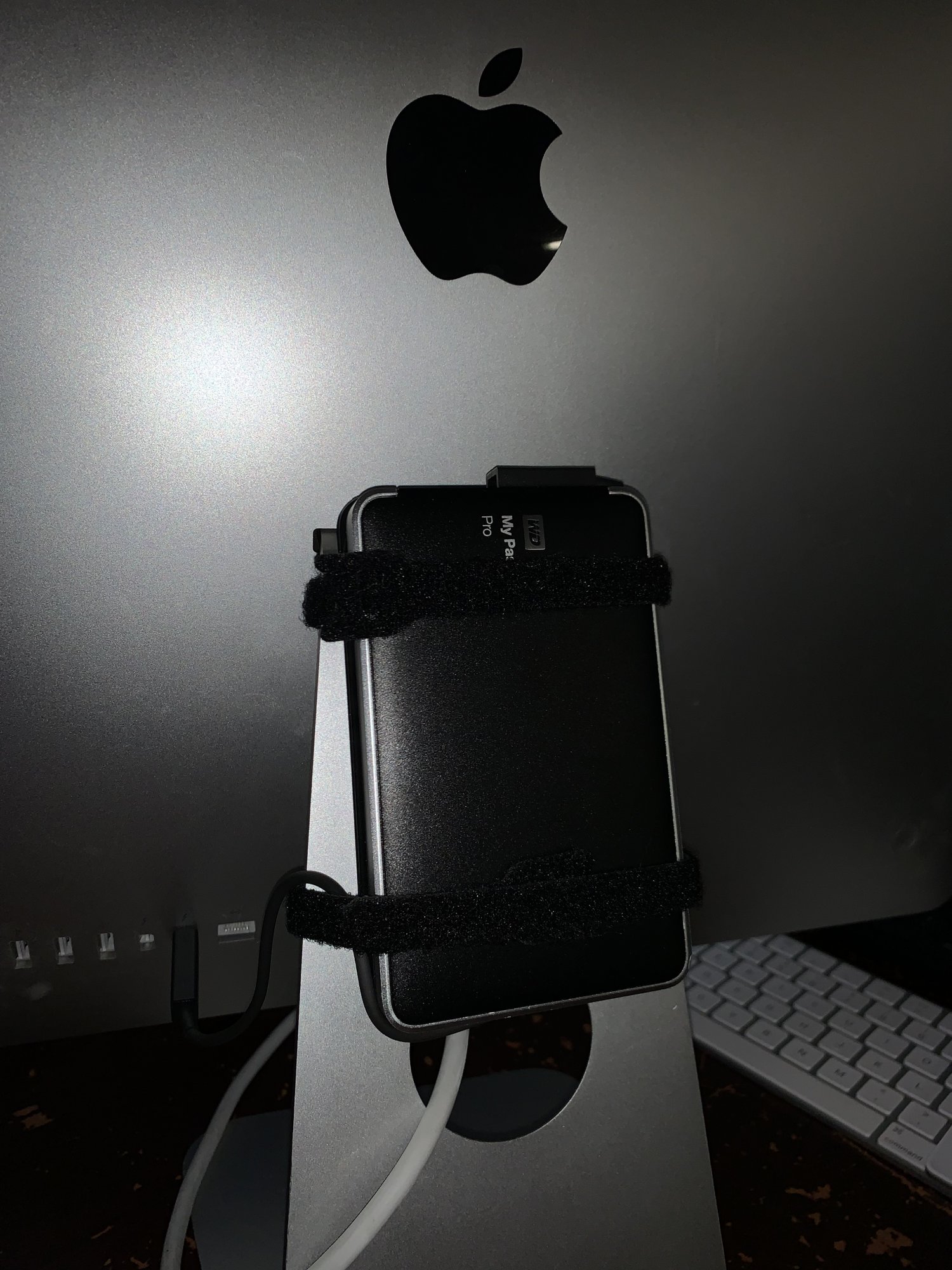

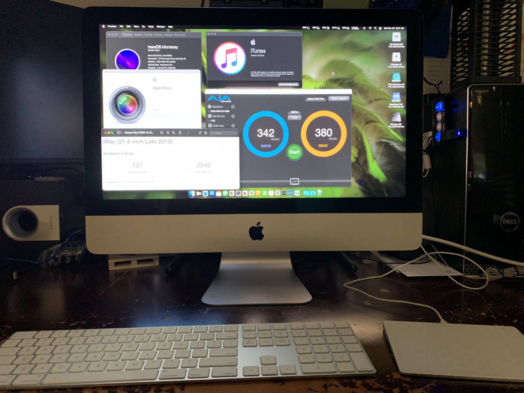

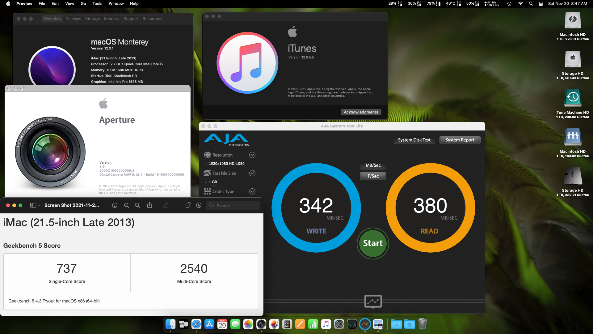

I know this Mac isn't really an Early Intel but in the age of M1 its old af anyways and it only has TB1 which is also old af. I can remove this post if needed if the newness offends anyone. I bought a Late 2013 iMac at the GoodWill Electronics store. (I love that store..) When I bought the Mid 2011 iMac I had bought a couple different solutions for TB booting, one of them was a WD Passport TB raid enclosure which is a weird little device with 2 sata slots inside. I took it apart and put 2 WD Blue 1TB SSD's in it and fired up OCLP and went to Monterey. Pretty neat little machine even if its old. This is my 16th Macintosh now in my collection. I have a Mac addiction I think...
I assume the two SSDs are running independently, i.e. no RAID? The AJA results seem low for SATA-III over TB1... I've yet to test my Samsung 970 EVO NVMe SSD in a M.2-to-PCIe adapter in an AKiTiO Thunder2 enclosure over TB1, but TB1 can do 1000 MB/s.
Yeah its not in a RAID right now, I got the same speeds in a R0 so I just broke the raid. I get about the same from my LaCie TB enclosure too. I think because its bus powered or because it originally it shipped with spinners the controller inside doesn't allow it full TB potential. I don't know, I mulled going USB 3 and getting faster speeds but its working fine and I wanted it to have Trim for everyday use its fast enough. I like that the boot drive and my storage drive are all in 1 enclosure and its a easy solution.
