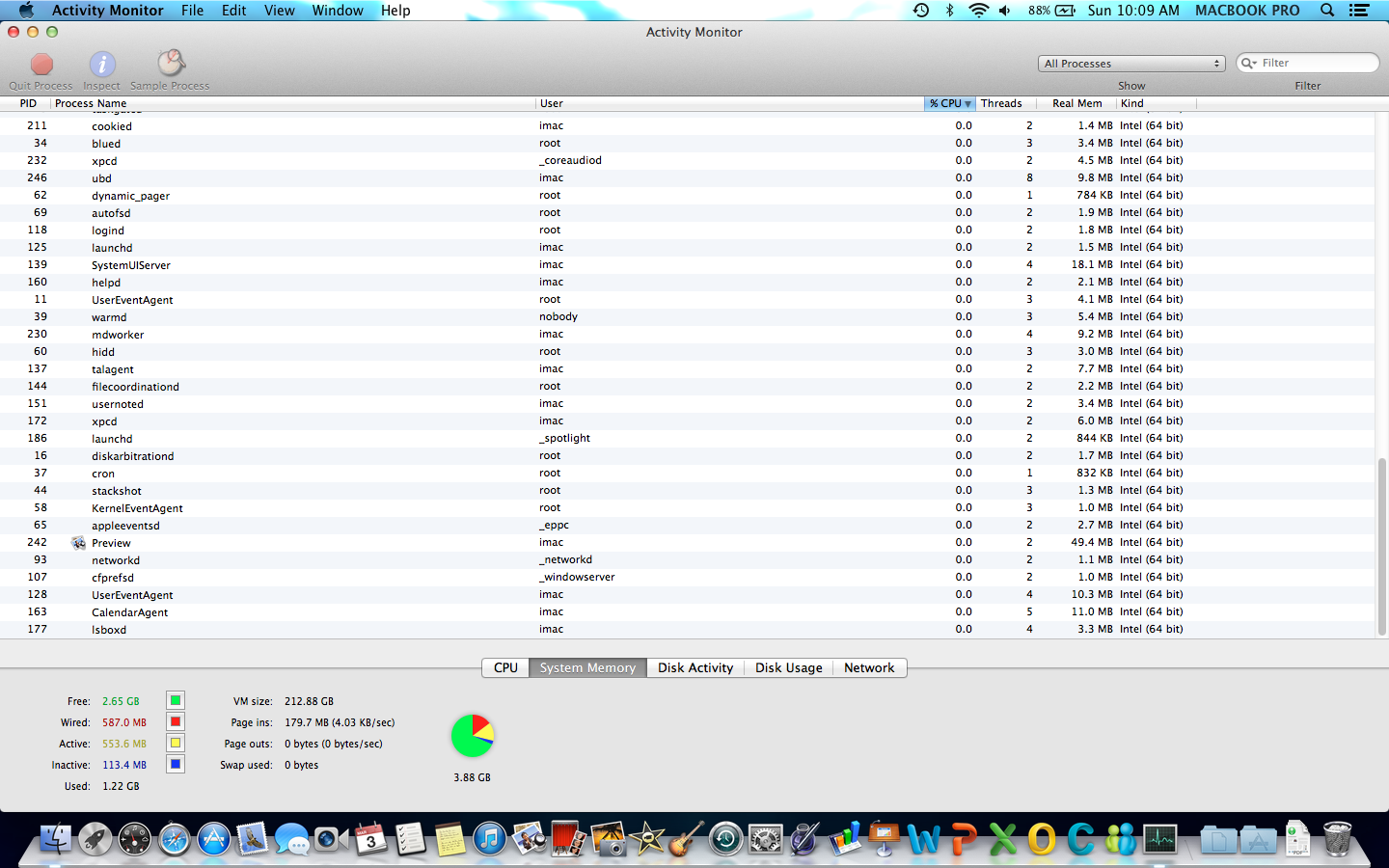

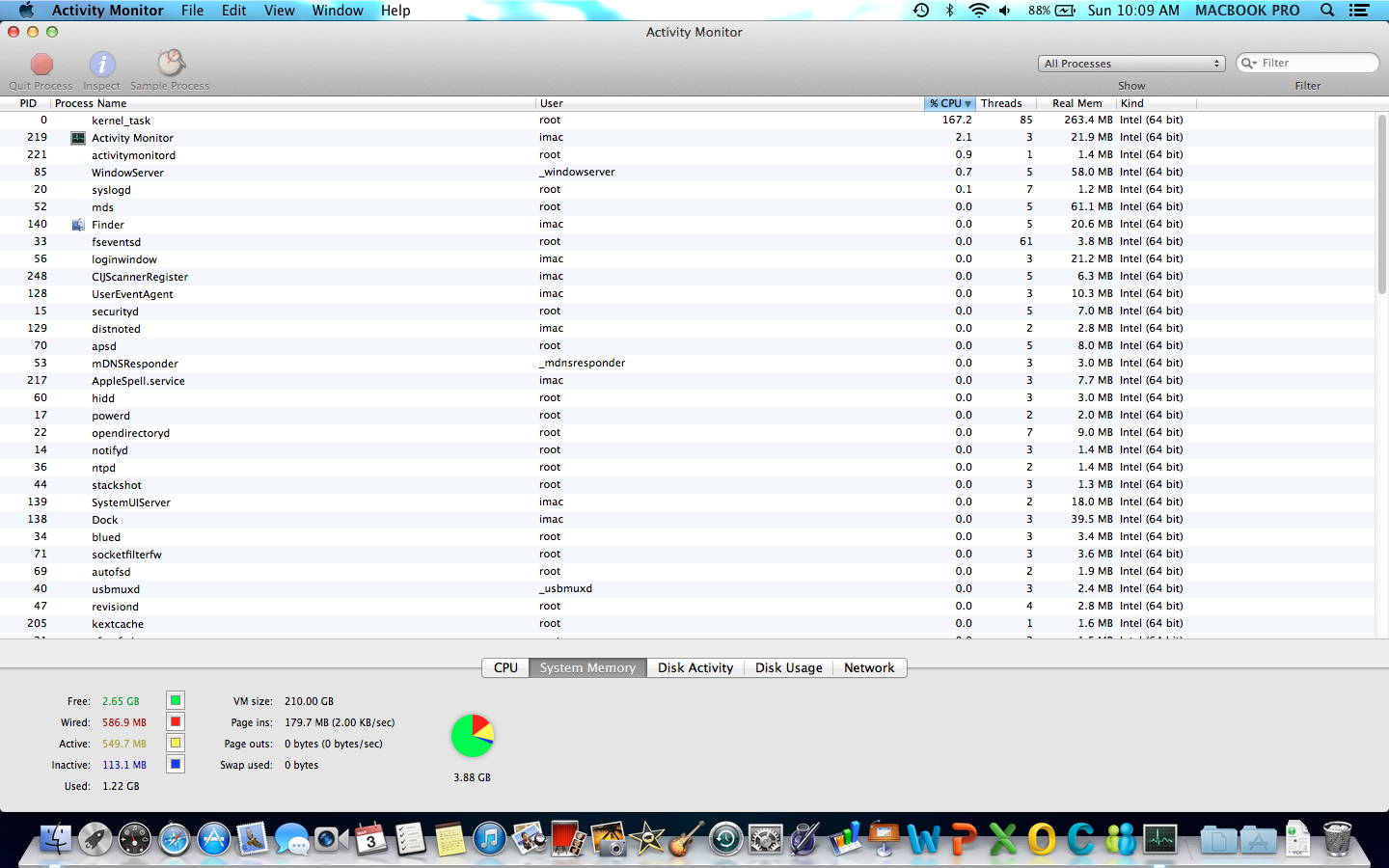

I noticed the kernel_task is above 200% when I am watching movies or using flash and when the Mac is getting hot.
The CPU Temperature was 80-90C (not F)
Any help would be appreciated
You are correct. 167% CPU usage on an idle system is not normal. Something is chewing up CPU cycles.
I am assuming from looking at your Dock you have nothing else running and Spotlight is not reindexing.
Have you installed something recently like maybe a driver that could have caused this?
Try a safe mode boot while holding down the shift key. This will prevent any startup items from running. While in safe mode look at Activity Monitor again. If the problem is gone, that tells you it is related to a startup item.

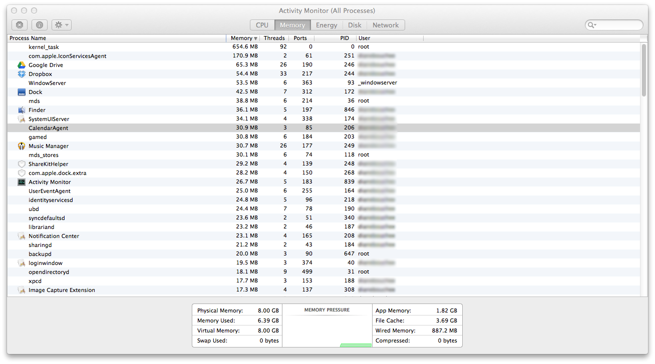

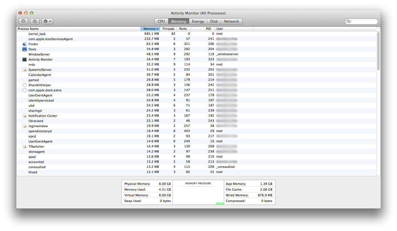

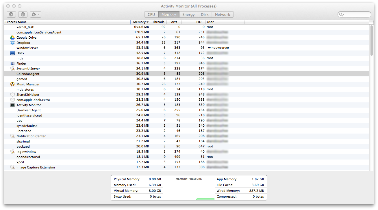

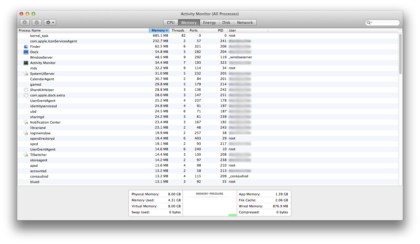

I've also having some issues with kernel_task pumping out too much memory. First, I'll give some background. I had my MacBook Pro running pretty much 24/7 for about a month. By that, I mean I had torrents, web browsers constantly open (one of which was set to auto-refresh on several pages), a java program that turned my computer into a server, and several Finder windows. So...probably WAY too much activity, but my computer is new and seemed to handle it fairly well. By the way, OS that came packaged with it was 10.8, but I upgraded to 10.9 (hasn't been too buggy...). That upgrade was before this month marathon of activity. Anyways, I go back to college (hence the one-month break) and the laptop goes back to having several long periods of rest. Monday was the first day of classes...and it was Tuesday that I noticed that machine was lagging for EVERYTHING. Open a Finder window, I get the pinwheel (or as you guys call it, the Beach Ball). Navigate within that Finder window that managed to load after waiting about a minute or two, Beach Ball. The computer can repeat the lagged task again, but if I try anything else, I get a noticeable data lag. I cannot use my laptop for anything remotely productive. Fortunately, I did say it was new, so it ought to be under Apple Care. I have an appointment scheduled for this Monday, but I thought I'd post on here and see if anyone can respond before thing (or after, should the problem not be solved that day). Anyways, back to the story...I rebooted my laptop numerous times, and the system was lagging more than I have ever experienced, and this is coming from someone that used Print Explosion (for those of you that know what I mean by that) on a machine that started out as a 10.4. Usually, when there's a data lag, I can at least switch gears, and if the entire machine locks up, a simple restart fixes the problem. Nothing is working. So, I bring up Activity Monitor, and I soon realize that there is a good 700+ MBs being taken up by a process known as kernel_task. Not knowing what this was and being unable to quit the process (with good reason as I now know) I consult one my friends whom has a pretty good knowledge of computers. He basically gives the explanation you guys gave, that it is essentially the OS. He was completely baffled as to why it would take up so much memory. He recommended draining the battery, among doing other things to short out the battery...didn't try those, but I did drain it completely to no avail. Next, I tried to use the Recovery HD. I ran Disk Utility to ensure it was not a problem with the hard drive...thankfully, it wasn't. Out of pretty much all options, I turn to calling Apple for support. That does very little either, as the guy seemed skeptical that this was an issue at all. Not only did he not seem concerned about the massive memory usage, but he also that Activity Monitor is not good at diagnosing things...not sure how that logic works, but whatever...he probably doesn't know a whole lot about how computers operate behind the screen and therefore didn't even consider it. Anyways, he has me empty the cache (a whooping 6000+ items in the User Library Cache alone) along with doing a hard reset. That helped...but the problem still remains. Actually, I'm skeptical if it helped at all as the system always seems to run rather quickly at first, but then slows down exponentially after startup. That...or I'm just getting more patient. Anyways, I was looking on here, and I saw Safe Mode. I tried that, and it seemed to work! All forms of lag were gone...I was able to navigate Finer just as quickly as before (with a slight degrade in the graphics, but that's to be expected I'd imagine). However, it doesn't seem that Safe Mode is a stable mode as I got kicked out to the login screen when I tried using Mission Control to flip between browsing Chrome to another app. I believe someone placed some code that will tell me what other background tasks are running, and perhaps I can further narrow down the issue from there. I'll post again in a second with screenshots and more info.
Activity Monitor in Safe Mode:
attachment.php
Activity Monitor after normal startup:
attachment.php
This actually leads me to think that something else is the cause and not kernel_task...but I feel the high memory outputs are rather a symptom of this.
Mavericks manages memory differently that previous OS versions. It tends to make use of all available memory.
It is perfectly normal for kernel task to use 700MB of memory. My system is using 704MB for it right now and everything is fine. Kernel task is not your issue.
Skimming that list in Activity Monitor I don't see anything using an unusually large amount of memory and the total memory in use looks fine.
If your system was fast before and is now slow, you need to focus on the CPU usage tab of activity monitor. The next time the system starts running really slow open activity monitor and look at the top CPU % consumers and see if you have something that is eating up CPU cycles.
The fact that this gets better (faster) in safe mode is an important clue. One of the things safe mode does is bypass any login/startup items. So the fact your system is faster in safe mode tells us you likely have a startup item slowing down the system. Go to System Prefs and Users & Groups then look at login items to see what you have there. Remove half at a time and reboot to see if things improve.
Anyways, I was looking on here, and I saw Safe Mode. I tried that, and it seemed to work! All forms of lag were gone...I was able to navigate Finder just as quickly as before (with a slight degrade in the graphics, but that's to be expected I'd imagine).
And to update with some more info...Finder (I think) crashed when I tried to move those screenshots to another computer so I can post them on here (because forget web browsing on my laptop).

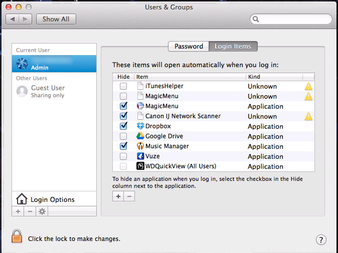

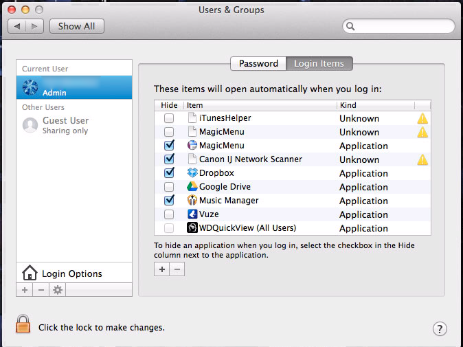

I'll check System Preferences for login items...I am pretty sure I have a lot. For instance, I have two cloud services on my computer along with a couple of other things, but like I said before, nothing has been an issue until now.
Here's a screenshot of all my login items.
Get rid of the three with the yellow triangles because the app is not present. Then start removing half of the others at a time and restart to see if that helps.
Make sure you have updated that WD Quckview. I know some of the WD software was causing troubles for Mavericks
I might get rid of the WD altogether too...it's a sucky software. WD makes great drives, terrible backup software...
Yep... you would be better ditching it if you can and just use OS X Time Machine. It is better anyway and can do a full restore if you ever need it.
