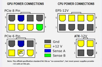

300W is supported with the two PCI AUX ports and the PCI slot.
SYOPS has the best description of the on board 6 pin ports I have seen. What is great is the two AUX ports can support up to 150W each if a proper 6 pin to 8 pin cable is used. 75W comes from the PCI slot. No need to use a Y connector or SATA power. Here is the link and proof that the 6pin is able to support 150W using a meter and some photos
"The pin out of the mini 6 pin PCIe AUX on the MAC PRO 4,1 | 5,1. looking at the pin diagram, you can see the only pins that provide power on both the 6 and 8 pin PCIe AUX are pins 1,2 and 3. On the 6 pin plug, pin number 2 may or may not be connected. See note in diagram.
Yes the number 2 pin is connected on the MAC PRO 4,1 and 5,1. Electrically by jumping the extra ground and sense as depicted in the picture you signal the GPU it is a 8 pin connector. If there are only two power pins in this configuration you may run into a overload issue, but the Mac Pro has all three pins powered. Yes you can draw the maximum 375 watts for a single GPU on the MAC PRO 4,1 | 5,1."

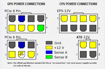

300W is supported with the two PCI AUX ports and the PCI slot. View attachment 700238 View attachment 700239
https://forums.macrumors.com/threads/mac-pro-4-1-and-5-1-pcie-aux-power.2035519/#post-24366927
I think that's still a theory at this moment. That post simply do not have enough data to shows that a single mini 6pin can deliver 150W in total. Yes, you show us the total power draw difference (between idle and under stress) is way above 400W. However, that's the entire system load, RAM and CPU will also draw more. And the biggest missing puzzle is the efficiency of the PSU. If the PSU has 80% efficiency (which is pretty high already). Then the actual power difference consumed by the electronics is just 381W (80% of 477W). If the PSU only has 60% efficiency (e.g. due to it's age), then the actual power draw difference from the electronics is just 286W.
