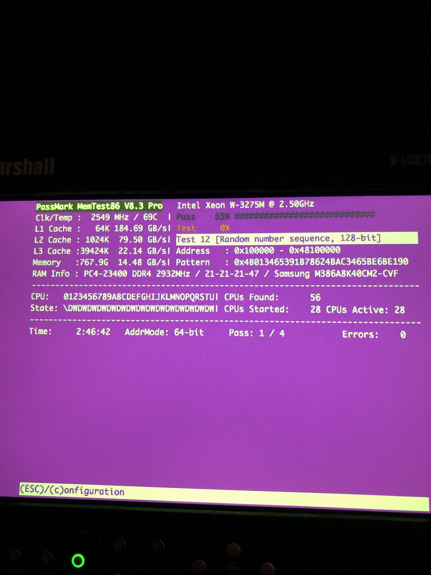

Yeah , that test did not pass . It seemed to freeze up .

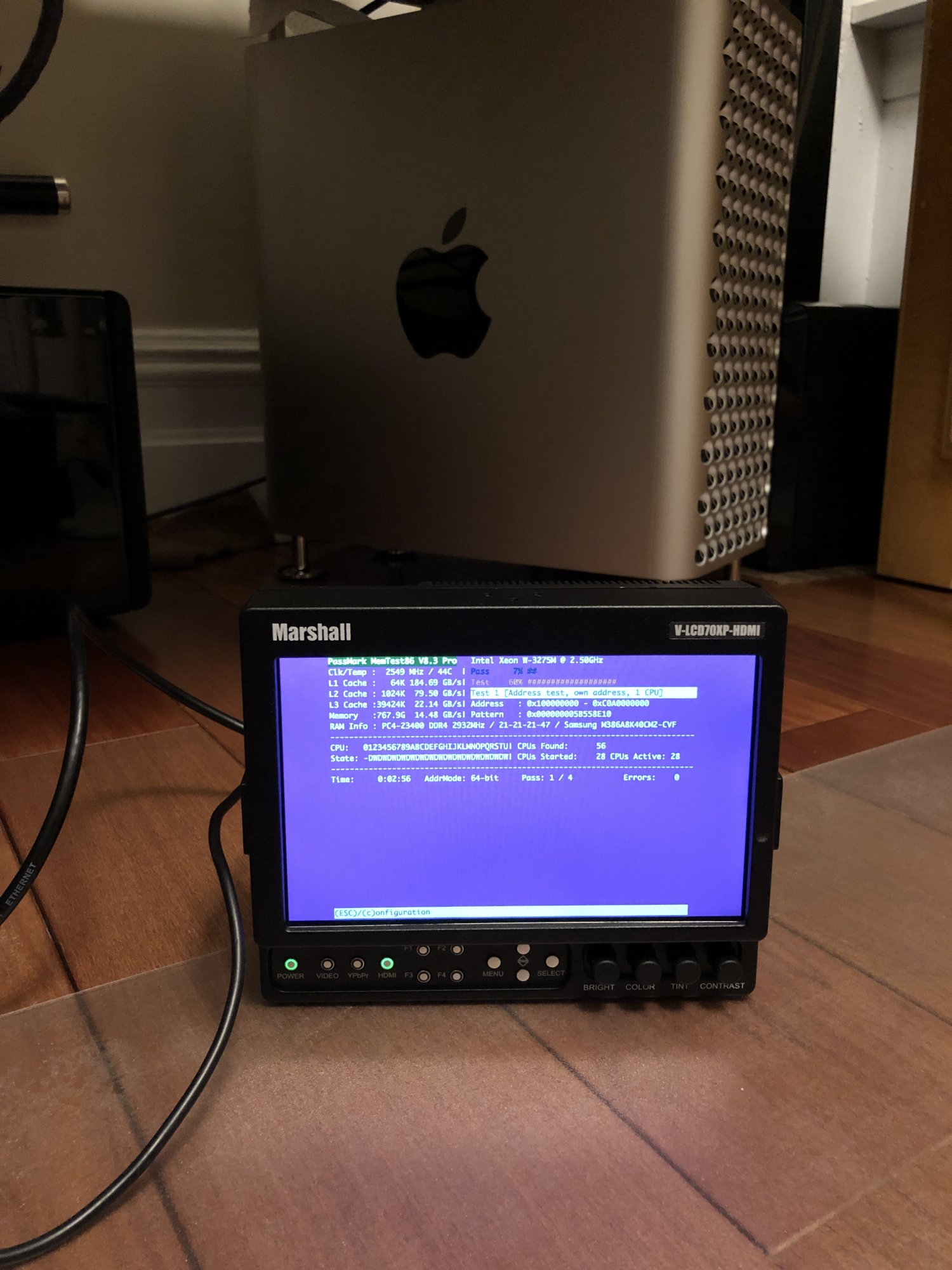

That's a nice field display . Does Marshall make a DP version ?
Froze after 2:45 hours is all we got. No error logs option. I’m not too worried over it as 2 long compressive memory tests using TechTool Pro 11 and 12 passed without errors. The only caveat is that TechTool Pro could only allocate 736 and 741 each time of the 768gb
I think the short but official Apple hardware tests gave me confidence more. Strange, but I’ll leave it at that.
Yes. Not sure the model number but there certainly is. This display is near 10 years old. Still works, but only 1080p, so I could not select 1 pass for the overnight test on memtest86.
when I started video work a decade plus ago, this marshal with canon 5D‘s was the go for 1080p capture.

Once, you disconnect the Pro Display XDR during USB-boot run, the process halts.

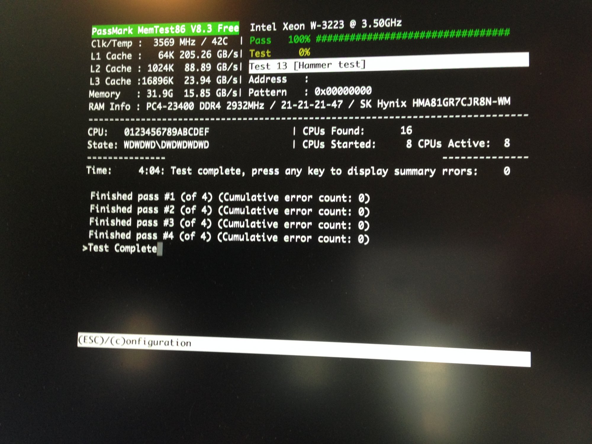

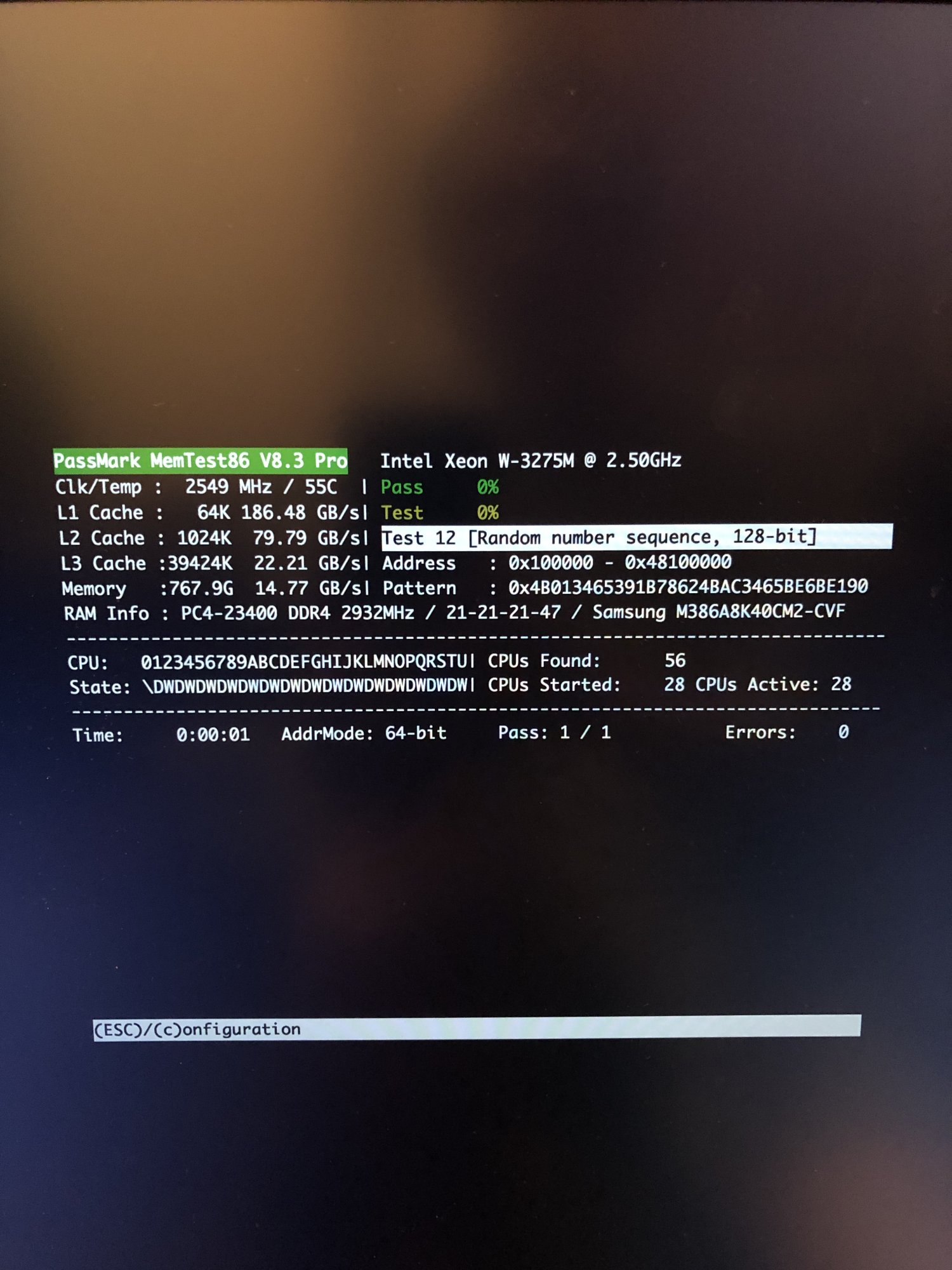

OK, tried running Memtest86 on a stick again and finished test 1 to test 11 fine but test 12 refused to even start.
Rebooted and selected just test 12 (Random 128 bits) and it stopped at 1 seconds
again no errors
I searched the web and others have experienced this with older Zeon processors.
Which processor do you have? It can't be any different than mine.

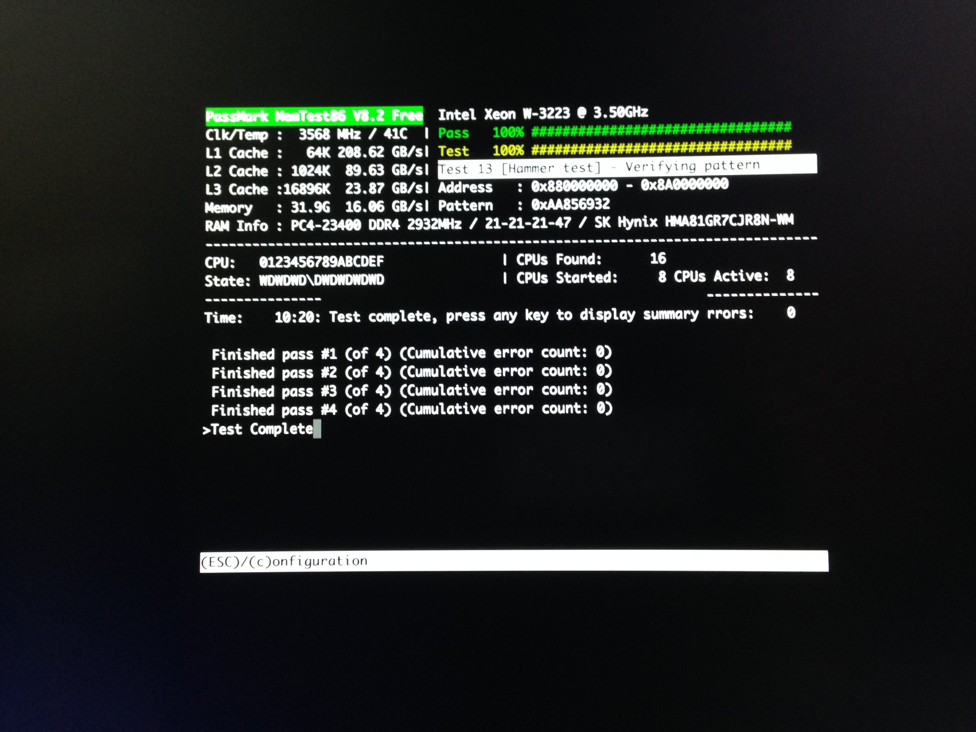

running the last test 13 (hammer) alone and after 46 minutes, still at only 2% done.
I really need to use my Mac for work tonight and not have to wait until 3AM

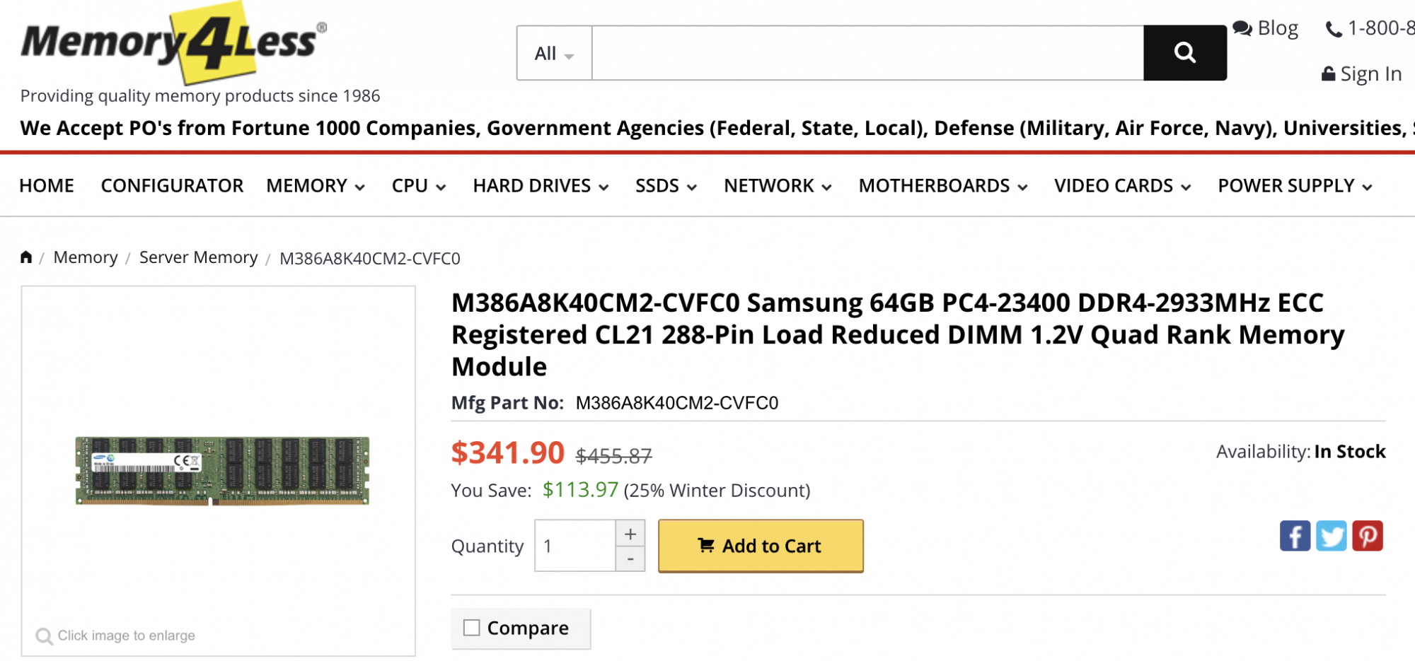

looks like Memory4less reads this forum.
yesterday we saw the M386A8K40CM2-CVFC0 was $528 and today it's back down to $342
