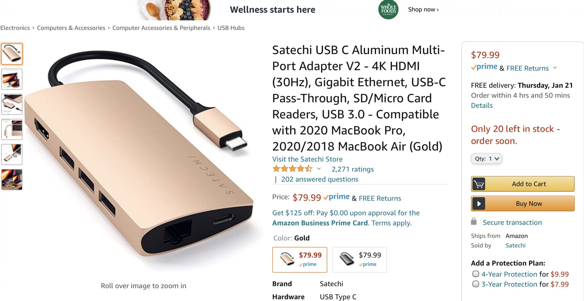

I haven't had any problems using the Satechi USB-C hub that I bought in 2016.
Different model, which isn't sold by Apple directly. The one that is, is the one causing problems https://www.apple.com/uk/shop/produ...f9addef62bf69ac2ba6bec018b20775084e0b5136ded0
Satechi's stuff looks totally style over substance.

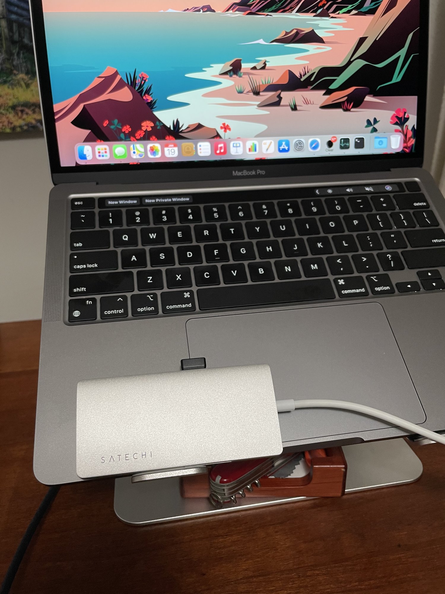

Knock on wood my Satechi works on the ports I use. I’m putting it through its paces on my new system and thus far so good to report back no issues. Sorry about you’re experiences
