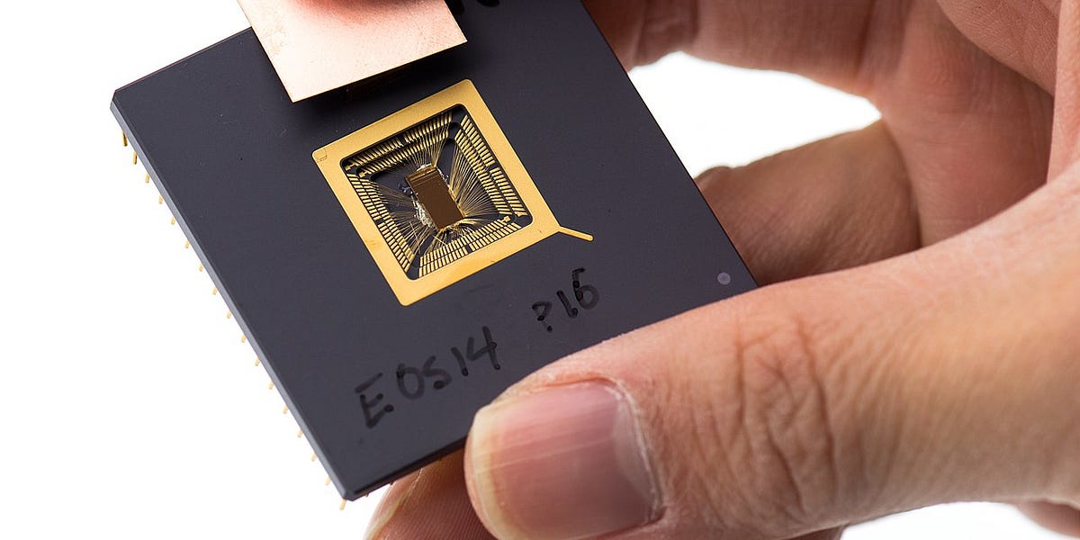

Much of RISC-V was taken from doing an intersection of selected 'good' instruction sets from RISC 'history'. Plus adjusting to the bigger transistor budgets afforded by modern fab techniques ( no good reason to restrict to the max transistor counts of 1983-89 era ) and better automated design tools.
[ The T1/Niagara ejecting float in the 2000's , two decades later, was a radically different context. Evolution in fab processes, toos, and actually having a standard to follow. ]
P.S. An addition on the "done by a grad student team" front ...
" ... The Berkeley team asked the question ‘Are we crazy not to use a standard ISA?’ before noting that existing standard ISAs (x86, ARM and GPUs) would probably be too complex for a university project anyway. ...
The team iterated on the new ISA. In order to make implementation as simple as possible, they gradually reduced the number of instructions down to the absolute minimum needed.

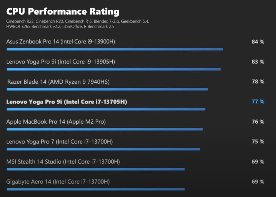

Just a fun screen grab for those harping on intel and amd. While M series are great it's not like the other guys are sitting in the back seat crying. It comes down to use case. Apple made hardware that can do things now that hardware in the past couldn't but you have to be honest with yourself if you think other systems can't do it.
Heat? Battery life? Throttling?

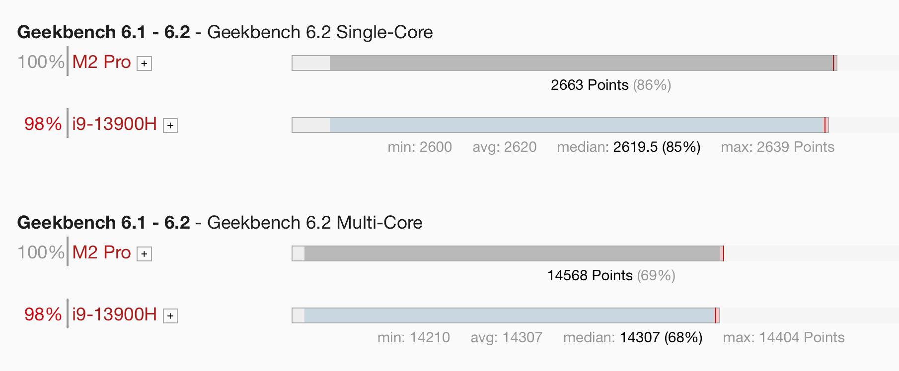

1) Unless you created this yourself, I would urge everyone to *always* cite a reference, both so others can check the context (it's not even clear from from this if this is SC or MC performance) and, more importantly, to give the author or organization credit for their work.
2) Cinebench should not be used for cross-platform comparisons bertween AS, AMD, and Intel. It's been demonstrated that it disfavors AS (I found the disadvantage is about 10%). GB6 is a better cross-platform benchmark:
SC:
M2 Pro: 2663
i9-13900H: 2620
MC:
M2 Pro: 14,568
i9-13900H: 14,307
Source:

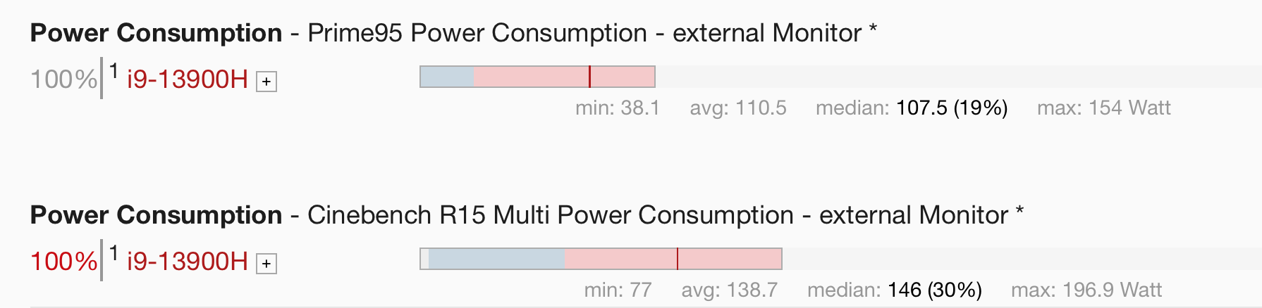

3) These are mobile processors, so power consumption and heat is a critical component. Your chart doesn't show that. Even if the performance of the i9-13900H is, on average, somewhat higher than that of the M2 Pro, it's miselading to look at performance alone without accouting for power, since higher power consumption means a bigger, heavier form factor, lower battery life, and lower performance when on battery. So until AMD and Intel can offer mobile CPUs with the same performance/power ratio as AS, then it is indeed the case that they "can't [yet] do it."
Unfortunately the notebookcheck article doesn't give power consumption figures for the M2 Pro. But it does give them for the i9-13900H, and the M2's CPU certainly uses much less than this:

1) Unless you did this yourself, you should *always* cite a reference, both so others can check the context (it's not even clear from from this if this is SC or MC performance) and, more importantly, to give the author or organization credit for their work.
SC:
M2 Pro: 2663
i9-13900H: 2620
MC:
M2 Pro: 14,568
i9-13900H: 14,307
Source:
3) These are mobile processors, so power consumption and heat is a critical component. Your chart doesn't show that. Even if the performance of the i9-13900H is, on average, somewhat higher than that of the M2 Pro, it's miselading to look at performance alone without accouting for power, since higher power consumption means a bigger, heavier form factor, lower battery life, and lower performance when on battery. So until AMD and Intel can offer mobile devices with the same performance/power ratio as AS, then it is indeed the case that they "can't do it."
