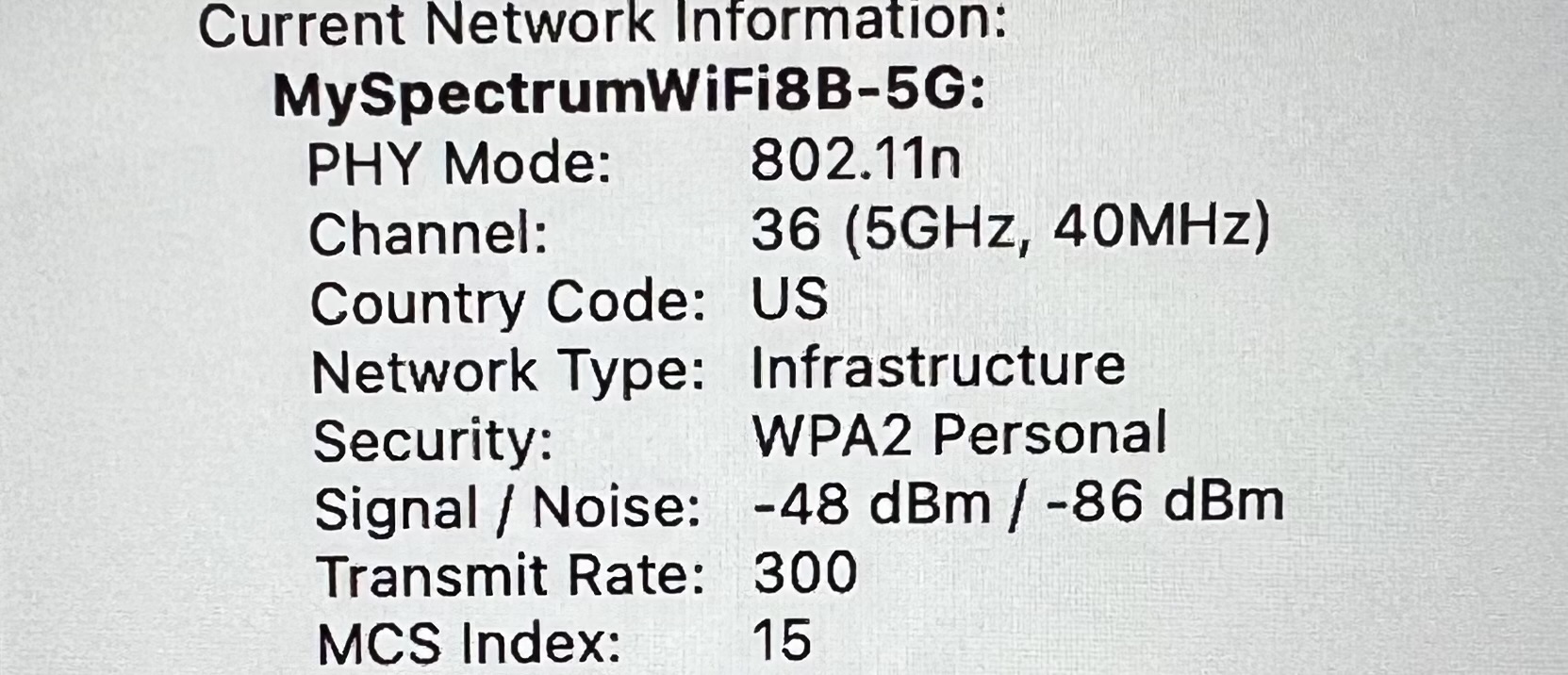

still stuck with this issue, when I connect to an ethernet, I get double the speed.
Is it possible I have a bad Wifi on this macbook?
attaching a pic from the system info.

I understand that, however it works pretty well for every other device I have except for this one.
It’s possible the WiFi card is bad on the Mac. It’s also possible the router doesn’t like it for whatever reason. I would test it on another network/router for comparison.
