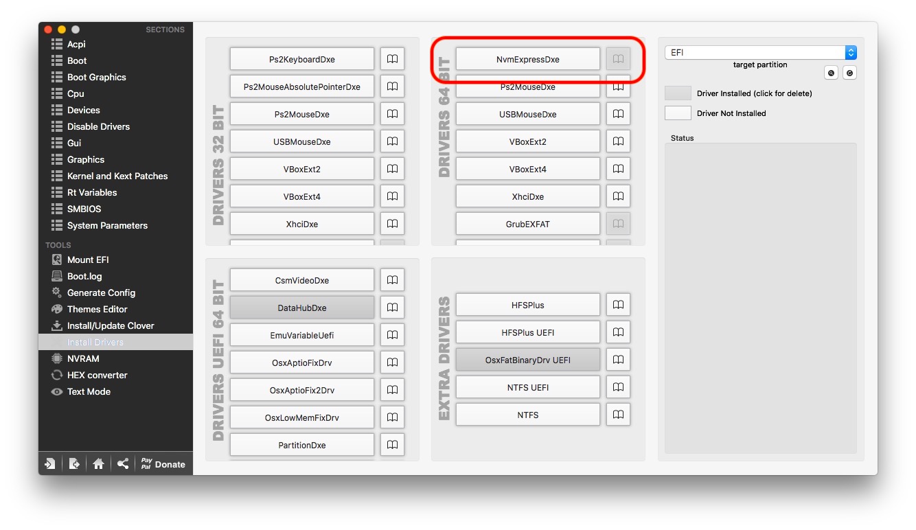

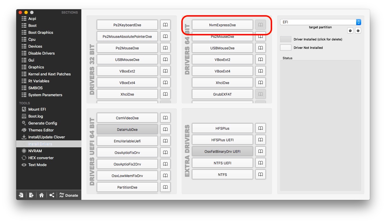

Wanna try Clover? One of the theory is a cMP can boot from NVMe or USB 3.0 by using Clover. The required driver should be there.
Unfortunately it will have to wait a month or more because my only NVMe is currently in a Fusion Drive on my production cMP, and I can't afford to buy another one just yet because the kids have expensive Xmas wishes! Let's hope they're naughty and don't get anything for Xmas!! I'll probably get a Samsung 960 EVO 256GB.
Clover just uses NvmExpressDxe from EDK2, so you can just use that (load from EFI shell, you may need to use EdkShell(Bin)Pkg instead of Shell(Bin)Pkg on Mac Pro's EFI 1.10 firmware).
Am I missing something here? To run Clover you can't run it from an NVME SSD so must be on something else?
Correct, you would have to load Clover/an EFI shell from a USB/SATA drive before loading NvmExpressDxe.
Yes, I should be more specific that the theory said Clover may able to boot an OS from a NVMe drive. Not booting Clover itself from NVMe. But if it work, then it may be the easiest way to boot from NVMe / USB 3.0 etc.

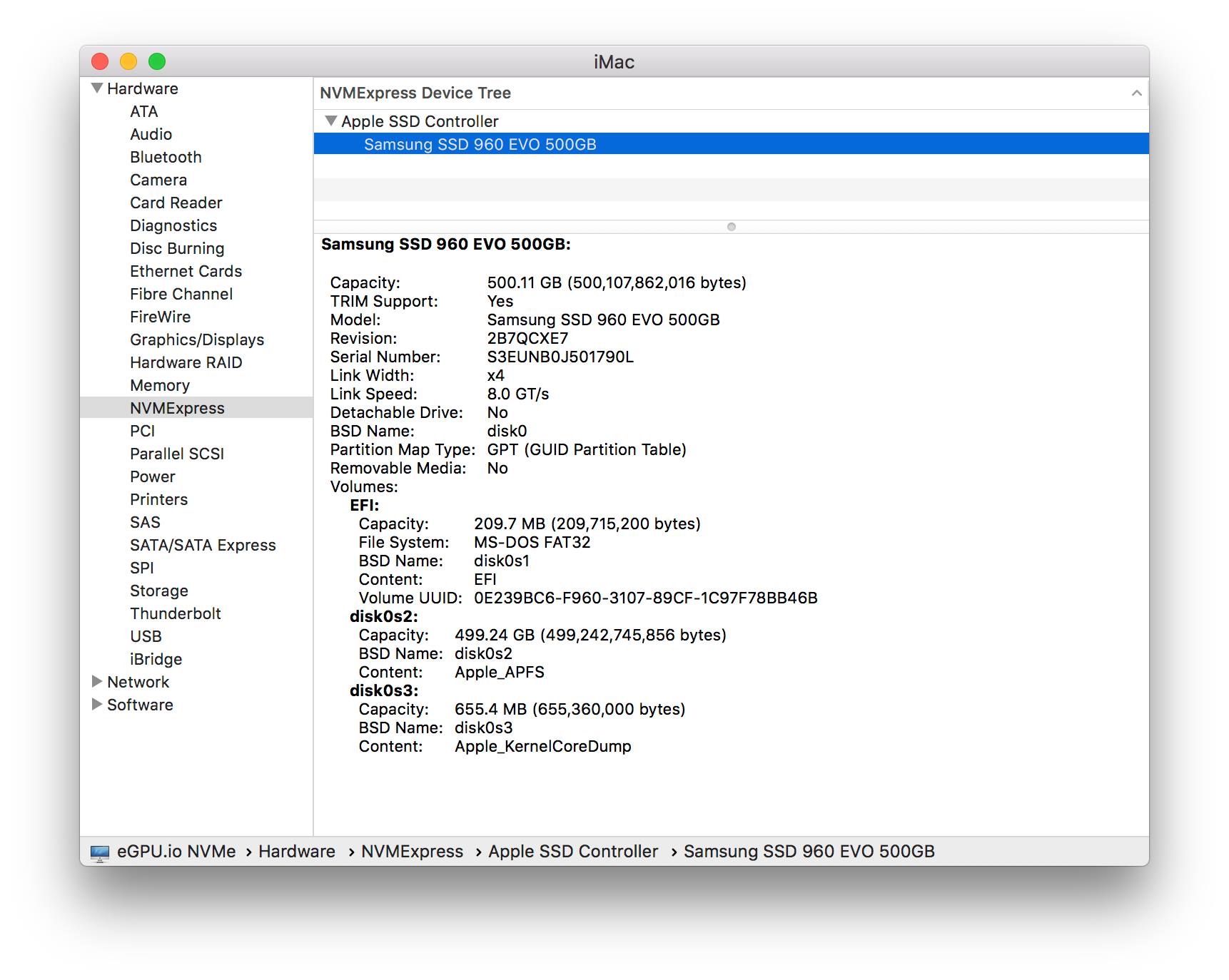

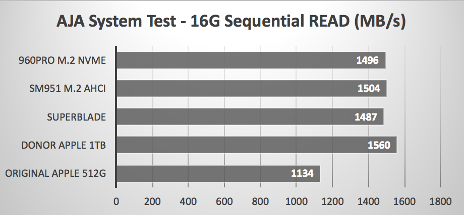

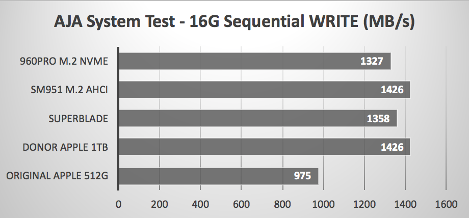

NVMe is bootable in 10.13. I've tried it through a Thunderbolt 3 enclosure on 2017 iMac, 2016 MacBook Pro, and 2013 Mac Pro. No go in the Mac Pro tower due to the Boot ROM.
The low Write speed is due to eGPU firmware in the AKiTiO Node I was using for this test. I've heard the PCIe firmware in Thunderbolt 3 storage enclosure is baked differently.

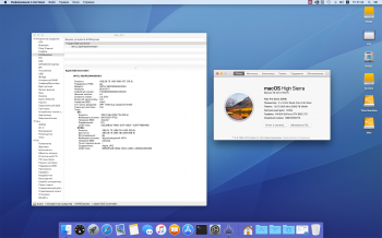

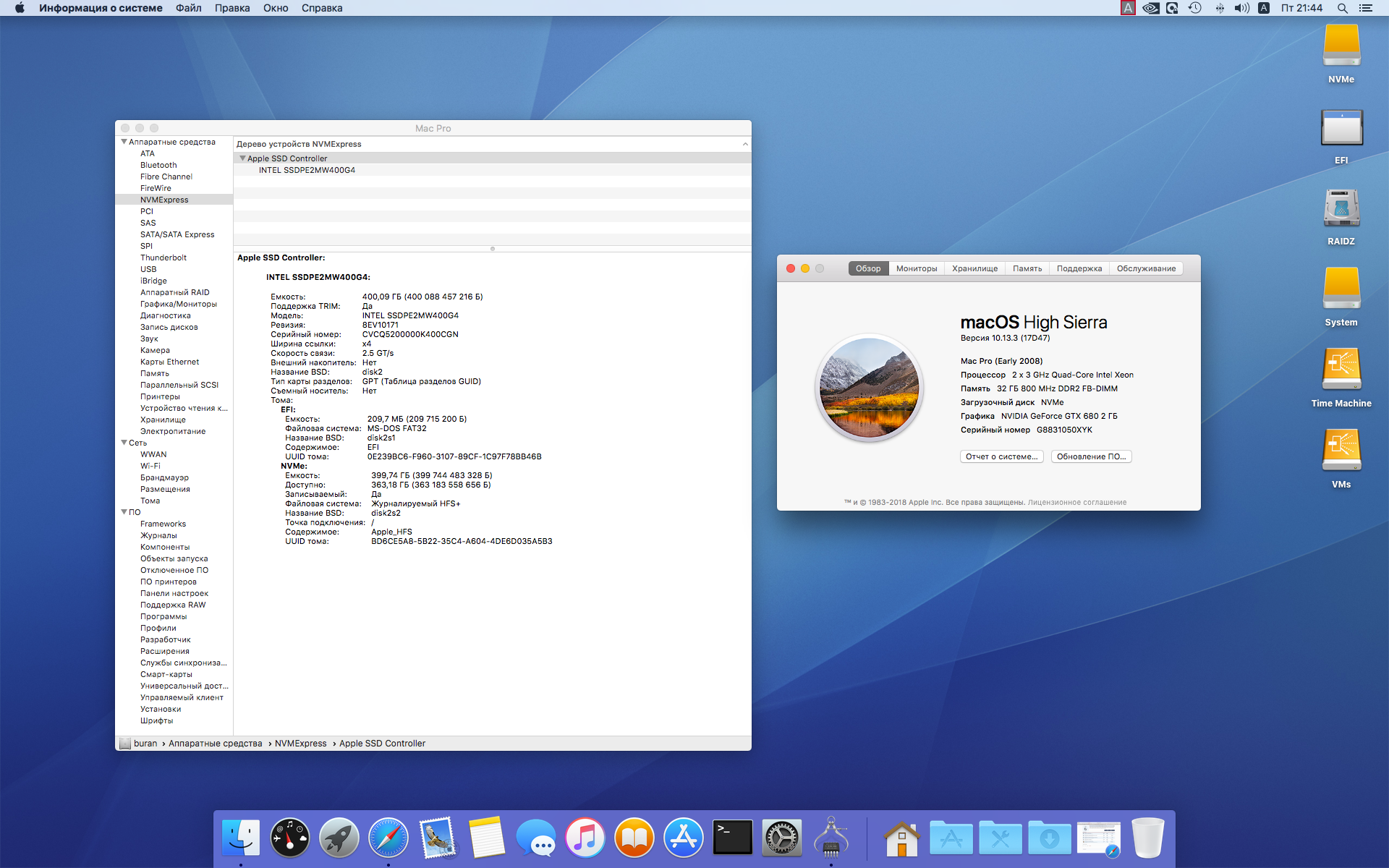

Im already done this. Intel 750 NVMe is bootable in Mac Pro 3,1 using rEFInd and NVMExpressDxe-64.efi driver in it.
Do you mind to share the detailed procedure on how to do it? This may allow the cMP boot from USB 3.0 or even have UEFI boot screen.
Well, it is simple. Almost. You need to use rEFInd on separate drive or partition of AHCI drive as a primary boot drive. In "drivers" folder place NVMExpressDxe-64.efi driver and APFS.efi (optional). By default rEFInd will load thoose drivers automatically. But, you also need to write in rEFInd's config a delay for searching devices, 5 seconds enough.
Installation of OS is more complicated. Default installer will no go, restoring using Disk Utility useless too. You need to install OS, using restoration process by Time Machine. TM will create Apple_Boot partition on NVMe drive, and place OS as well. On next reboot, rEFInd will show NVMe as bootable, and it will start.

Today i tested this in Mac Pro 5,1. Everything works so far. But found a problem. With unflashed (usual PC card) graphic card, rEFInd goes to hang. So no go for my gtx titan. Damn!

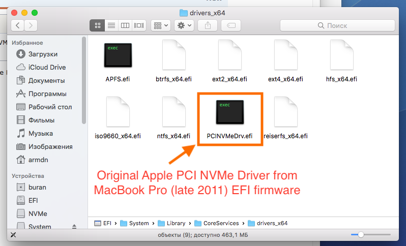

Also, i was in experiments with native Apple's NVMe efi driver now. Toked out from MacBook Pro (Late 2011) EFI image. Apple updates several EFI ROMs with APFS and NVMe drivers. Even for old MacBooks.

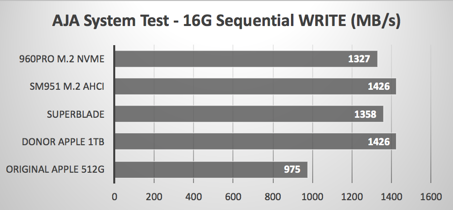

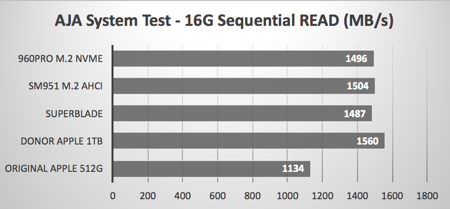

Note that Bare Feats measured NVMe vs AHCI in an MP6,1. http://barefeats.com/hard230.html
The AHCI drives were faster than the NVMe drives.
If you have apps that do massively parallel data transfers of huge files - then NVMe data drives could be useful. As a boot drive, jumping through hoops to use NVMe is most likely a waste of time.

Also where does one acquire the PCINVMedrv.efi driver. I've looked in the EFI partition on a late 2013 Macbook Pro running 10.13.3 but nothing there.
I don't see it in /usr/standalone/i386 either.
