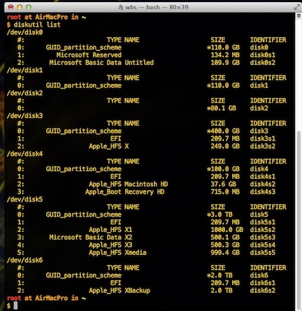

$ mkdir /Volumes/esp
root at AirMacPro in ~
$ sudo mount_msdos /dev/disk0s1 /Volumes/esp
mount_msdos: Unsupported sector size (0)
Im going to start over create partitions with iPartition before i install and try it again. So partition table looks like this.

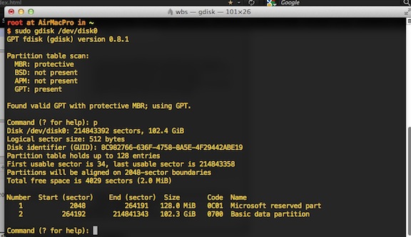

It's unclear if you're saying that your partition table currently looks like that screen shot, or that your goal is to make it look like that. This is important because the error you noted with mount_msdos suggests that either the ESP's FAT filesystem is damaged or the ESP isn't on /dev/disk0s1. (The ESP can be just about anywhere, although it's most commonly on /dev/disk0s1.) If you're certain the ESP is /dev/disk0s1, you could try doing a filesystem check on it. I'm not sure of the exact command from OS X, though (my Mac is powered down at the moment). In most Linux distributions it would be "dosfsck /dev/sda1" (/dev/sda1 being Linux's equivalent to /dev/disk0s1).
Also, on a Mac it's possible to install rEFInd on an OS X boot partition. This makes it a little bit easier to access the rEFInd files from OS X, although it might be harder to do so from other OSes.
It's unclear if you're saying that your partition table currently looks like that screen shot, or that your goal is to make it look like that. This is important because the error you noted with mount_msdos suggests that either the ESP's FAT filesystem is damaged or the ESP isn't on /dev/disk0s1. s.
I created partition table as shown from here with 2 different formatting tools with out success. When I use iPartition, partition did not show up from Windows 8 Install Menu. It show as UN-formated Disk. I use diskpart from Windows 8 Repair to create EFI, MSR, Primary

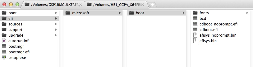

After comparing Windows 7.iso to Windows 8.iso
You notice from screen shot 1,iwhich is windows 7.iso. There no "boot" folder in /EFI/ like Windows8 ScreenShot 2 & 3
ScreenShot 1
zLBPzOvf
ScreenShot 2
http://db.tt/Qp4V946Y
ScreenShot 3
http://db.tt/yATb9eu8
