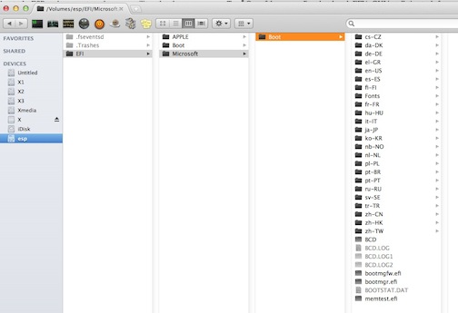

EFI Folder after installation incase anyone wants to take look. Apple EFI is MacPro 2010 Quad-Core x 2

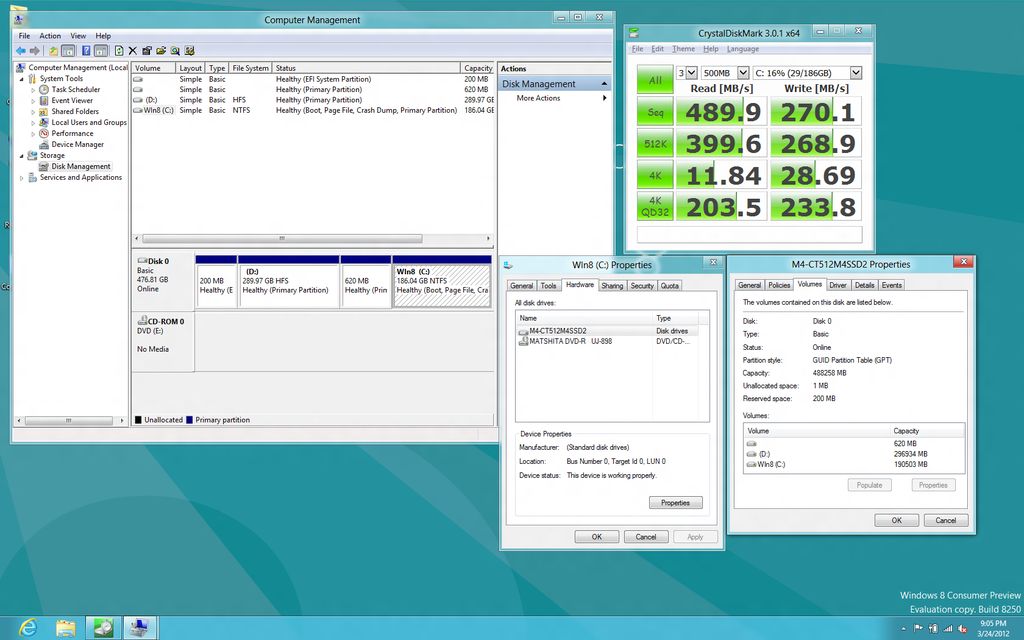

GREAT NEWS! 2009 MP cannot efi boot windows 8. However, going over to the netkas forum, there is a utility for updating 2009 to 2010 firmware. This updates the SMC boot. Ode because now my EFI boots are working from Windows 8. I will try the same method in my vimeo link. If it works, I will release the procedure.

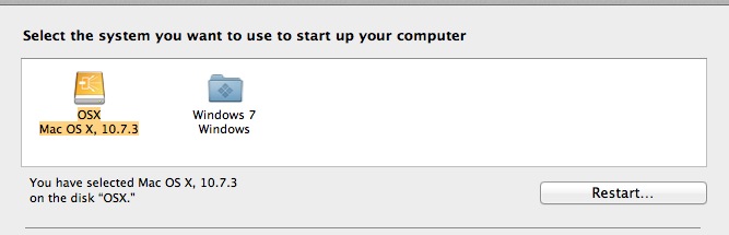

Success. I was able to get EFI boots working on my Mac Pro between both OS X and Windows 7 on the same drive. I will be posting a tutorial tomorrow. I need to cruise the vista right now. :mad:
Freakin' A! I was just about going to ask what the hell I was doing wrong since I have read success stories of win8 in EFI on the Mac Pro. I'll do the same and see if I get the same results - for science!
