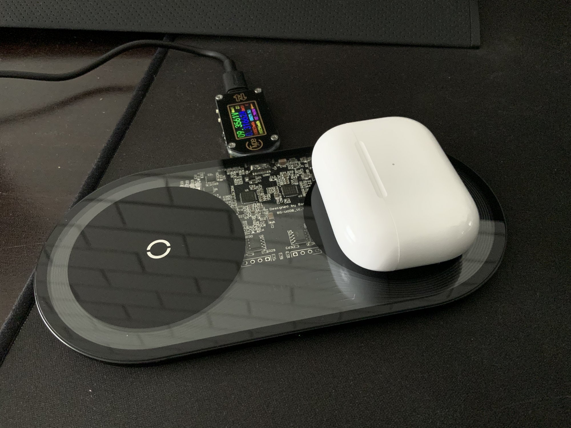

After trying a bunch of Qi pads, I can confirm this one works with AP2 -- Baseus 15W Dual Wireless Charger. The transparent one looks pretty cool in the wild :cool:

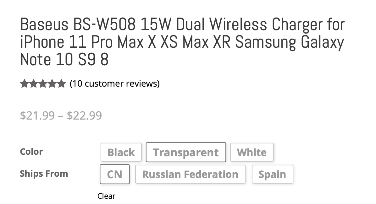

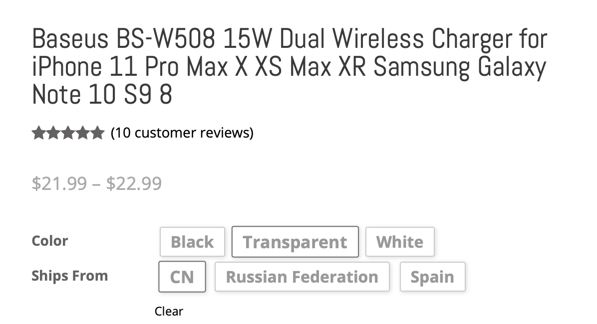

I'm looking at this now - the ships from "Russia Federation" got me to pause for a minute.

I see, yeah I think the one I got right now(choetech) is like the same it charges on and off for every few minutes but does seem to eventually charges it to full. Well I’ve decided to give the baseus one a go because it does specifically mention airpods and will update when it arrives.

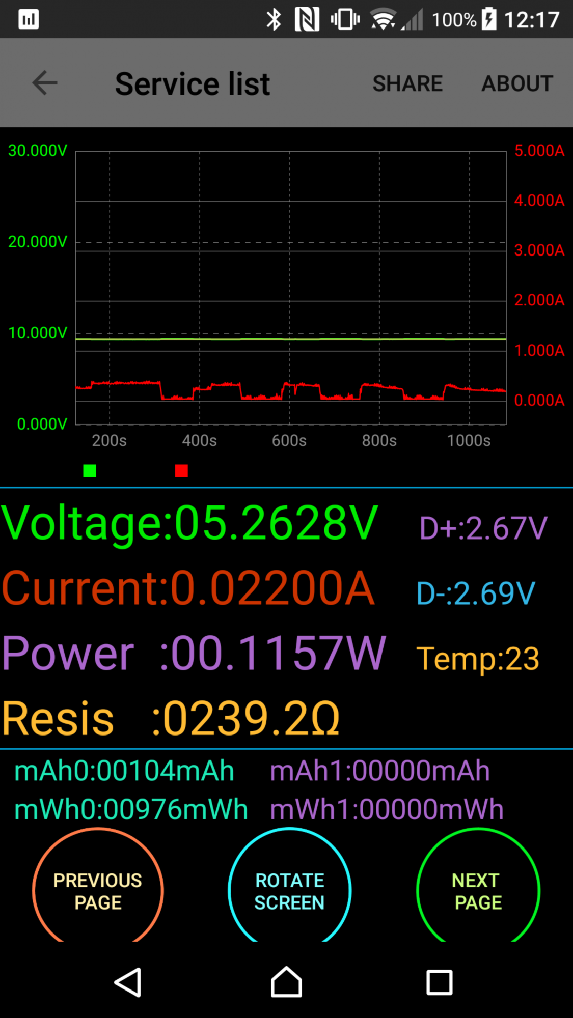

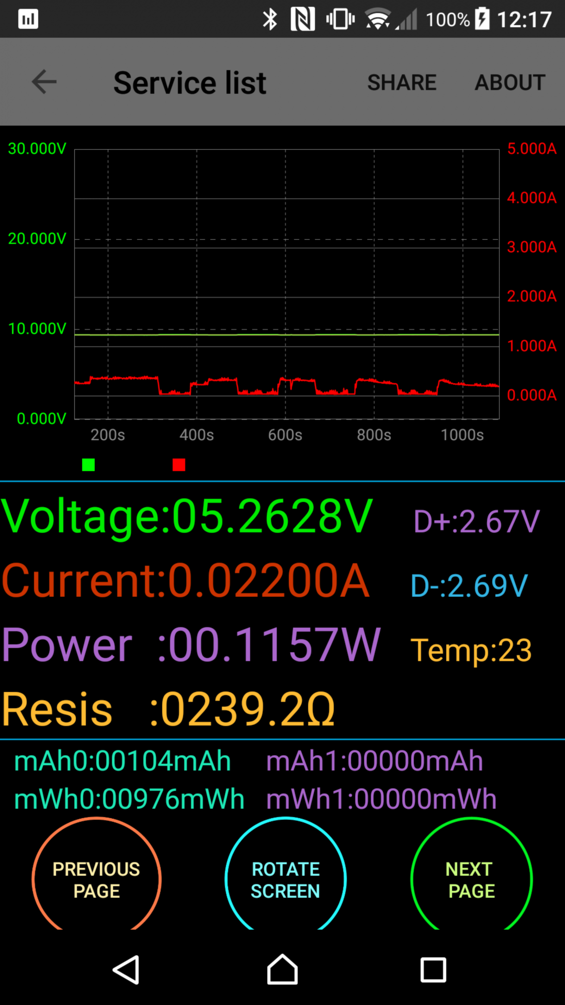

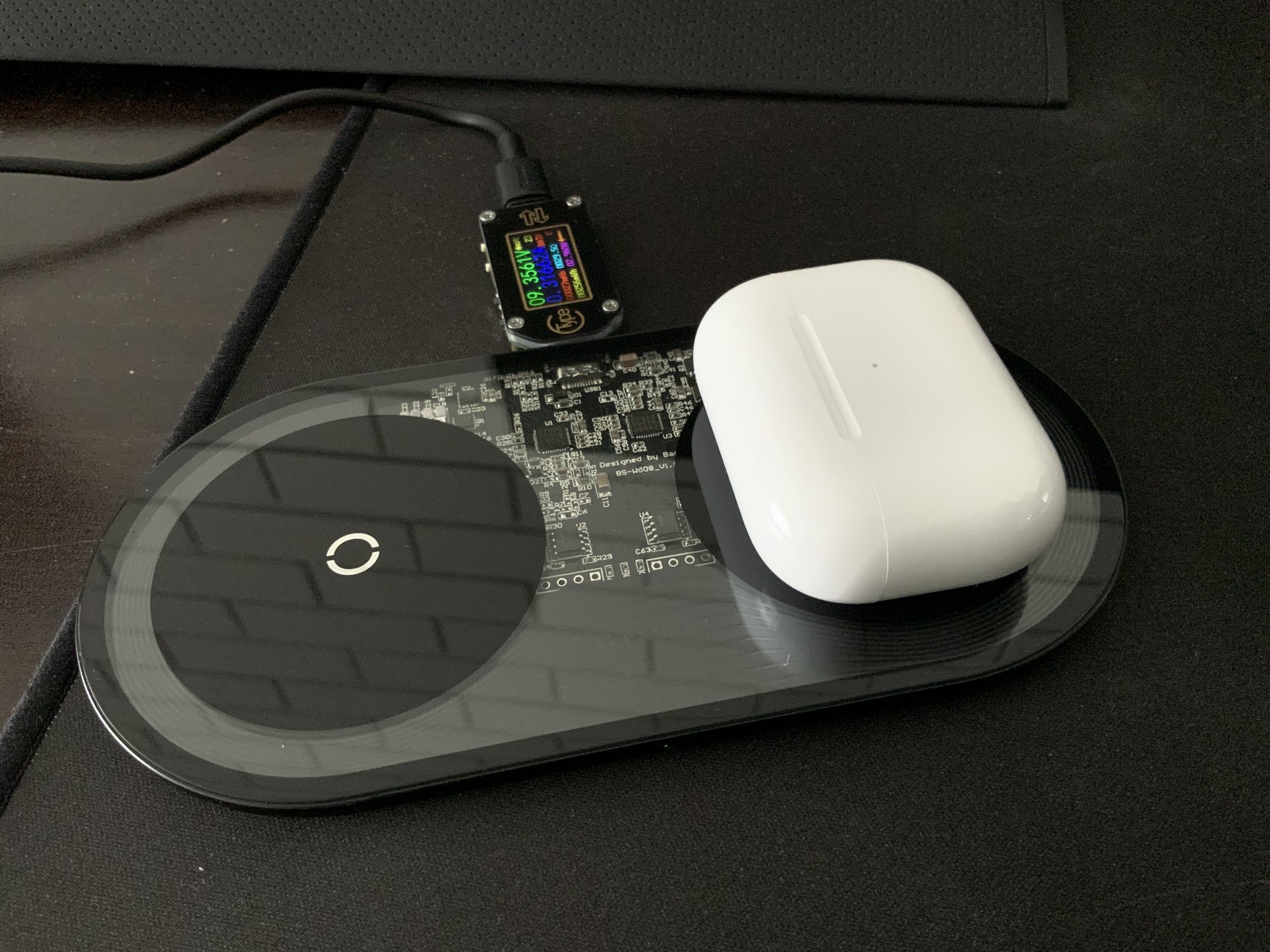

My baseus wireless charger arrived and it behaves the same. At this point I think its normal for it to charge on-and-off and eventually gets full. I went and plugged a usb meter on it and it does show that it consistently cuts power after a while then resumes.

I just did some more tests with my APP and found out that when the case and pods were not full, it wirelessly charge at lower rate (I measured wireless charger taking in around 2w). After the pods are full and the case is left to charge it seems to charge at a slightly higher rate (about 2.6w) and this causes the case gets warm it stops and will resume when it cool down.
