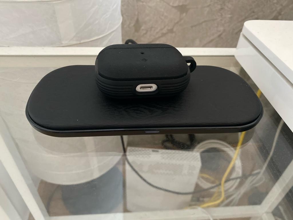

hello, the same thing happens to me, I put the airpods pro to the wireless charger and after 10 minutes it stops charging. I don't know if it would only happen with the first airpods pro. Has someone changed the case of the airpods pro and when giving a new one in an apple store, did this work correctly?

I have already tried three chargers, and the same happens to me with all three. Charges, and after 5 minutes for, and then, charger frequencies, it starts again. all three said they were valid for pro airpods, one from baseus, another from yootech and finally at Choetech, which I enclose with 5 coils . https://www.amazon.es/CHOETECH-Carg...ambrico&qid=1587169204&sprefix=choete&sr=8-12
I called Apple and, according to them, they don't know about this problem. Any solution, or someone who changed the cargo box and fixed it?
