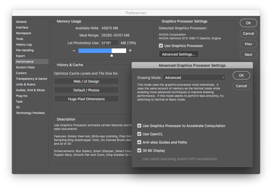

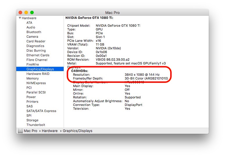

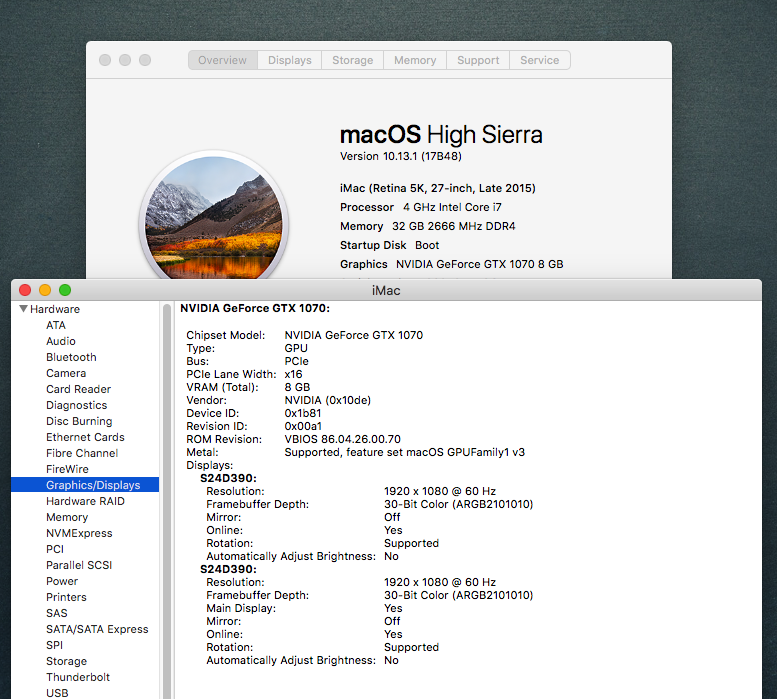

FWIW there's plenty of people who have 10-bit color working on macOS on NVIDIA hardware. For example:

Obviously there is no DirectX in MacOS. And our Geforce cards support 10bit colours.
Anyway, my Photoshop in MacOS detected that I am using a Geforce card, and let me enable 10bit colour.
TBH, I am very new in this area, not even know how to test if my 10bit setup is actually working or not. Any simple test that I can do to confirm your info is right?
