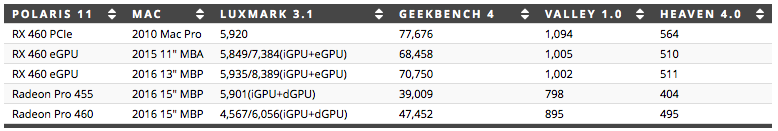

Depending on which GPU your 5,1 currently has, the RX 460 may or may not show much improvement. I ran some benchmarks to compare the performance of the RX 460 vs. Radeon Pro 460 in the Late 2016 15" MacBook Pro. You can run the same tests with your existing GPU in the 5,1 and determine whether it's worth it.
