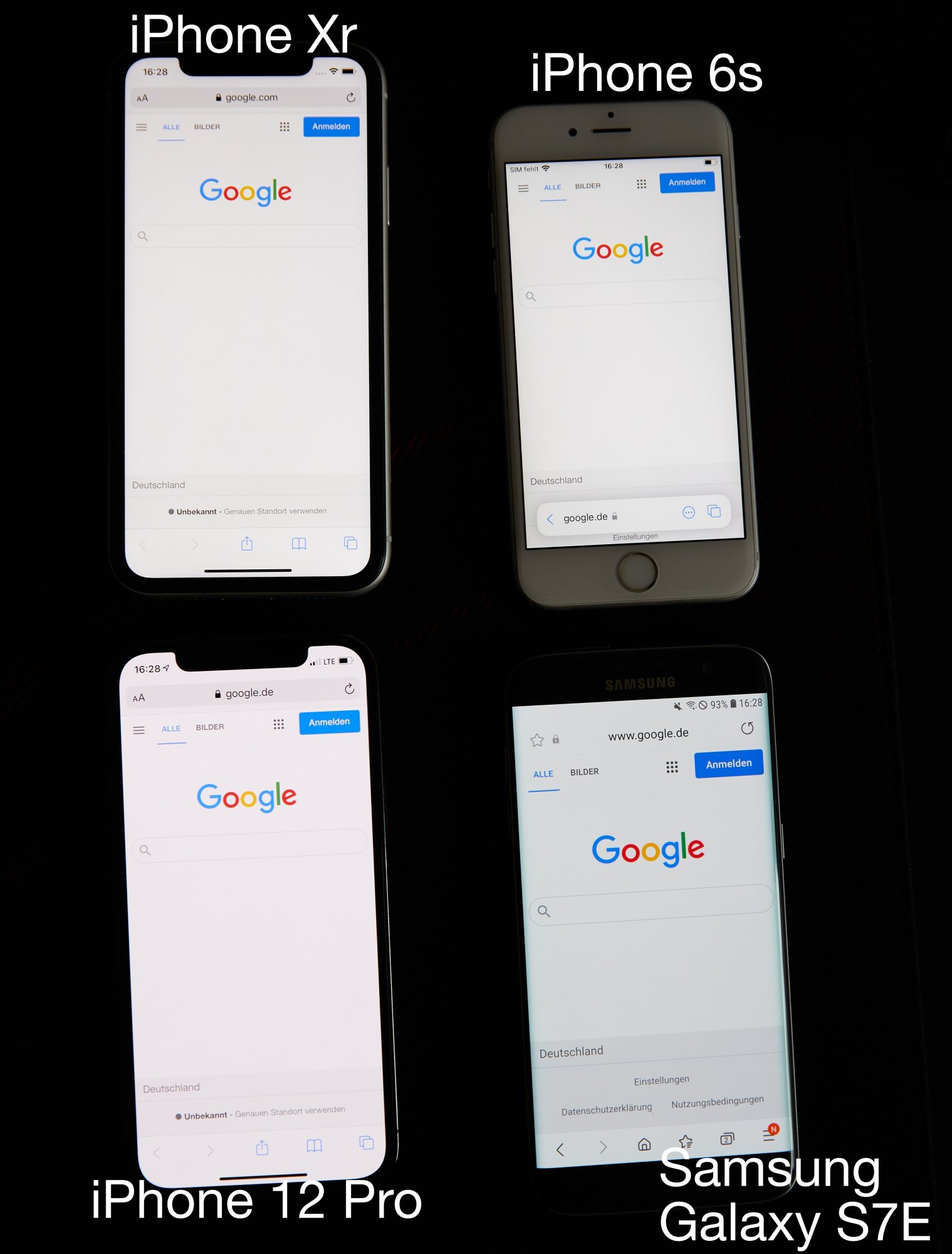

can you send a picture of your color balance compared to another phone?

Sure. Here you go. The camera was set to 6500k White balance. Daylight here. No artificial light. All on their max. brightness.
The Samsung can actually be calibrated and has different color profiles (like a TV). I set it to the default mode for this test.
True tone is off on all screens.
Is it warmer than the xr?
Actually not. The XR is slightly more greenish, the 12 slightly more red-ish.
There are two possible shifts: Blue-yellow, and green-magenta. Blue-yellow is correct on both. The Xr has slightly too much green, the 12 Pro slightly too much magenta.
No.. I meant a general color shift. I measured them all with a colorimeter for verification. The Xr is slightly too blueish and too greenish. The 12 Pro is good in blue-yellow, but slightly too much magenta. The S7E is completely off and the 6s has a bit too much yellow (it's old and maybe the glue turned yellow already due to excessive heat).
