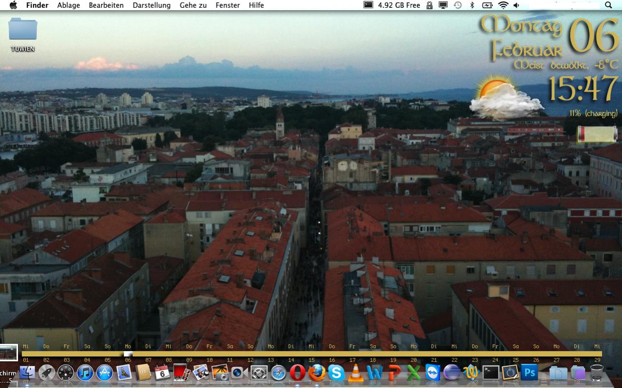

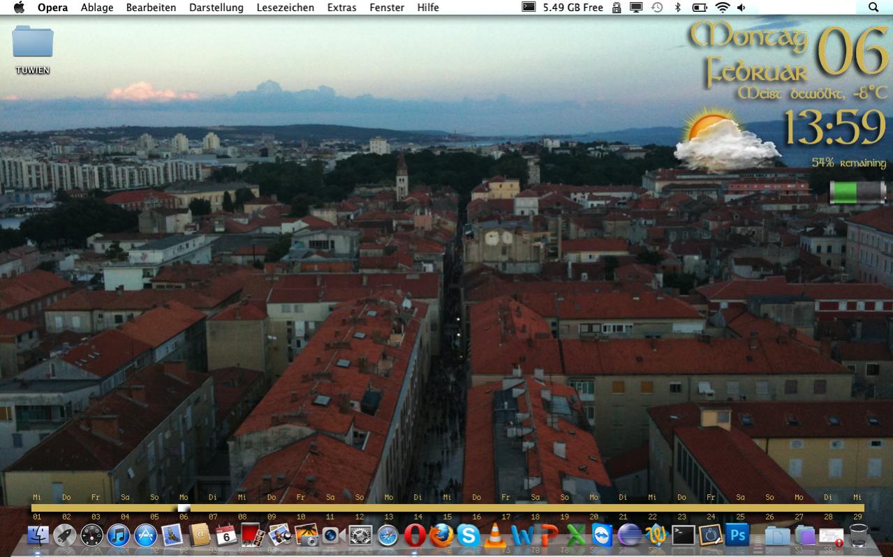

Hey guys, I would like to share my desktop with you :)
I collected some scripts from this thread like this one here
http://cl.ly/0v0T0V0R3G3m181j2m3Q
for the battery images and status.
It's awesome how people share their knowledge here :)
At this point a big thanks to all of you who made such awesome scripts to let my desktop look unique
The battery images are made by myself, I can upload it if some of you are interested in.
The font I use is Stonehange, google it :)
I also tried to use the same font for the calendar bar, but its not possible, because its not a fixed-width font.
The picture is the old town of Zadar, Croatia, taken from the highest point in old town.
Let me know if you like my style :D
