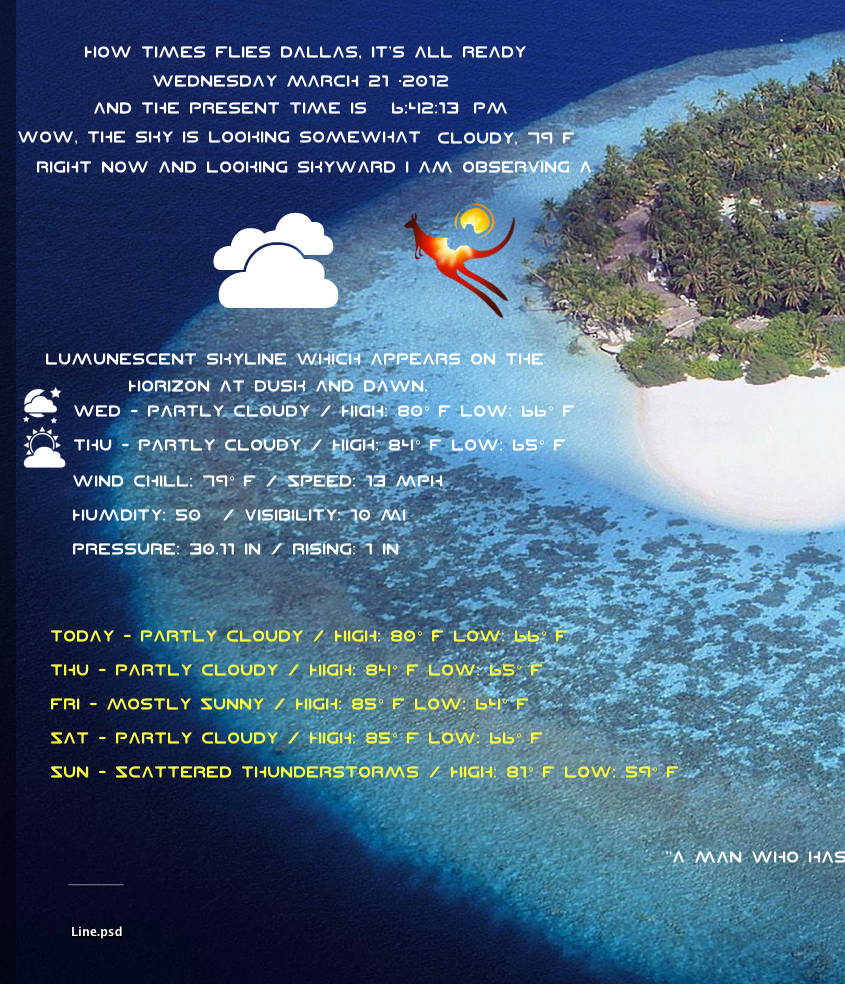

Have you run the apple script and what happens when you hit compile then run> What shows up at the bottom of the ascreen>
something like this:
"[33;01mToday - Partly Cloudy / High: 80° F Low: 66° F[39;49;00m
[33;01mThu - Partly Cloudy / High: 84° F Low: 65° F[39;49;00m
[33;01mFri - Mostly Sunny / High: 85° F Low: 64° F[39;49;00m
[33;01mSat - Partly Cloudy / High: 85° F Low: 66° F[39;49;00m
[33;01mSun - Scattered Thunderstorms / High: 81° F Low: 59° F[39;49;00m"
Did you make the the 2nd Image geeklet> It might help to post the command in the geeklet it should look like this:
osascript /Users/twosavy/Documents/Forecast.scpt
It has to be a simple error message on the file location command. If you save everything in a new file and use that file for your location, set refresh to 360 plus I don't see a DEFAULT geeklet location in your properties box>
I am far from an expert on this geeklet stufff but i will help you any way that I can.

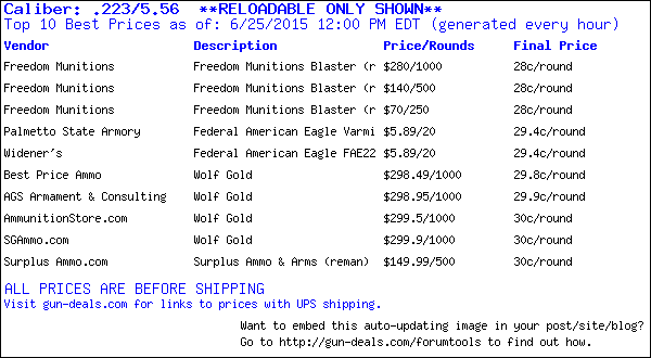

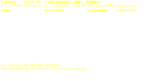

With ammo prices skyrocketing I decided to make a floating transparent version of this periodically updated png:
As you can see its an image file so mining the data is not an option. I decided to use imagemagic to invert the png and make the resulting black background transparent. It will drop the file 223_556_reloadablebk.png
into your /Username/Pictures directory where you can point an image geeklet. This can come in handy for any type of periodically updated png file with an ugly white background you wish to remove.
You will need to install MacPorts, ImageMagick and wget.
After you install MacPorts you can install ImageMagick and wget by typing this into terminal:
Code:
sudo port install ImageMagick
sudo port install wget
Here is the code to grab the png, invert it & make the background transparent:
Code:
#!/bin/bash
cd ~/Pictures/
# Image location http://gun-deals.com/dailyPrices/223_556_reloadable.png
wgetapp=$(which wget)
$wgetapp -c http://gun-deals.com/dailyPrices/223_556_reloadable.png
if [ -e ~/Pictures/223_556_reloadable.png ]
then rm ~/Pictures/223_556_reloadablebk.png
else mv ~/Pictures/223_556_reloadablebk.png ~/Pictures/223_556_reloadable.png
fi
/opt/local/bin/convert ~/Pictures/223_556_reloadable.png -negate -transparent black ~/Pictures/223_556_reloadable.png
exit 0
The result:

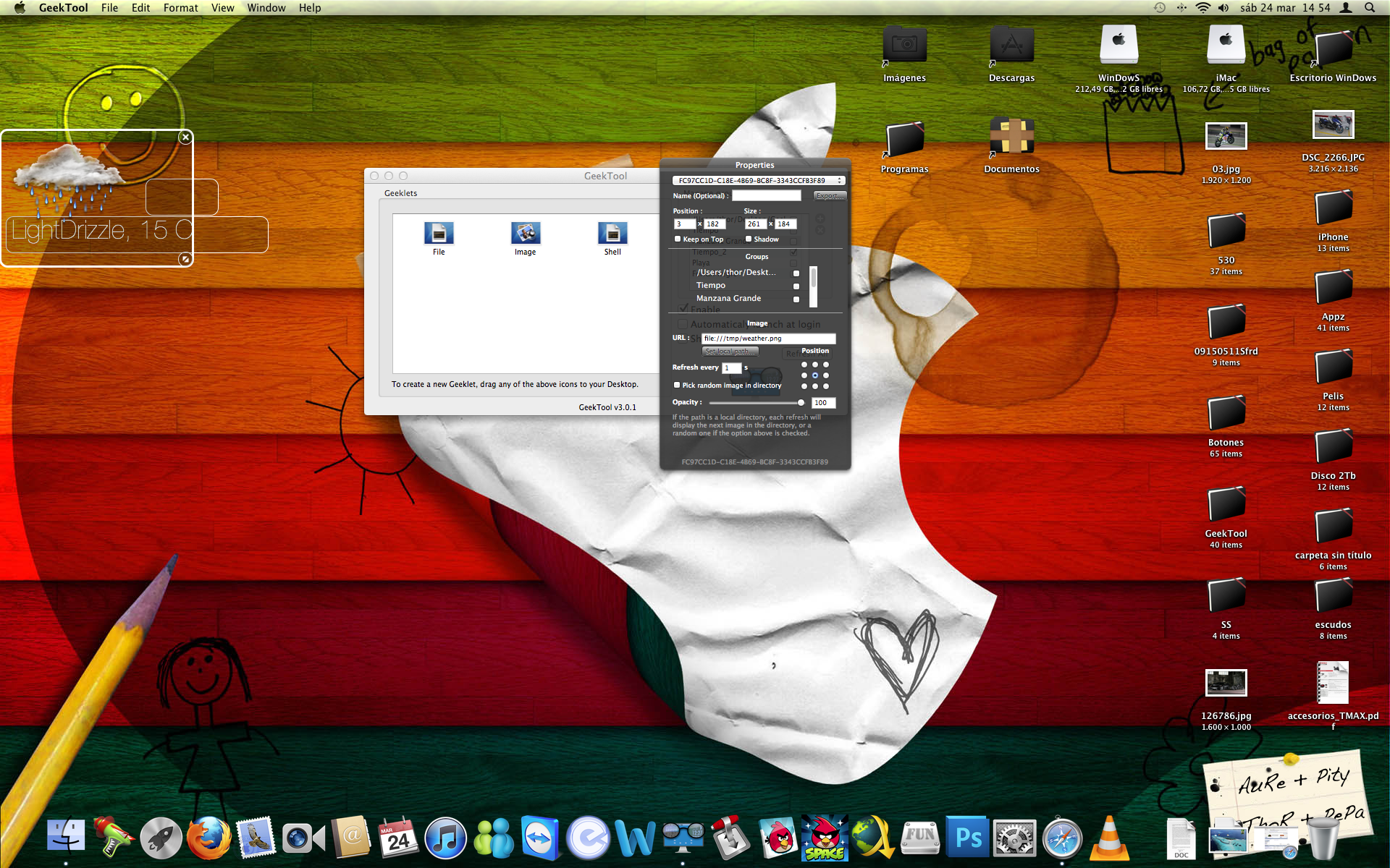

my weather image sometimes blinks, like a car signal light
Why?
If I setup refresh to more than 1 second it dissapears

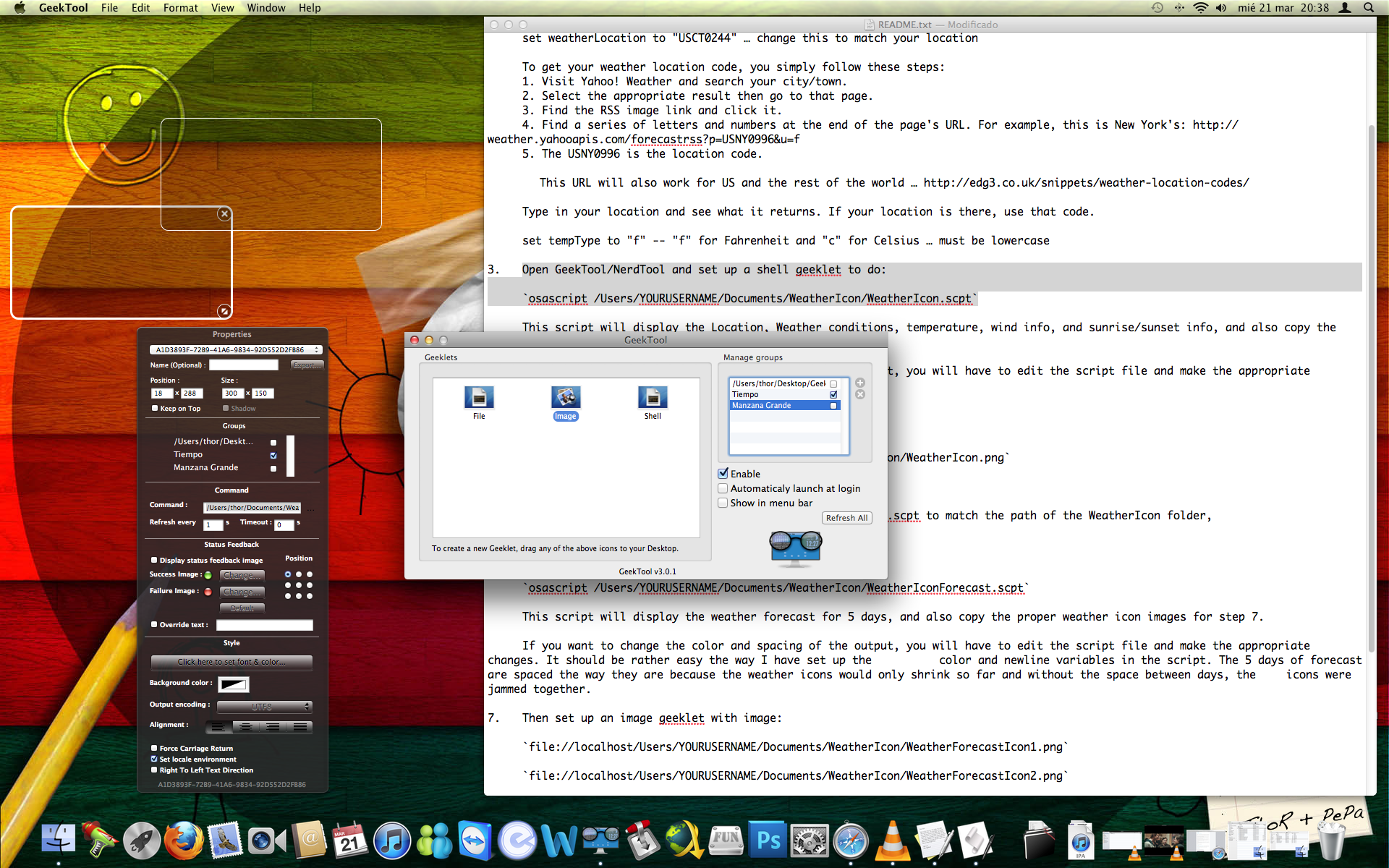

WeatherIcon
WeatherIcon … I wasn't thrilled with the weather icons that yahoo weather puts out and I know there are many other nice sets out there so I decided to see if I could figure out a way to use one of those other sets.
What I did was use the curl script to get all the weather info that I needed and write that to a file on the disk in one call. With that, I didn't have to keep going back the the rss to get info for each item that I needed for display or to know what icon to copy for display.
If you look at the 'txt' files that are written by the curl script, you will see some information listed as "code=xx" where xx is a number that corresponds to the weather icon that should be displayed. That number is then used to determine the correct png file to copy for display … so now I can use my own images and am not forced to use the yahoo images.
The script that gets all the information (and writes it to disk) also copies the correct icon for display, and it also displays the weather text info.
So … to display my weather information, I only need 2 geeklets … 1 shell geeklet for the curl script and 1 image geeklet.
The 5 day weather forecast information works the same way as described above. The only difference is that the weather forecast uses 6 geeklets … 1 shell geeklet for the curl script, 1 image geeklet for each of the 5 days.
