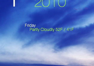

well i suppose the point is to be able to create a more dynamic arrangement of the information, but im sure there is a simpler way of listing future days without iCal shenanigans
give me an example of the use and i'll see what i can figure out
i was hoping to stagger the DAY and the FORECAST sections of the geeklet....
so if there is some simple line of code, much like DATE +%a to get todays date, but for tomorrow and the day after... i could then remove the date segment from the iCal geeklet and use it from another line of code.... i will draw you a picture hold please

like this, i apologize for the bad layout of this.... it was a quick and dirty, these are all echos of plain text...
you could get that layout utilizing the control you have in iCalbuddy
your divider between the date and title would be
Code:
-ps "|
so make that change and it will display as you have shown in the image

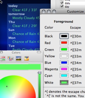

they would be the same color though, i know i can do the ANSI color scheme but it doesnt give me the same adjustability of the colorwheel
seriously use the ansi color set up you can then specify anything you want - white doesn't actually *have* to be white when you specify the color white in the iCalbuddy config all it's doing is telling the output to add the escape code for white you can however change white in geektool to whatever color you want it to be this gives you quick simple flexibility to make changes easier when you decide to change your colors... you just go in and change the colors for those ansi color codes using the standard apple color picker.
Just so you see what I am saying here's a screen shot
got it, thanks a ton man, that looks perfect

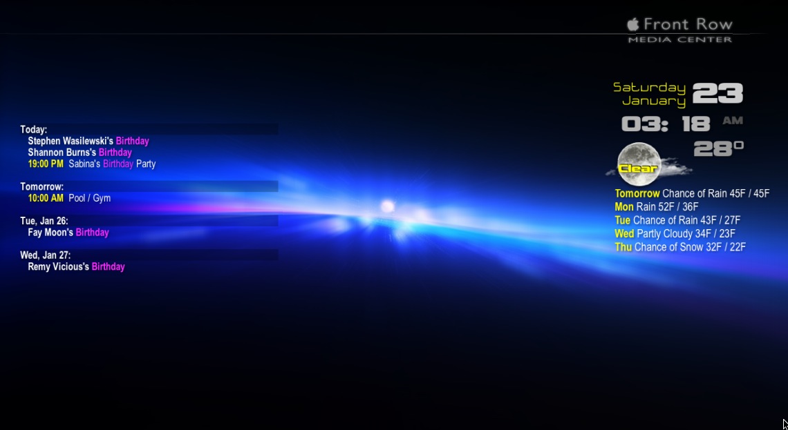

Thanks for the offer but I was playing around with geektool & look what i designed. I put photo borders and added a red tack,the only thing that's missing is the slight tilted angle but geektool does not allow me to. I used a .png file so that the tack can stand out & look real.
looks great man, way to make it your own! the turning of photos i had to do in PS because there is no rotation feature in geektool

icalbuddy has turned out to be the best tool possible when you use combined with subscriptions in ical I have birthdays from addressbook as well as subscribed to the facebook birthdays feed pipe it through uniq -q and it weeds out the duplicates but supplies the results from both sources as well as events I have and friends post on facebook so I know if they have anything coming up. Finally there is a subscription to a shared google calendar that me and my wife both can post to from our iphones calendar... this all is then displayed on the tv media center in a neat little package. Using icalbuddy's config file I have greater control over the final look of the output and also much more flexibility when I decide to change it.... it's a simple change in a single plist file.
latest screenshot

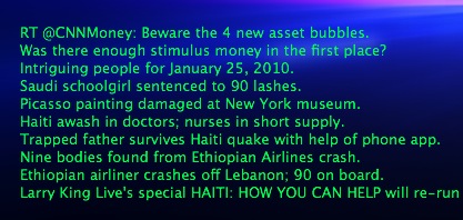

Here's my take on Twitter - RSS
After many attempts to use various feeds direct from their sources. I decided to look at a different approach. Be forewarned my code may not be beautiful but it does work.
so here goes... I start off by using twitters own built in search tool located at... http://search.twitter.com/advanced
This provides you with selectors to single out feeds as well as some other useful items such as the date to search within and even location (haven't tried location really yet)
so let's look at one of my feeds this is for CNN
Code:
Today=$(date '+%Y-%m-%d')
sinceDate=$Today
untilDate=$Today
TwitterUser=CNN
numPosts=10
curl --silent http://search.twitter.com/search.atom?q=+from%3A$TwitterUser+since%3A$sinceDate+until%3A$untilDate  | awk '/<title>/' | sed '1d' | sed  's/<content type="html">//' | sed 's/<\/content>//' | sed  's/^[[:space:]]*\(.*\)[[:space:]]*$/\1/' | sed  's@<\([^<>][^<>]*\)>\([^<>]*\)</\1>@\2@g' | sed  's/&lt\;.*a&gt\;//g' | sed  's/&//g' | sed  's/apos;//g'| sed  "$numPosts"q | sed  's|http://.*||'
I'll now attempt to break down what i have here
first we set some variables
The very first Today line sets todays date in the variable $Today in the format twitters advanced search uses to single out a date period.
The next 2 line sinceDate and untilDate set the range for what posts to pull from I have mine set to the variable set in the first line since I just want posts from TODAY you can set these to any other dates ahead or behind (note twitter only goes back about a week or 2 any further will fail to return anything.
The next line TwitterUser sets the twitter users feed to search for (you have to look it up before hand) In this case I'm using CNN
Last is numPosts this tells the script how many posts to return
The rest below isn't pretty and shouldn't require editing unless you know what you want to edit it for... Suffice it to say the rest is to pretty it up and remove the xml mess.
Here is a screen shot of what this produces you get 1 post per line
I'm sure it could be better code but it gets the job done... feel free to mod and enhance.
