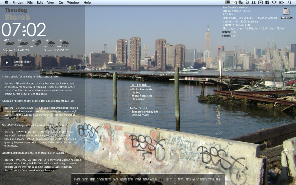

Here's my geektool setup at work...
Hope you like it ;-)

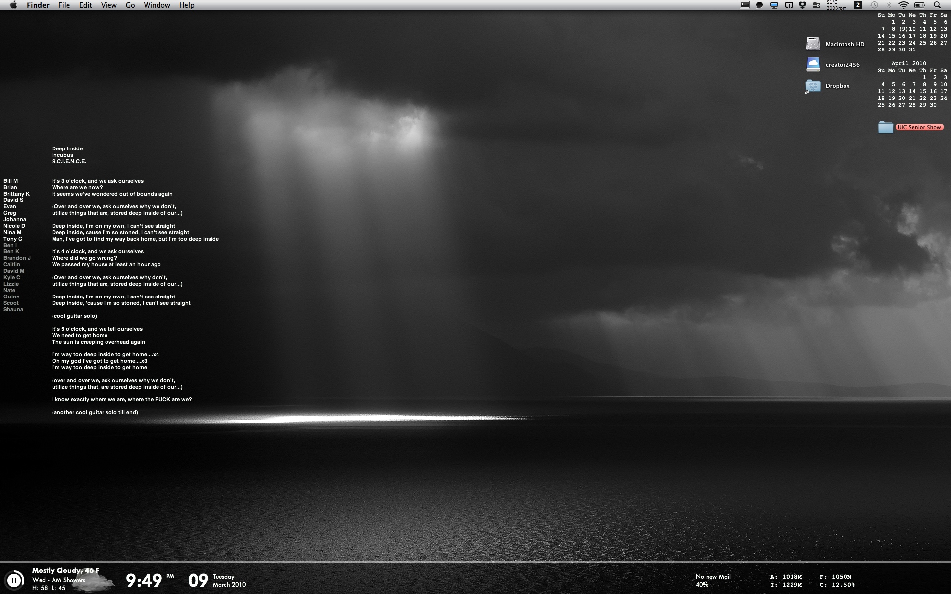

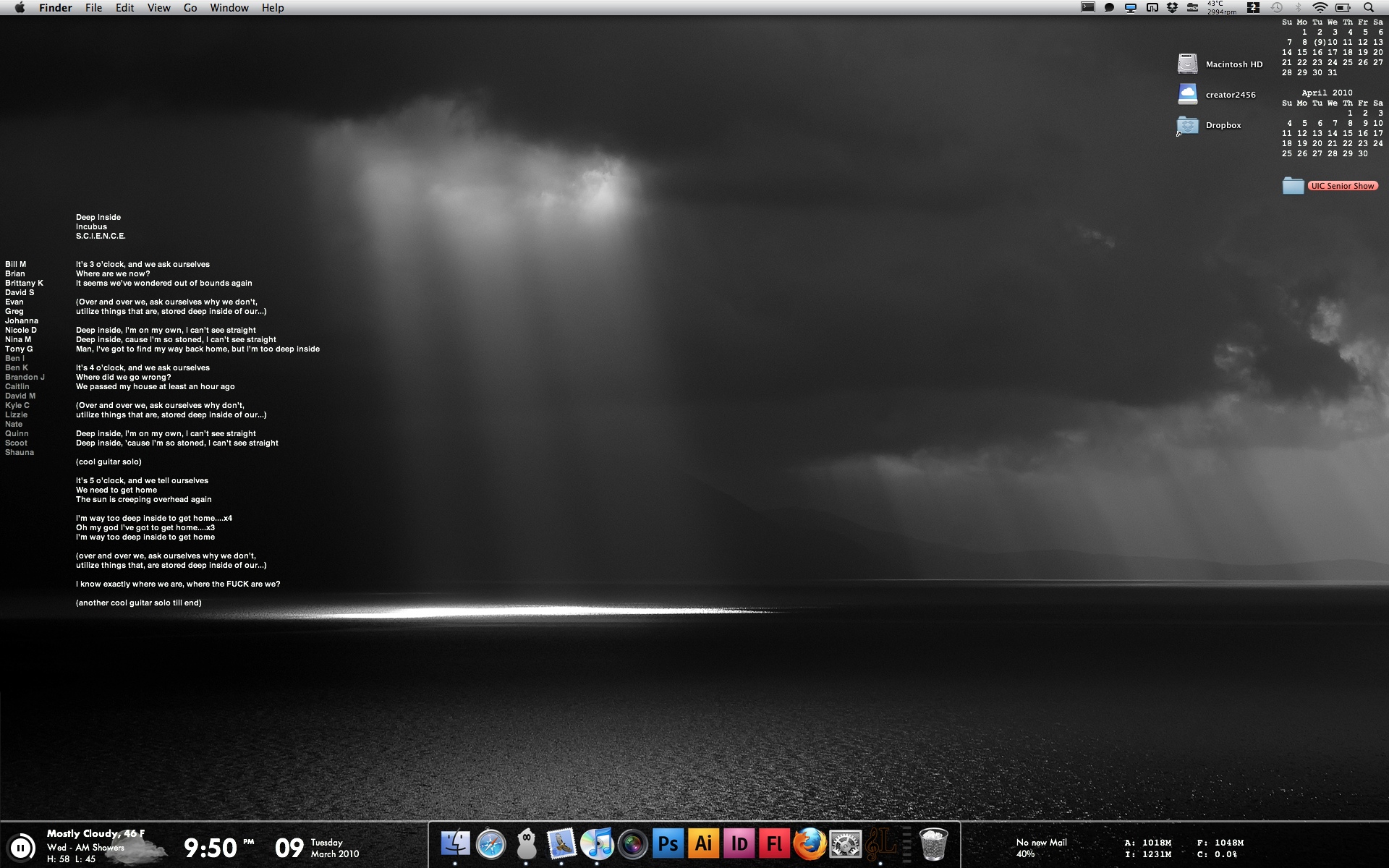

My iteration of tomge's layout and striker9's wallpaper. It may need some tweaking once I see how all the numbers roll over and change the spacing.
With dock and without. Need to find a new icons, just can't find anything I like for everything yet.
