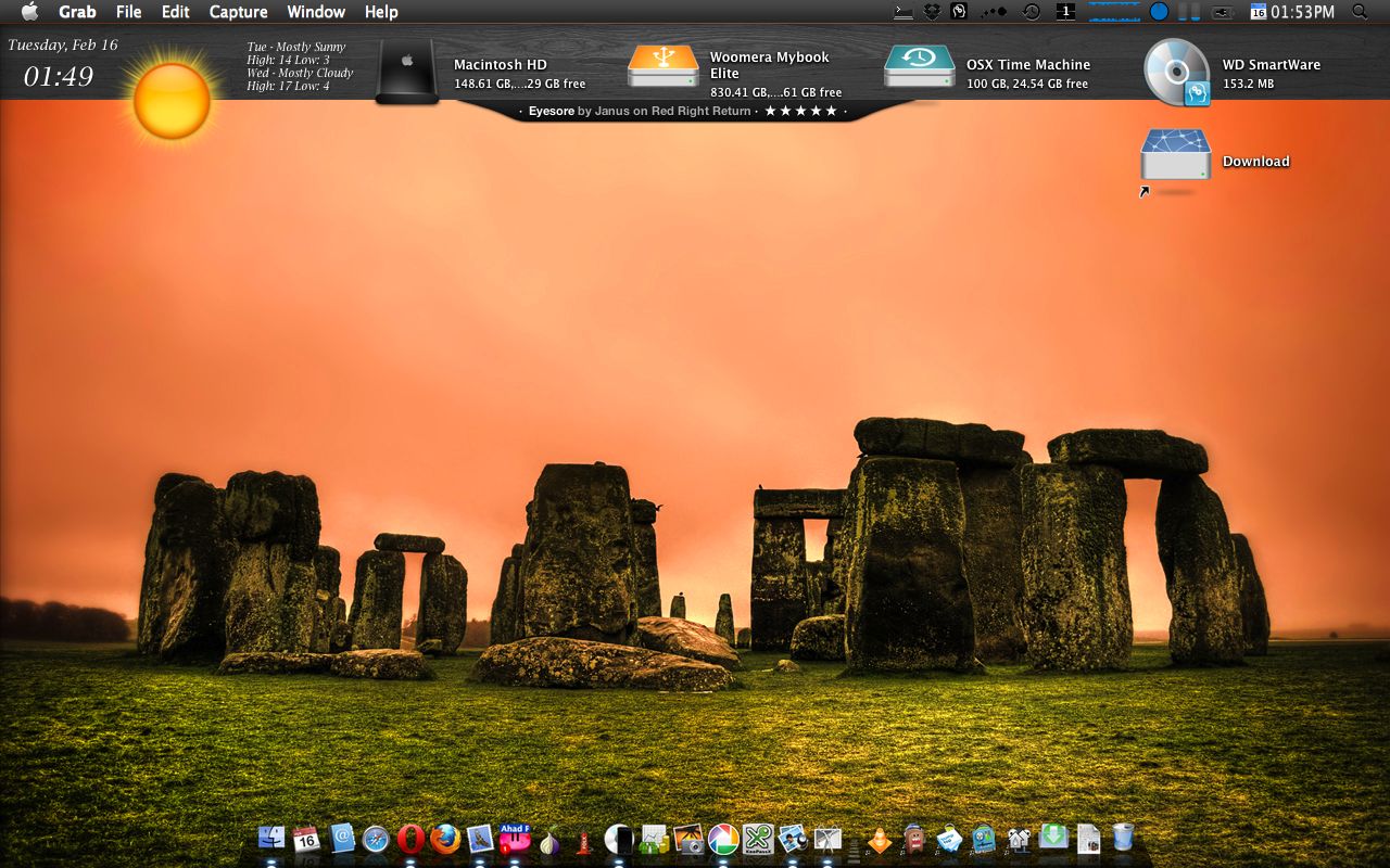

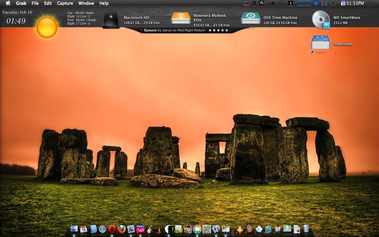

i came up with this idea last night so started configuring the desktop. dunno if anyone done this before, what you guys think?

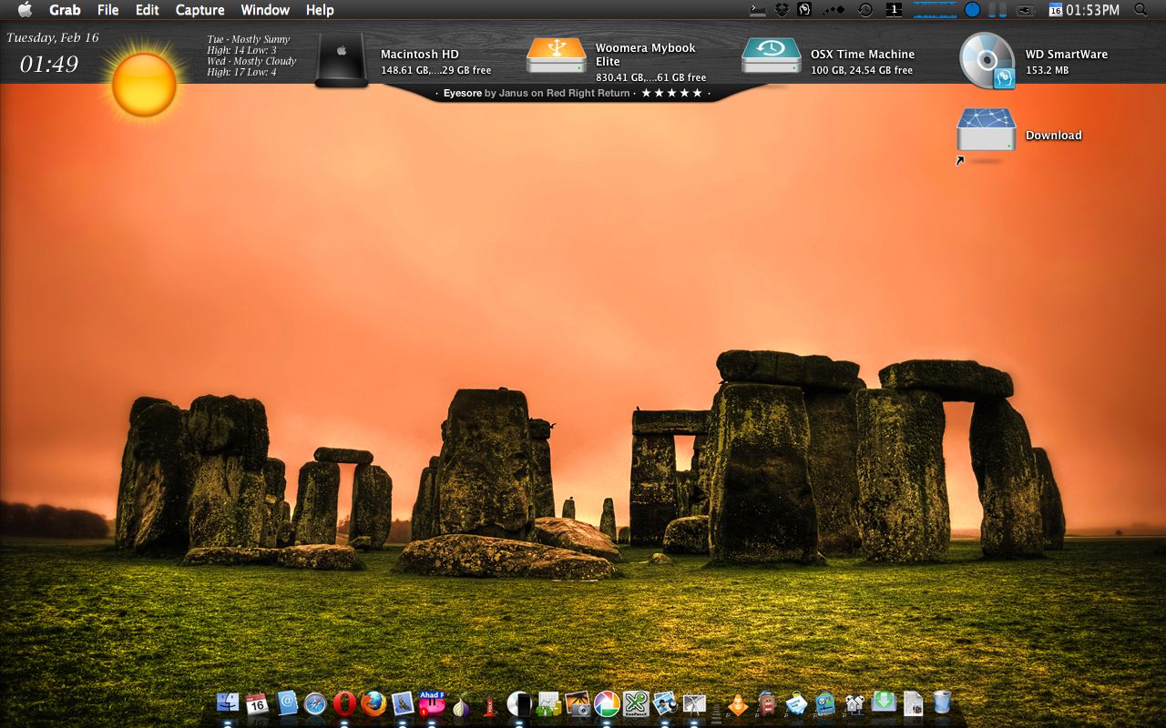

this is my desktop so far
