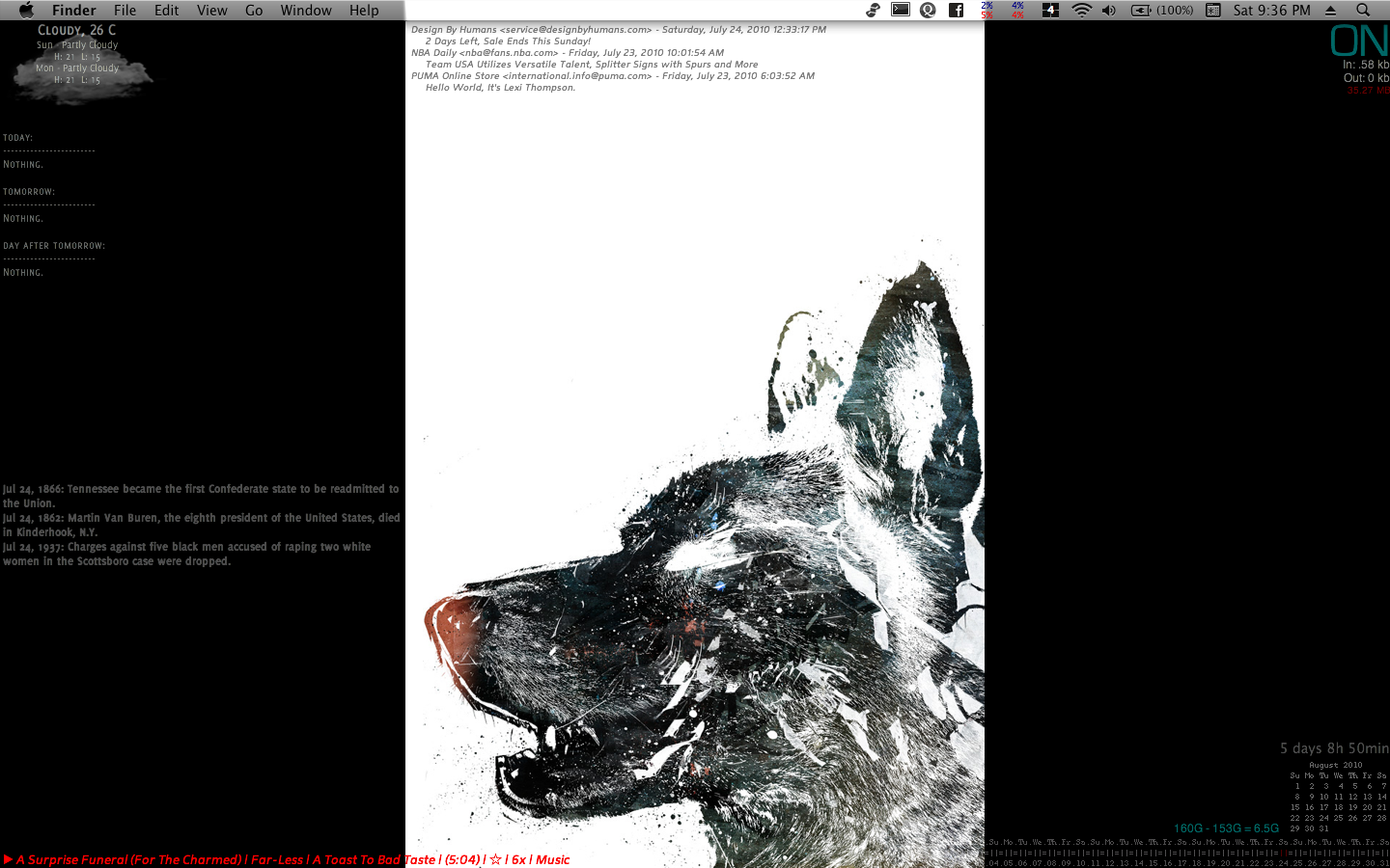

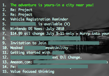

heres my desktop... changed since the last time... 😀 what do you guys think?
eyekyu - The lines are done by making a 0 refresh shell geeklet with a solid white background. It's only 1px tall and I set the opacity to 50%
The font is Helvetica Neue. I have used mostly Bold and Regular.
Ask any questions you like, though I am definitely not the foremost expert on some of this 🙂
brenm666 - The black shading is an overlay I made in Photoshop. It is an image geeklet, so you can change the opacity to taste. This way I can change the background easily to anything I like.
The iTunes in the menubar is a fantastic idea I picked up somewhere else (like many of my choices here!) It rarely becomes an issue, but sometimes shows it's ugly side. Thinking about revamping it a bit. I have tried Bowtie and several other iTunes scripts, but this is the best combination for me.
Your right about the time thing. It's extraneous, but I couldn't resist 😉. It might be cool to show the UTC. (I will not get rid of my menu bar clock, because its ALWAYS visible, even in apps.)
I like your desktop, though I think the massive contrast would throw me off. It is well executed and well thought out!

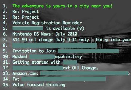

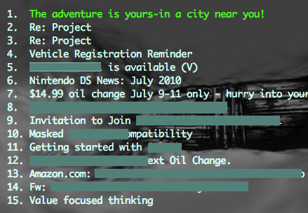

Inbox with unread highlighted
I managed a AppleScript script that will list the inbox and use a different color for the unread items. It took a bit more code because sorting the emails by date when you have more than one mailbox took some extra work with sorting. I set a max emails value at the top, currently 18, which you can modify. Attached is example output showing the first item is unread. The script moves unread emails to the top of the list to better ensure they will fit within the max setting. Enjoy!
Code:
osascript <<eos
tell application "Mail"
	try
		set {msgs, _a, _max} to {"", 0, 18}
		-- Sort messages by date received in descending order
		set theList to messages in inbox
		script bs
			property alist : theList
		end script
		set theCount to length of bs's alist
		if theCount ≥ 2 then
			repeat with indexA from theCount to 1 by -1
				repeat with indexB from 1 to indexA - 1
					if (date received of item indexB of bs's alist) < (date received of item (indexB + 1) of bs's alist) then
						set temp to item indexB of bs's alist
						set item indexB of bs's alist to item (indexB + 1) of bs's alist
						set item (indexB + 1) of bs's alist to temp
					end if
				end repeat
			end repeat
		end if
		set allmsgs to bs's alist
		repeat with _msg in allmsgs
			if read status of _msg is false then
				set _a to _a + 1
				set msgs to msgs & "
 " & _a & ". "
				if _a < 10 then set msgs to msgs & space
				set msgs to msgs & "[1;32m"
				set msgs to msgs & subject of _msg & "[0m"
			end if
		end repeat
			repeat 1 times
				if _a is equal to _max then exit repeat
				if read status of _msg is false then exit repeat
				set _a to _a + 1
 " & _a & ". "
				if read status of _msg is false then set msgs to msgs & "[1;32m"
			end repeat
		end repeat
		msgs
	on error estr
		estr
	end try
end tell
eos
Escape characters are used before the [1;32m and [0m pieces. To enter them properly you hit control+q [release] esc. This is an invisible character so you won't see it entered, but you can confirm it's there by moving your text cursor past it using the arrow keys and it will take an extra keystroke to move past it.

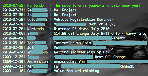

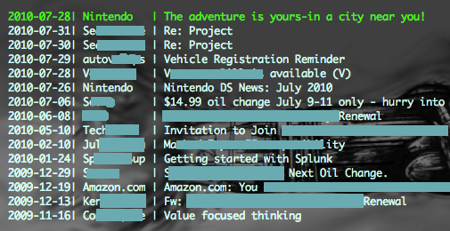

I improved upon the Mail inbox script I did 2 posts up. This one will has a column for date, sender, and subject now. It has the same max emails setting at the top. To adjust the width, there's a subjectWidth variable at the top that can be set.
Code:
osascript <<eos
global _max, _subjectWidth
set _max to 18
set _subjectWidth to 10
	set {msgs, _a} to {"", 0}
	script bs
	end script
				end if
			end repeat
		end repeat
	end if
	-- Grab all of the unread messages first
			set _a to _a + 1
			set msgs to msgs & return
			set msgs to msgs & formatMsg(_msg) of me
		end if
	end repeat
	-- Now get all other messages up to max amount
		repeat 1 times
			set _a to _a + 1
		end repeat
	end repeat
	msgs
end tell
on formatMsg(_msg)
		set msgs to ""
		if read status of _msg is false then set msgs to msgs & ""
		-- Date
		set _date to formattedDate(date received of _msg) of me
		set msgs to msgs & _date
		-- Name
		set _name to parseName(sender of _msg as text) of me
		set _name to toWidth(_name, _subjectWidth) of me
		set msgs to msgs & _name & " | "
		-- Subject
	end tell
	return msgs
end formatMsg
on toWidth(_str, _w)
	set _r to ""
	repeat with _a from 1 to _w
		try
			set _r to _r & character _a of _str
		on error
			set _r to _r & " "
		end try
	end repeat
	return _r
end toWidth
on replaceText(find, replace, someText)
	set prevTIDs to text item delimiters of AppleScript
	set text item delimiters of AppleScript to find
	set someText to text items of someText
	set text item delimiters of AppleScript to replace
	set someText to "" & someText
	set text item delimiters of AppleScript to prevTIDs
	return someText
end replaceText
on parseName(_str)
	set predelim to AppleScript's text item delimiters
	set AppleScript's text item delimiters to " <"
	set _items to text items of _str
	set AppleScript's text item delimiters to predelim
	set _name to item 1 of _items
	set _name to replaceText("\"", "", _name) of me
	set _name to replaceText("<", "", _name) of me
	set _name to replaceText(">", "", _name) of me
	return _name
end parseName
on formattedDate(_date)
	set _date to _date
	set {_y, _m, _d} to {year of _date, month of _date as number, day of _date}
	if _m < 10 then set _m to "0" & _m
	if _d < 10 then set _d to "0" & _d
	return _y & "-" & _m & "-" & _d & "| "
end formattedDate
eos
See my previous posts about using escaped characters for the extra coloring.
