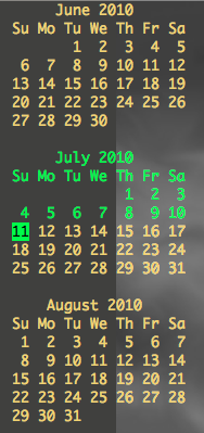

Attached is a 3-month calendar with the current month progress and day highlighted. Below is the code for it.
Code:
cal -m $(($[10#$(date +%m)]-1)) | sed -e s'/^/ /'
echo "\033[32m\c"
cal | sed "s/^/ /;s/$/ /;s/ $(date +%e | sed s'/ //') /$(date +%e | sed -e s'/ //' -e s'/\(.*\)/ \1 /g')/"
cal -m $(($[10#$(date +%m)]+1)) | sed -e s'/^/ /'
There are escaped characters on line 3. They are entered by doing a control+q esc (It's invisible when typed) and go right before the two [ chars toward the end of the line. When used inside a double quote area, you can use \033 instead, like on line 2. The coloring is done with ANSI color does. This page list the small list of codes.
Edit [20100801]: There was an octal parsing error so made the script parse to decimal explicitly.

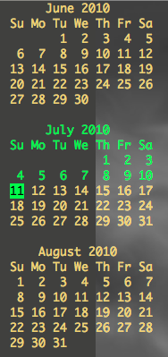

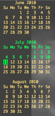

Code:
cal -m $(($(date +%m)-1)) | sed -e s'/^/ /'
echo "\033[32m\c"
cal | sed "s/^/ /;s/$/ /;s/ $(date +%e | sed s'/ //') /$(date +%e | sed -e s'/ //' -e s'/\(.*\)/ [42;30m\1[0m /g')/"
cal -m $(($(date +%m)+1)) | sed -e s'/^/ /'
I could not succeed in doing this. I would be happy if I could get only the current month to highlight the current day (and no colors, I could not figure out how to put the invisible character control+q esc and quotes failed). So all I want is the code for the current month with the day "boxed" because I hate that ##, it looks ugly! But thank you for the post angelwatt.
You should just need the third line.
Code:
One the second line, where the [42 is, just before it hold control and hit q, then release and then hit esc. There's no visual feedback when you do this. Do the same before the [0m. If you move the text cursor across these characters you should notice it doesn't move one time for the invisible char. That should tell you it has been entered correctly. Also, the ANSI color codes only work in Geektool 3+ I believe.
Code:
