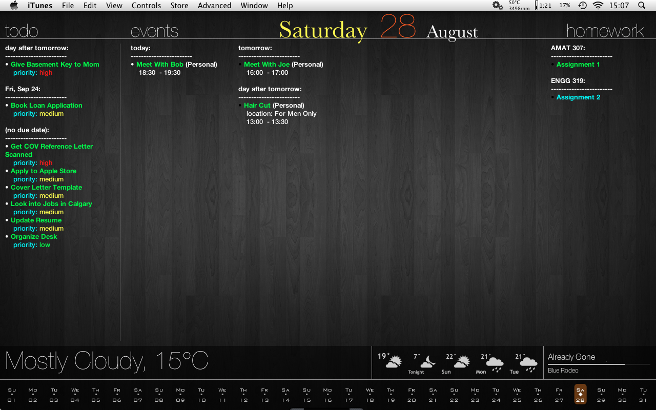

Here's Mine
Here's my desktop. Using Geektool for the date, current weather, top labels, lines and in conjunction with icalBuddy for the calendar stuff. Bowtie is for itunes (Zukunft Condensed White theme) and WideScape weather for Yahoo Widgets for the forecast. Dateline for the date bar at the bottom.
Let me know what you think!
I think that's my favourite that I've ever seen.
