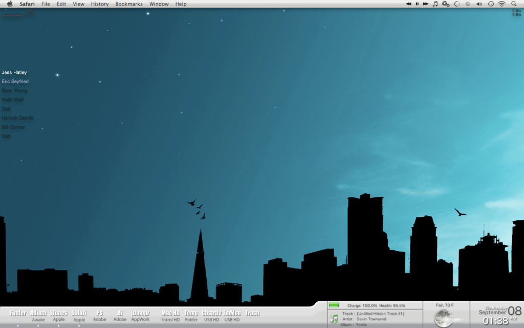

heres mine! ive had it for a little while, but ive never had time to upload it... what do you guys think?
for any questions about the scripts, just ask! 😀
