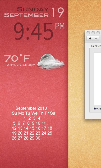

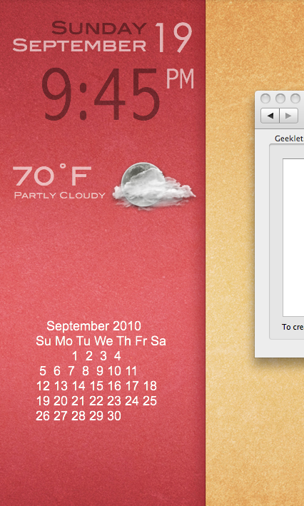

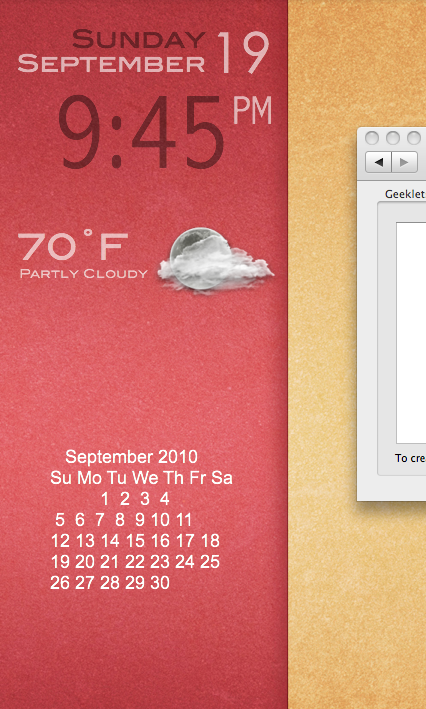

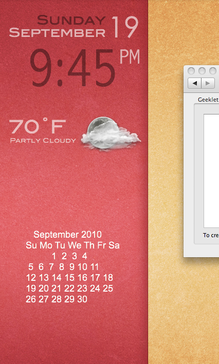

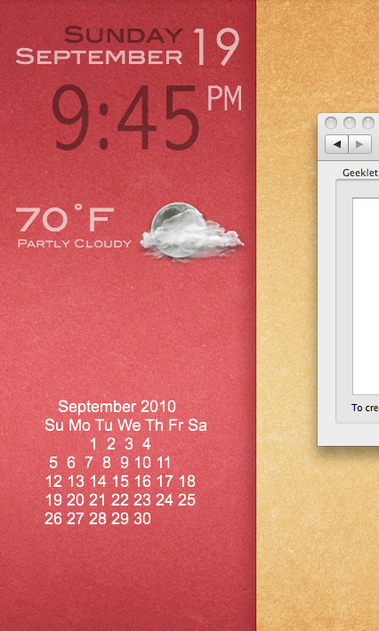

I am having a problem with the calendar script! I type "cal" in the command line (minus the "") and this is what i get(see attached image). It is not aligned right. I am not sure how to fix it either. I also need to find out how to make the current date a dif color too.

Use a fixed-width font.
I have tried over 30 fonts and still nothing is working. If u look at the pic below, the 4th is on thrusday and then there is nothing on the first fri and sat. then the 5th starts back up on sunday. and there is anouther gap later on also. why is this happening?

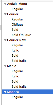

Try one of these fonts :
This is what I use for the calendar.
Code:
cal_head=`cal | head -1`; cal_tail=`cal | tail -7`; today=`date "+%e"`; echo "$cal_head"; echo "${cal_tail/${today}/\033[1;[B]31[/B]m${today}\033[0m}";
If you change the bit I have highlighted (31) you can change that 30, 31, 32, 33 etc for different colours.
For aligning font you just need to use a mono spaced font like Monaco
