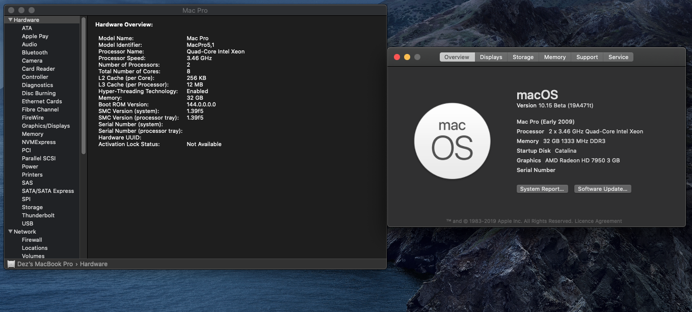

happy to report that all I needed was the -no_compat_check boot arg
hopefully it stays this easy!
(I was booting from my MBP9,1 in TDM, so i did not have to patch the installer etc)
luckily as it currently stands AVX is not a requirement, but as this is a beta everything is subject to change sadly

It will be interesting to see if MP3,1 can boot it.

Have you tested all the built-in apps and utilities ? maybe the new music app requires AVX ;)
What about support for the "not supposed to be present" devices like the original Wifi module ?
