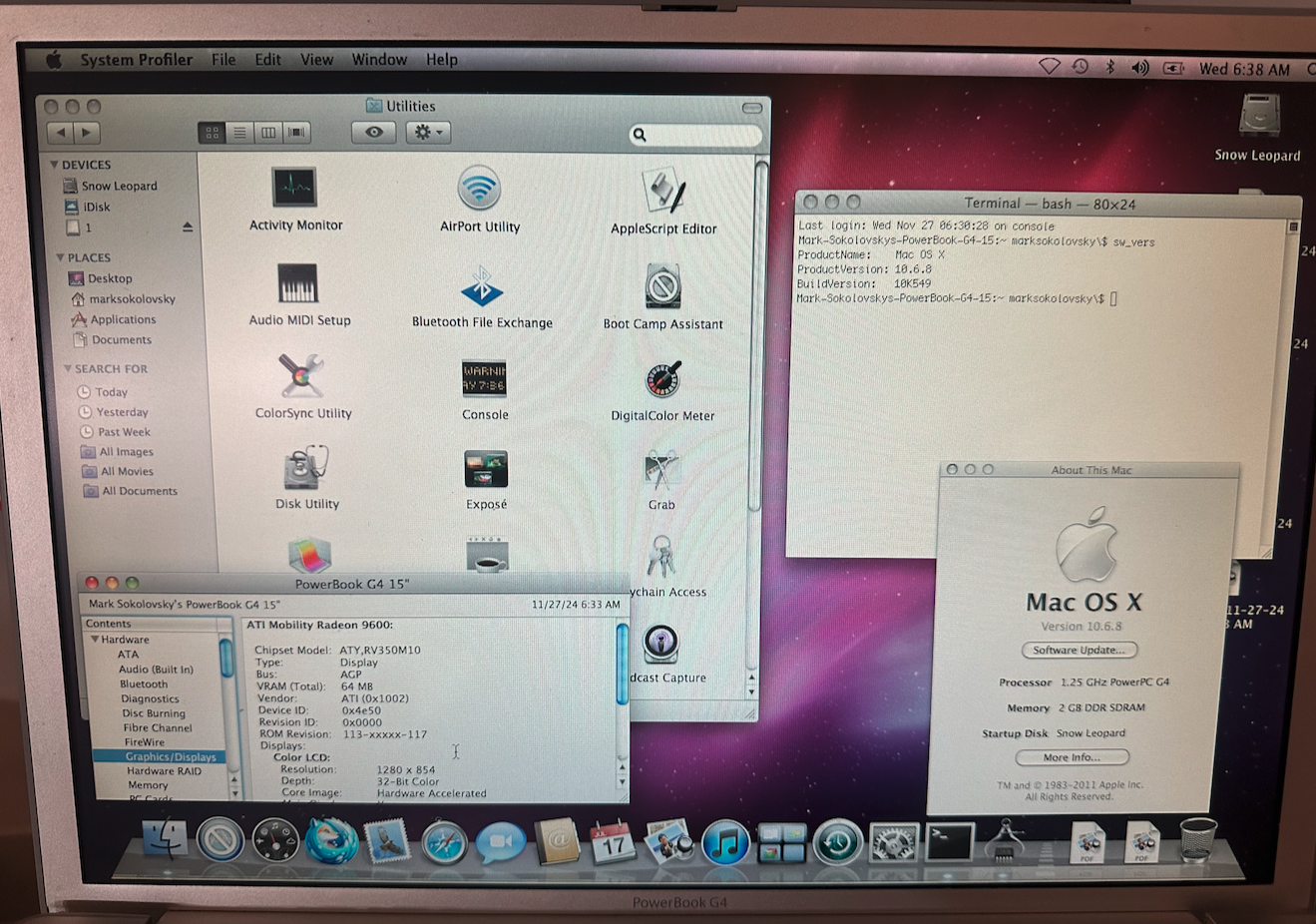

I’ve just finished catching myself up a bit. Skimmed through this entire thread, and a bit of the other one. I have been slowly getting into the retro computing hobby again after awhile.
Seems like I’ve missed quite a lot, because 2 weeks ago I was under the impression SL-PPC was still at 10A190 with no graphics acceleration on AGP GPUs, only PCI and PCIe.
Anyway, I’ve just booted up the image in this thread on my PowerBook5,4 and, I’m glad I decided to come back and read the whole thing, because I was real confused when it had a self-assigned IP address.
I manually configured an IP, and my router/DNS and I am able to ping my local network just fine, but it won’t go to the outside world. It also will not connect to my NAS but it can ping it, as well as every other device on my network. How odd. Regardless this seems to be a huge step forward overall from the DP builds that I had last used.

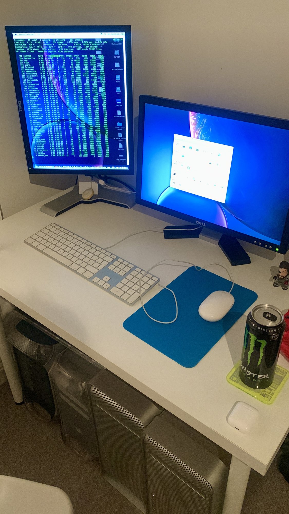

I'm quietly watching in the background, super excited, absolutely blown away by this bombshell of an announcement. I put my head down in 2020 when 10A190 was released and reviewed.. and yesterday I was jumping up and down with joy when 10.6.8 booted up on my 1.25 15" PowerBook G4!! It's been having KP's although I believe it's due to the dying KingSpec SSD in there. Am happy to test things out, encourage progress, and am writing up an article on low end Mac! Seriously, bravo, keep up the good work!! Love this love this love this.
