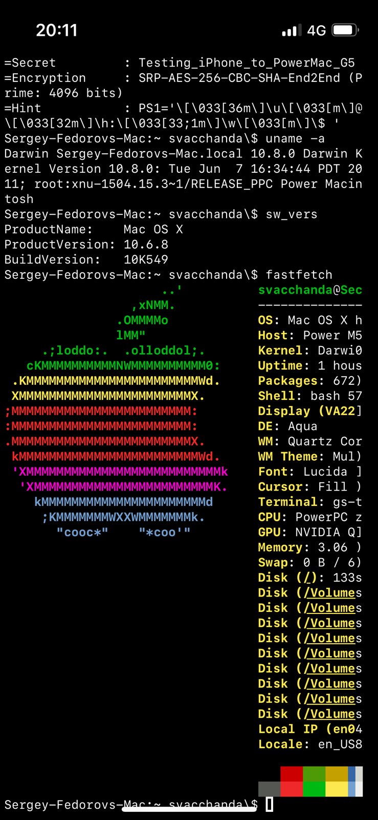

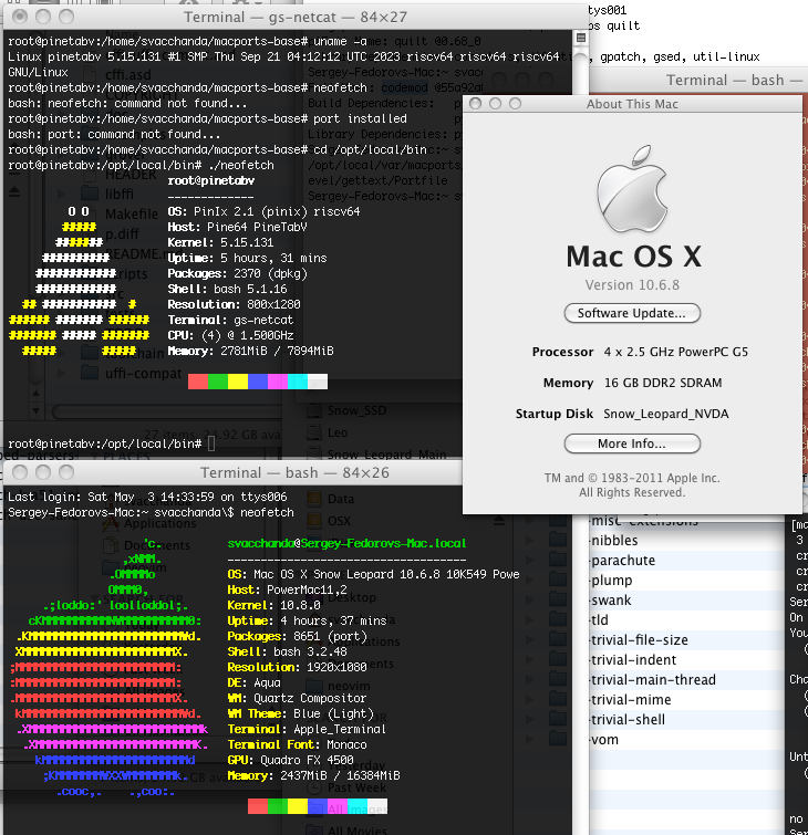

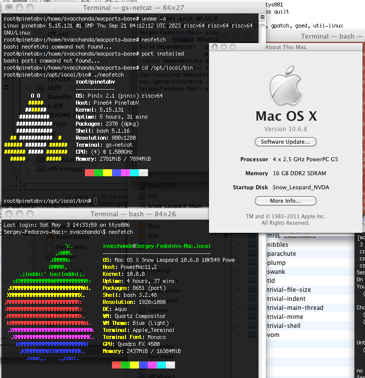

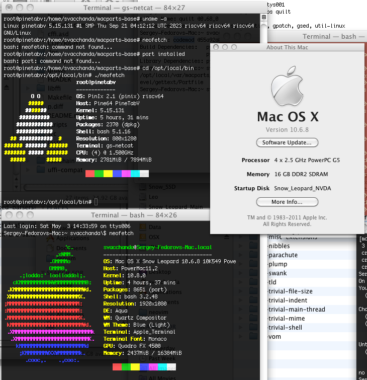

Just FYI, gsocket works fine with 10.6.8 and has no issues, apparently, with a lack of udp or using utdns.
It can do what tmate promised but did not deliver, being broken.
Basically you can connect any two machines, as long as both have some connection to internet and you have access to install the program. (I replaced the image with something better looking than a dark photo of the screen LOL.)
Works either way (from powerpc mac to any modern system and reverse), no special network setup.
By the way, this can be done from iPhone as well.

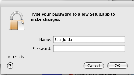

No errors. just the prompt for admin password is asked in a loop, no matter how many times i wrote my password it would ask again (really sorry about the video, i did struggle to record that, i tried many times, gave my password but i came back every single time_

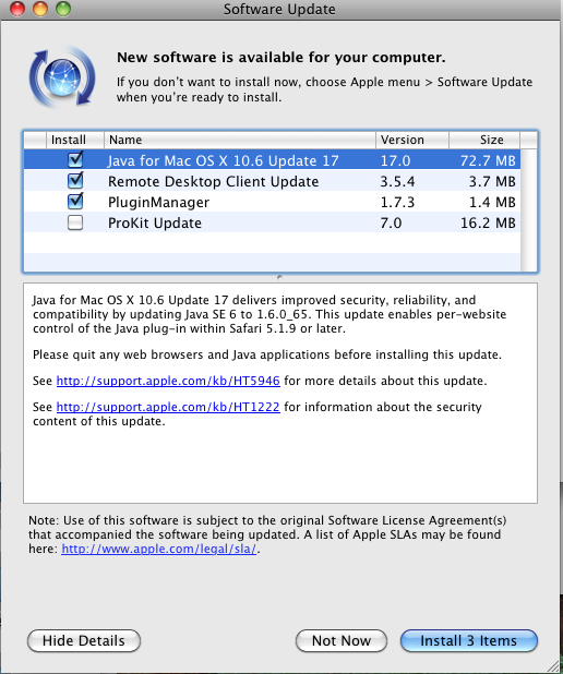

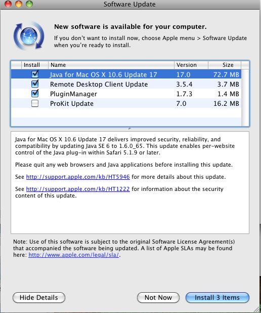

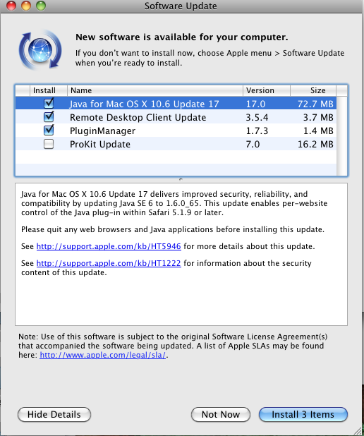

Is a good idea to update those three ?

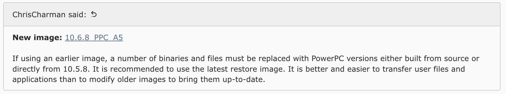

No. It is recommended to disable and/or ignore official Apple Software Updates designed for Snow Leopard as many of them contain binaries specifically optimised for intel architectures and will break a PowerPC Snow Leopard system.
If you want to explore individual updates, download them directly, meaning not via the Software Update application, and examine the components of the update packages - if they are Universal Binaries then they *may* work as is.
If you decide to explore further updates than have already been explored and integrated into the release images then please report findings here, if there is a benefit and it is reproducible then we can include the improvements in a future SLPPC community update, or others can follow the steps and replicate for themselves if they choose.

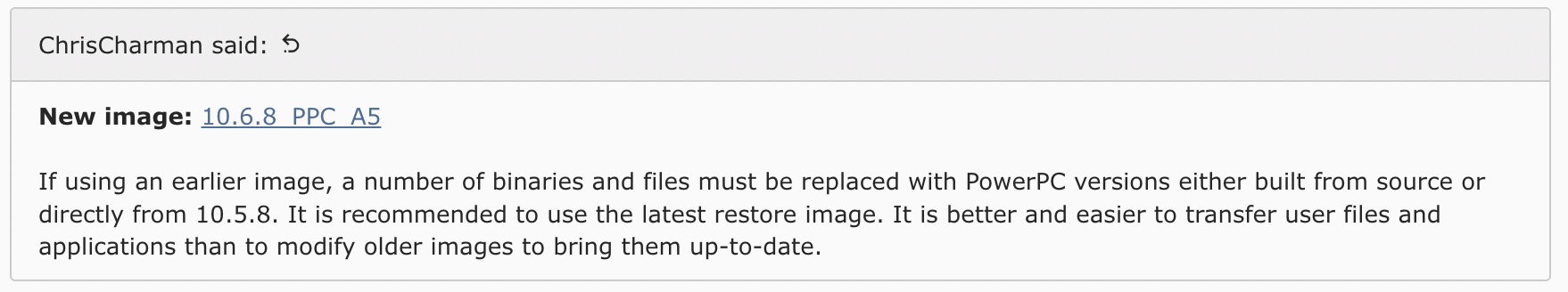

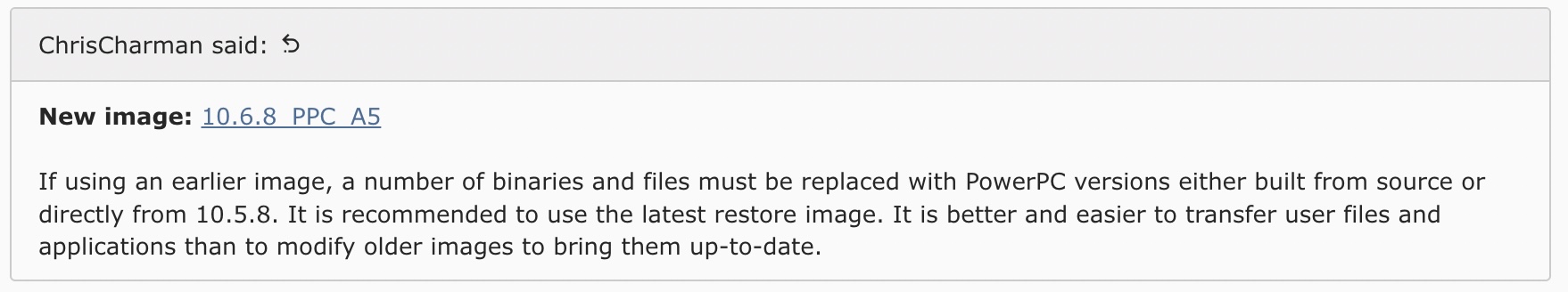

@educovas @ChrisCharman Could someone take a look? For some reason our image of 10.6.8 lacks some symbols in AudioToolBox framework (perhaps it was borrowed from 10a190? why?). Looks at the following:
Code:
dyld: _dyld_bind_fully_image_containing_address() error
dyld: Symbol not found: _ID3ParserClose
  Referenced from: /System/Library/PrivateFrameworks/MediaToolbox.framework/Versions/A/MediaToolbox
  Expected in: /System/Library/Frameworks/AudioToolbox.framework/Versions/A/AudioToolbox
Basically, a binary linked to `MediaToolbox` is unusable. Indeed, the symbol is missing:

For comparison, here is what original 10.6 has (from 10a403 DVD):

WHERE can I download the latest and greatest SL PPC from?
Tromping through the various threads that relate to SL PPC, I found this:
Is that the latest version?
I know that I have asked this before, but with recent changes, here we go again...
Now that I have a "cool, quiet Quad", I am interested in installing SL PPC on it, to see how it will work. It has been quite a while since I last tried out SL PPC; I am hoping that some serious progress has been made since then.
Yes Alpha 5 is the latest image so far.
There's also a brief explanation of some bugs that require replacing frameworks n stuff.
Hmmm... OK, it would not come up. It boots, plays the opening music that accompanies the initial install screen, and then gets stuck and dies.
Are there any special install instructions that I might have missed?
I installed it by putting the A5 DMG on my desktop and then using Disk Utility to "Scan for Restore", and then "Restore" to a 500 GB HDD with the "Erase the Destination" option ticked. Is there anything else I need to do?
@jktwice, "There's also a brief explanation of some bugs that require replacing frameworks n stuff"
Where will I find that explanation? It does not appear to be a file in the DMG.
https://forums.macrumors.com/threads/10-6-snow-leopard-powerpc-development.2439769/ the very first post is basically a small wiki. Peruse through it for links to installers, extra downloads you might want, and various tabs including a "bugs/workarounds" tab. Hope that helps.
The DMG is an image you have to restore. Could have been corrupted when you opened it, idk. I assume you're running stock G5 so 6600 and everything. Would suggest trying to restore again with a fresh dmg from the Google Drive link.
Hi @jktwice, still no luck. Curiously, while the opening install screen music plays, nothing EVER appears on screen.
Does SL PPC support the Nvidia Quadro FX 4500? This is the graphics card in my machine. I also have an eSATA PCIe card installed. It all works just fine under Sorbet.
This machine is anything but "stock". This is my "cool, quiet Quad", with both the CPU intake and exhaust fans replaced with uber-quiet ones, which run in isolation from the Quad's motherboard fan control headers, instead wired up through an independent variable speed fan controller. Full details of this setup are in my "Cooling a Hot Quad" thread.
I suspect that this is germaine, since what I see after the machine freezes up is that the Check stop light on the motherboard is turned on. I am guessing that the lack of "connected" fans convinces the installer that the machine will eventually overheat and so it proactively turns it off. Possible?
Yes, it does.
This can easily be the issue, AHCI kext is broken in SL. I have written about the issue. My Sonnet PCIe card does not work, for example, and sends the Quad into KP if detected. Easier solution is to trash two AHCI kexts, they are anyway useless. (Alternative is to use OF to disable the specific PCIe interface.)
