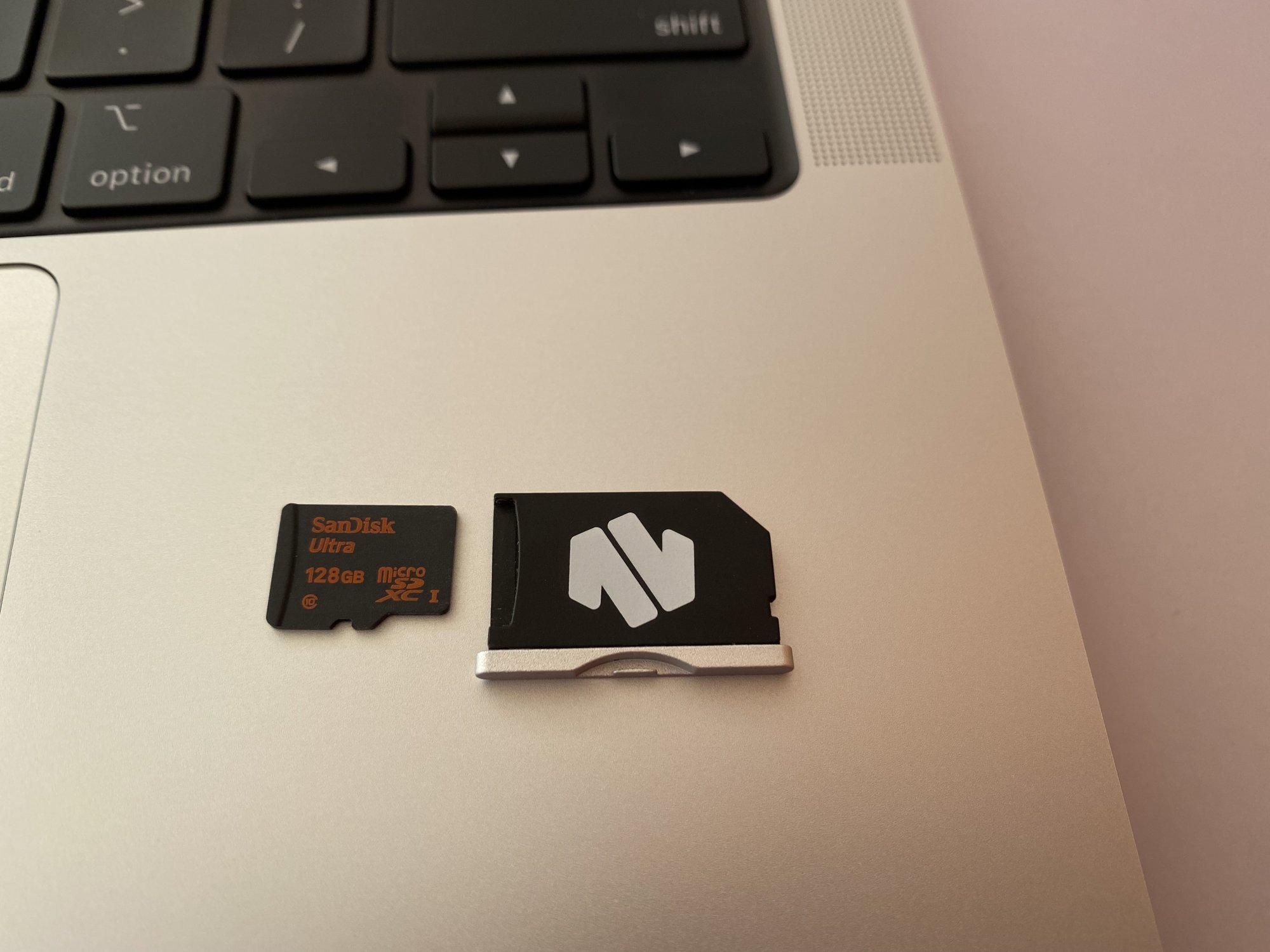

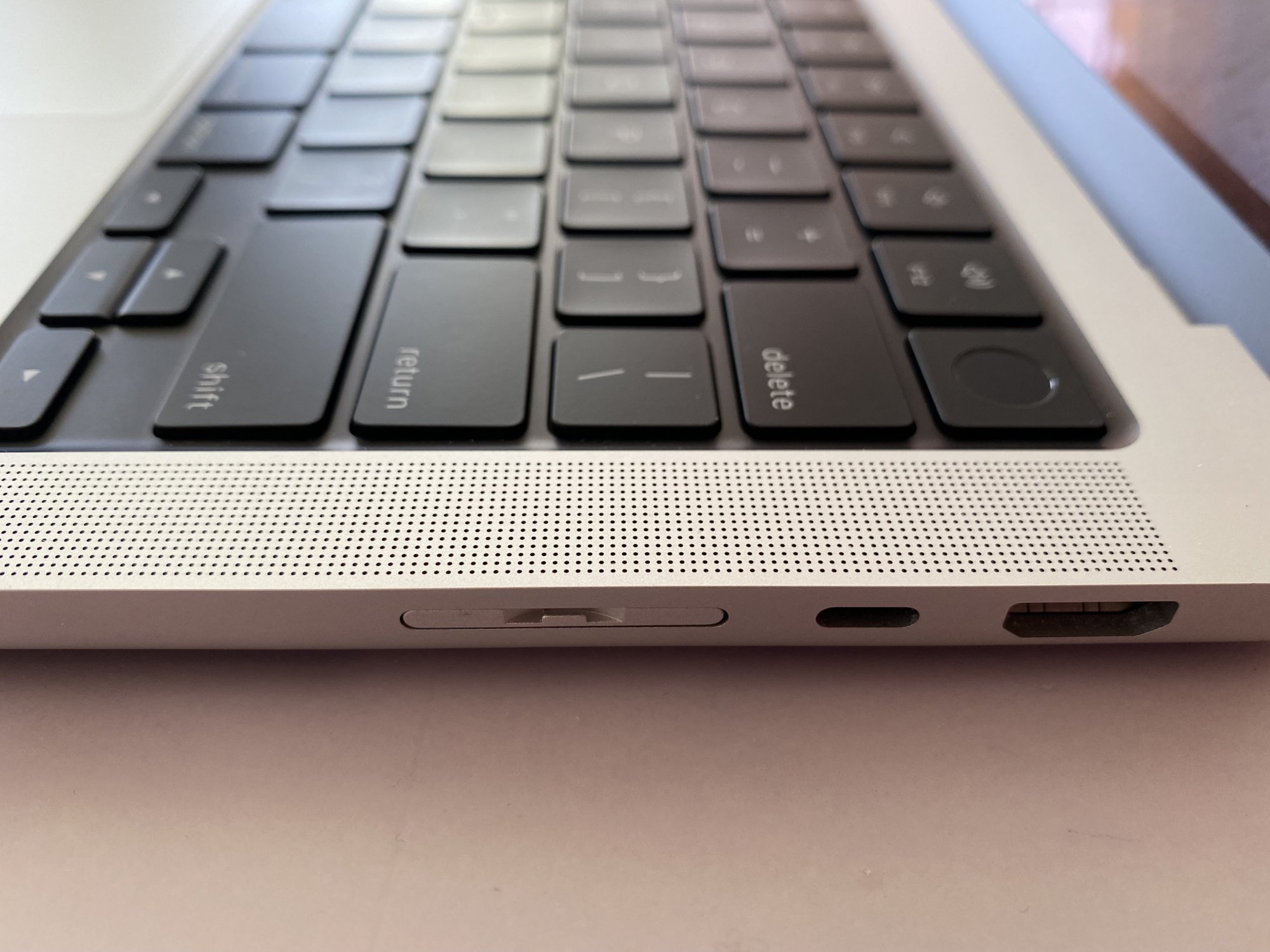

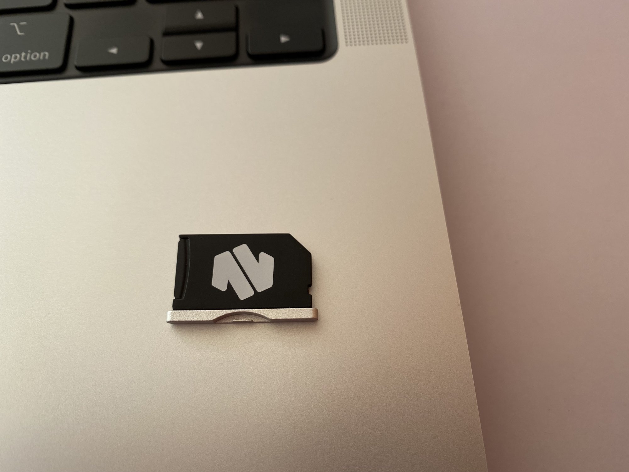

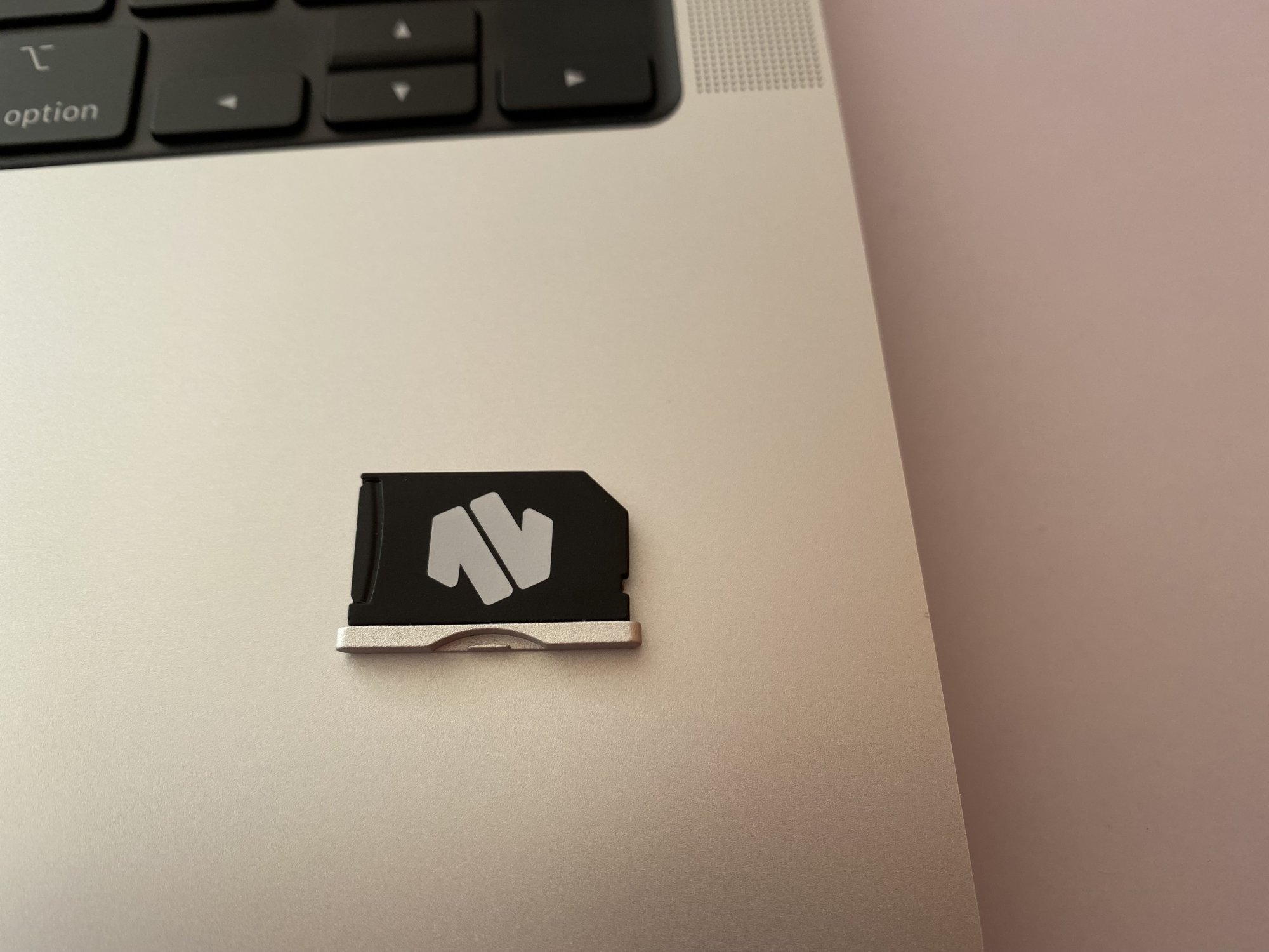

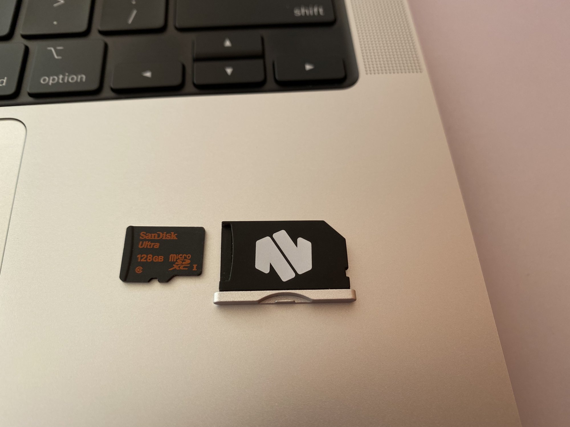

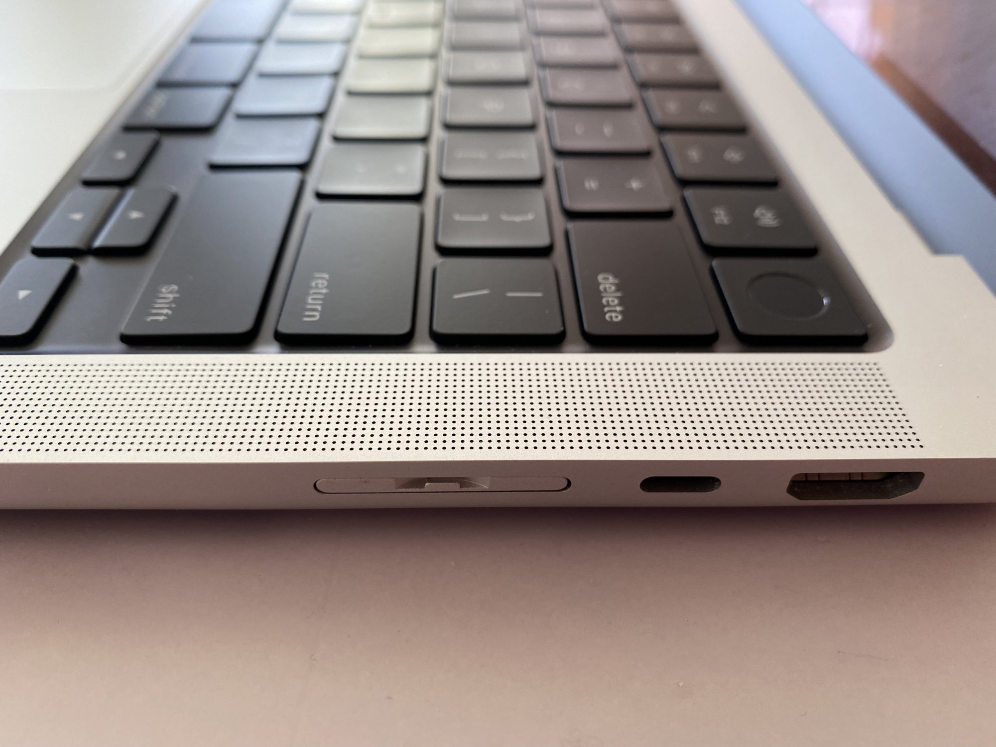

I've found that that some microSD card adaptors prevent my 14" Max from mount my SanDisk Ultra 128GB microSD card (ExFat). Luckily, I can get 37MB/s write and 45MB/s read with my old Nifty adaptor.
