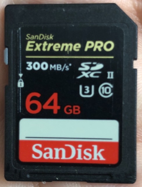

I've just got my MBP14, and tried out the SD slot with my fastest card, which is this one:
With my SanDisk UHS-II dongle I get 240MB/s write and about 260MB/s read
In the Mac's SD slot I get 165MB/s both read & write.
Not *terrible*, but not great either. At least it was able to read and write without issue.

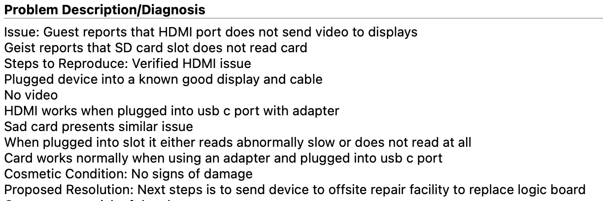

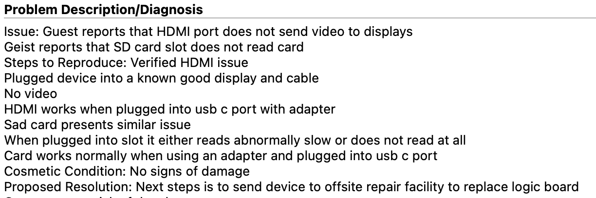

I took my 14" MBP into Genius bar because I discovered the HDMI port was not working, and he confirmed that the logic board needs to be replaced.
I also showed him the issue with the SD card slot. He said that according to their records an HDMI port failure is correlated with an SD card slot fault.
It will be interesting to find out if the logic board replacement also fixes my SD card slot issues. I expect it back in about a week.
I suggest if you have an SD card slot issue, check your HDMI port is working OK if you have not already done so.
