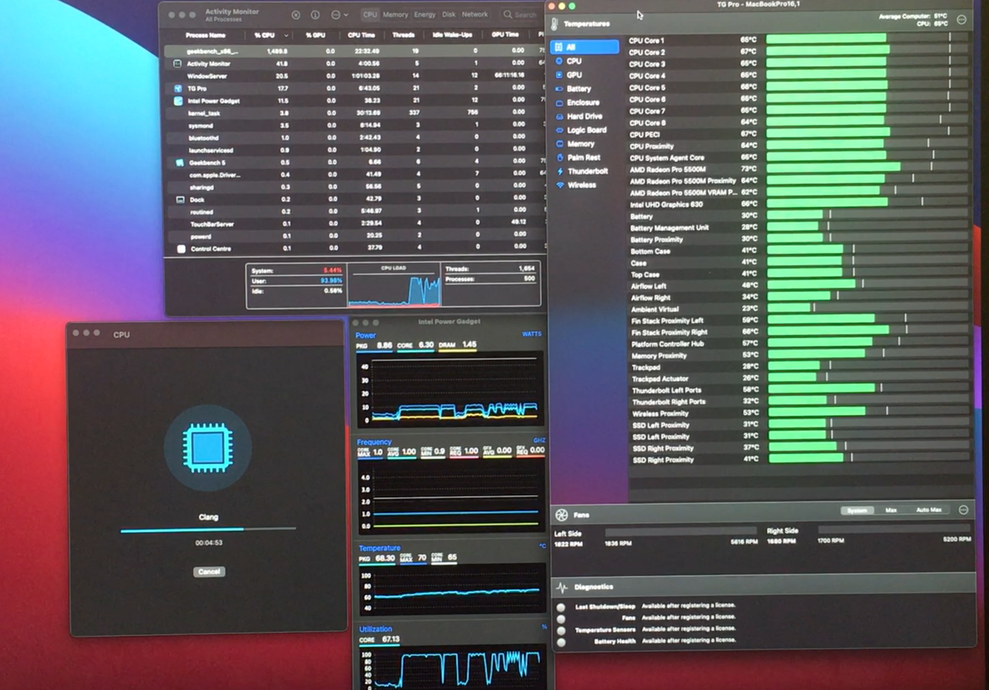

I’ve got an issue with my one. It’s an 8core 2.3 model with 5500m 4GB and 64GB ram.
I’m mentioning this here because I first noticed the problem as general lag. Slow opening apps. Safari slow to load grid of favourites. Slow doing everything including typing etc.
After much investigation, I’ve discovered there is an issue where the CPU reduces its clock speed to 1ghz. It won’t go higher. This issue is resolved temporarily with a restart. Then once a day or so, the problem reappears.
When working correctly I get Geekbench score of around 1100SC & 7200MC. When the glitch is occurs gET around 250SC & 2200MC. It is painfully slow.
I’ve been talking to apple about it and their only real advice is to try a full reinstall and see if that helps. If not, I’ll have to take it to the Genius Bar.
I thought I’d mention it here because it seems like there might be a chance that some of you are suffering from the same issue. The thing that first alerted me to the problem was that the fans weren’t coming on when doing CPU intensive tasks despite everything taking forever.
To check the clock speed of your CPU, search for and install the intel power gadget. You should see that the graph for GHZ varies over time. Mine is a flat horizontal line at 1Ghz.

Thanks, but I'm not sure you've read the whole of my post.
The issue I have is that the CPU doesn't ramp up at all so the fans do not come on. The clock speed of the CPU cores are locked at 1Ghz even if they are only around a temp of 40c.
I think there's all likelihood that this is a different issue to which others are having. I've mentioned it here because some symptoms of it are similar to those discussed.
Edit, here's a screenshot of running geek bench. You'll see the core clock is pegged at 1Ghz and core temperatures are not high, nor are the fan speeds.
