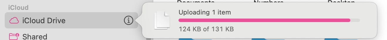

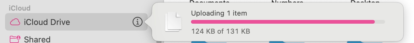

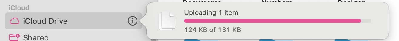

I do think the option of local storage of vaults is a good thing. However, casual synchronization tools like Dropbox or iCloud are inappropriate to handle such critical data. The problem is they work at too coarse a grain. (OmniFocus, for example, talks about this issue when explaining why they provide their own free synchronization service.) And in the case of iCloud, the synchronization is unreliable.
Yesterday Finder was stuck for many hours synchronizing a 90MB file to iCloud. I figured after my morning reboot it would be resolved. This morning, it seems to have made some progress, but is still stuck.
I've been unable to figure out which file is stuck. No icon on folders or files I've looked at show anything in progress. I'd feel very uncomfortable if there were a chance that the stuck thing was my password vault.
I don't mean to imply that iCloud's own Keychain/password synchronization has this issue. I know nothing about how they do that.
The only way I can imaging working comfortably with synchronization of local vaults is if the password program itself handled it. Some do with LAN-based synchronization and some with dedicated servers. Offsite backup is a separate concern and should be handled by dedicated backup tools; I use Arq Backup for this.
