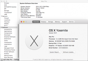

What the prize was? ;) :p :D
Installed on a 5,1 first, I was too lazy to build an installer.
Removing boot.efi requires adding rootless=0 to com.apple.Boot.plist.
Or just remove it under another OS.

Congratulations, and thanks for the good news. I take it for granted that you substituted Pike's boot.efi for the original one. Or did you use any of the boot.efi files created by Andy Vandijck for Yosemite?

Is Metal working with the 5870? Assuming it's ready to use in the dev preview.
