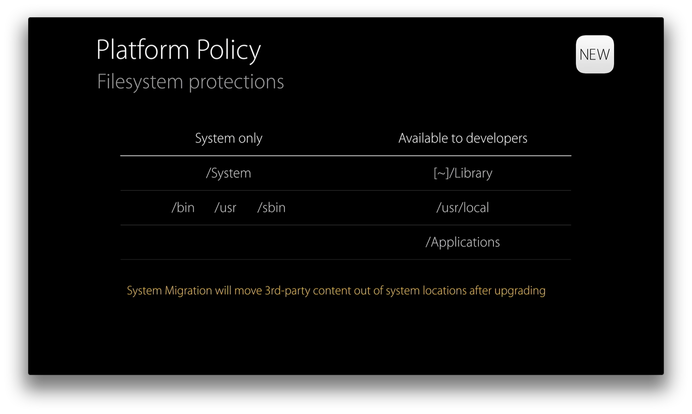

nope, this won't work for various reasons. first, the App Store will not download El Capitan to a MacPro2,1. second, everything residing in the system locations will be moved out during the upgrade procedure (see attached screenshot) and one of the two copies of the boot.efi file resides in /usr/standalone/i386/ and the other in /System/Library/CoreServices
