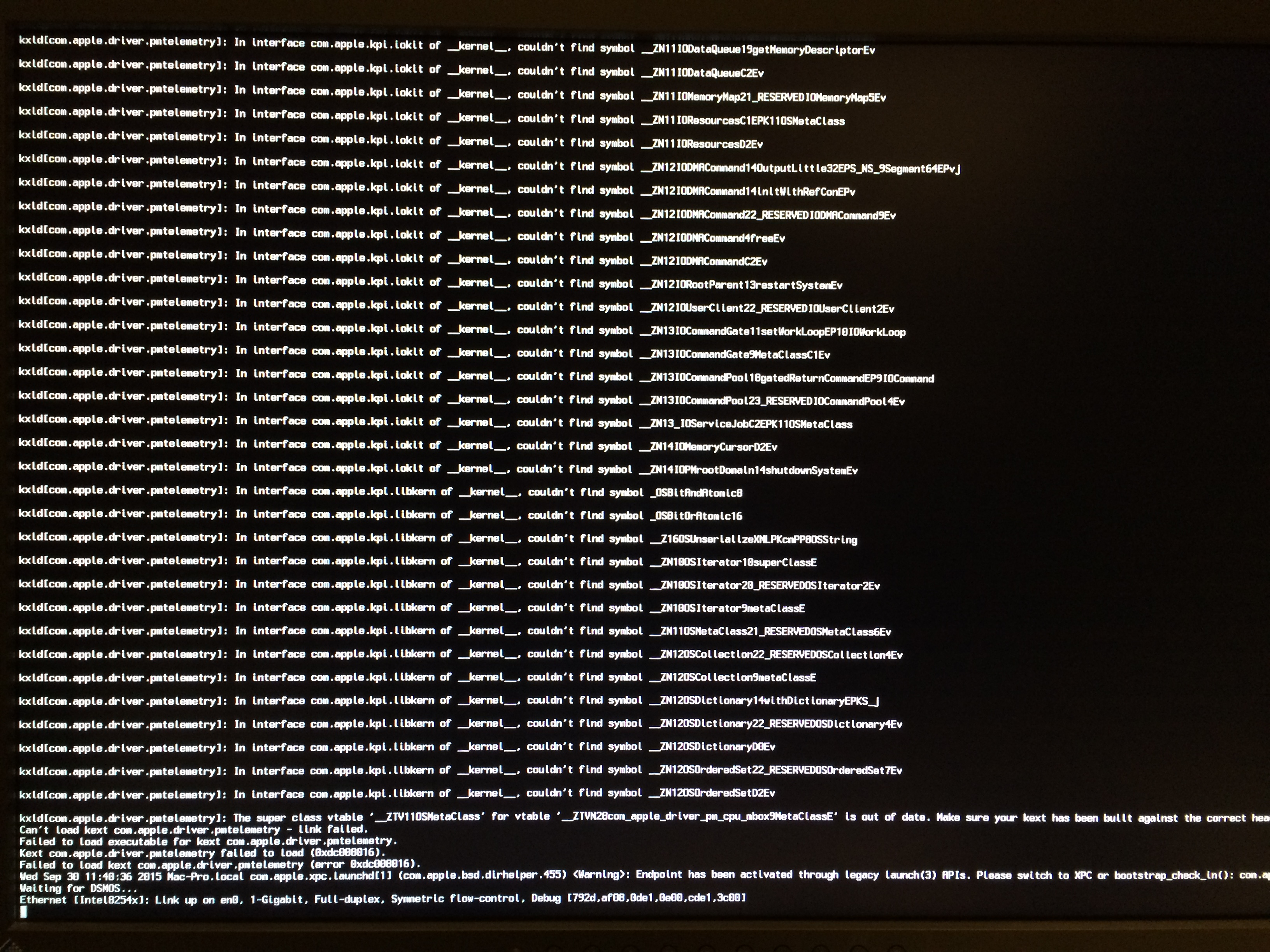

commit 3f996378a0ff0f21a2da152fefddeb436af7598b:
gives endless loop/flow of increasing/changing values. doesn't boot.

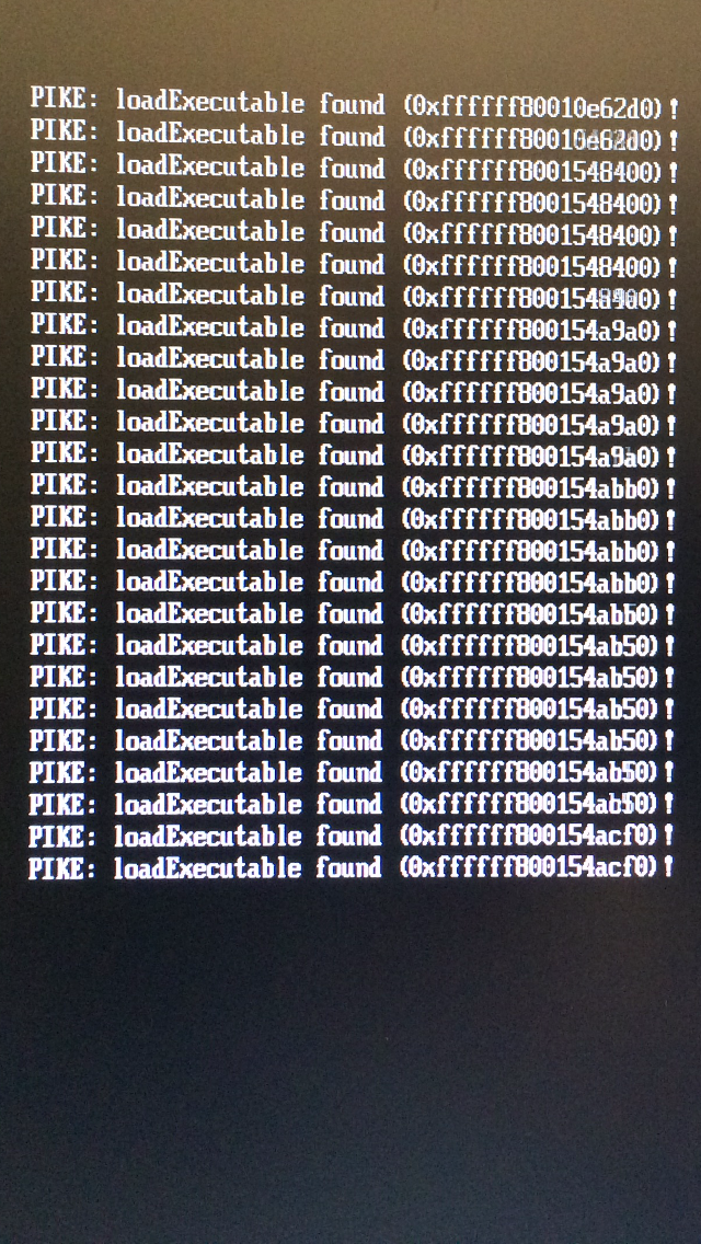

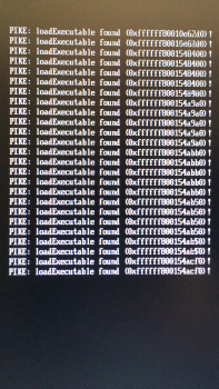

Fix endless stream of data.
To everyone interested in this project:
[P]eople must be aware that [this and other] interim future versions are NOT intended as a replacement for the official repository versions. Until further notice, those of you who want to use Pike's boot.efi ought to go to http://piker-alpha.github.io/macosxbootloader/ and download either the "black" version or the "grey" one, according to your particular preference (the change is purely cosmetic; otherwise, they are exactly the same; the choice is irrelevant as far as the operating system is concerned). Pike alone will decide when such repository versions will be updated with a newer version.
Please, notice that the [enclosed and other] upcoming experimental versions might contain bugs that could cripple your ability to boot your old Mac. So, unless you are absolutely certain of what you are doing and know how to reverse such undesirable situations, KEEP AWAY FROM THEM. In general terms, [these] versions ARE NOT FOR YOU!
  • boot 31851607e8ce47ab4f4ec9e5f8080e383c8803c6.zip

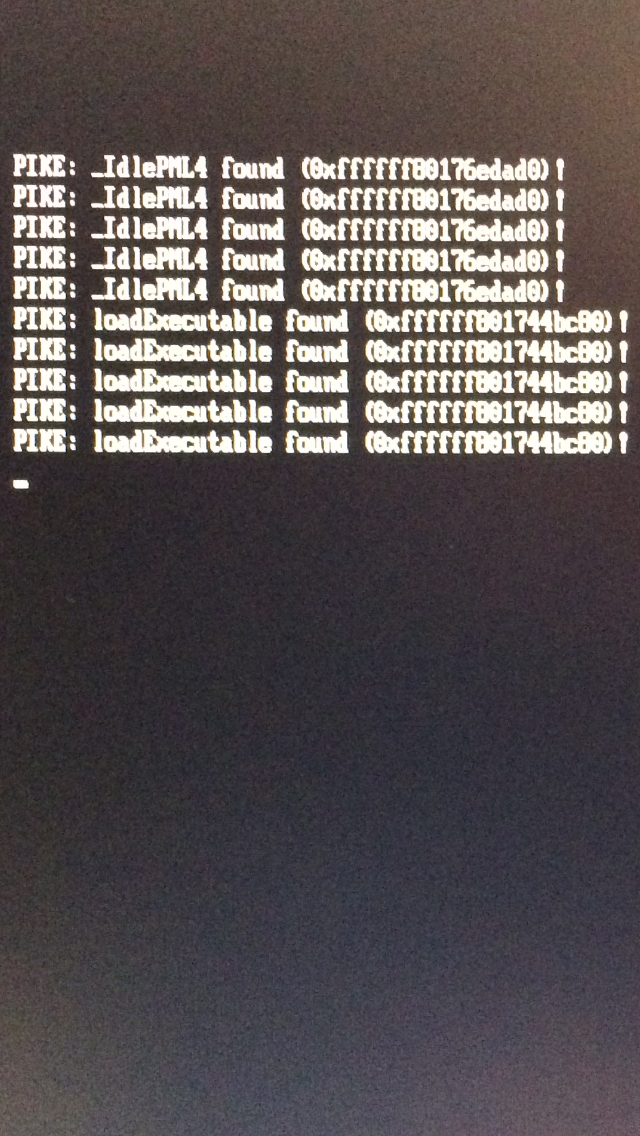

Restricting search. Even more restrictive (__TEXT,__text only).
PS I'll be back in about one hour.

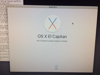

hi all
I just created a USB Installer Disk and replaced the boot.efi with Pikes latest macosxbootloader.
All seems to be good with booting on my Mac Pro 1.1 with a flashed Radeon 4870.

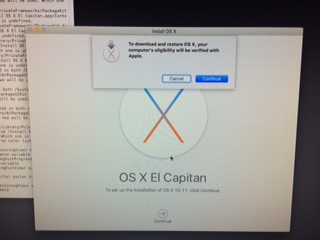

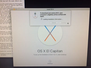

I stuck now on the installer... he shows me always "OSX El Capitan is already installed"
It looks like Apple have a online check in the installer for verifying supported Mac models.
