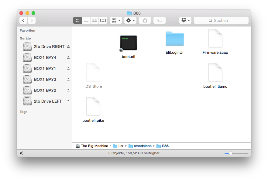

Is there a way how I can check if have the pikeyosefix script installed?
I honestly forgot if I just changed the efis or ran the script two months ago.
If there was a way to check and make sure, that would be great. Thanks guys!

Go into your /usr/standalone/i386 folder you should see a boot.efi file with the name containing pikeyosefix or something like that.
Looks good right?

Why don't you just reinstall it? it's harmless. Run the installer, restart twice and voilà.

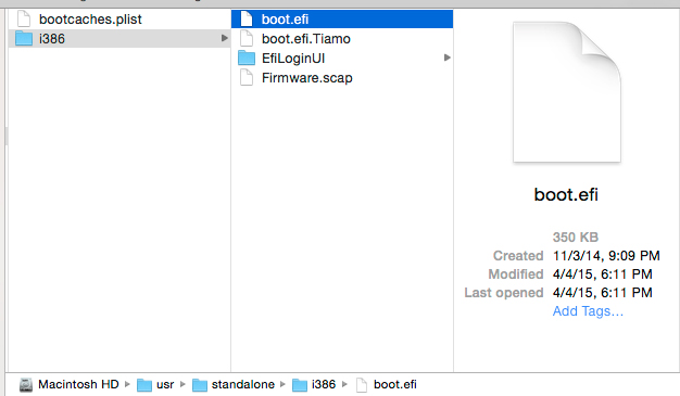

That would have been my second idea if there was no way to tell if I already have it run before. But the screenshot looks like I have, no?
boot.efi.pike
I don't seem to have the boot.fi.pike folder, but I remember doing the following:
"Just to be clear (sorry for being the dimwit!), you (one) runs the tobyg script: https://forums.macrumors.com/showpost...&postcount=891
and then,
1. Install the script but DO NOT restart.
2. Delete the installed boot.efi.tiamo in the /usr/standalone/i386 folder
3. Duplicate the boot.efi file that is in that folder (command + D)
4. Change the name from "boot.efi copy" to boot.efi.Tiamo
5. Restart
Then, after this previously described procedure, you run the update to 10.10.2 from the Apple App Store??"
I have the boot.fi.Tiamo. Am I missing something??
Do I need to (re)install something else??

If you did that then you are fine.

Could someone please verify quickly if this is what it's supposed to look like when I have the pokeys fix installed? :)
Thanks a lot!
Confirmation

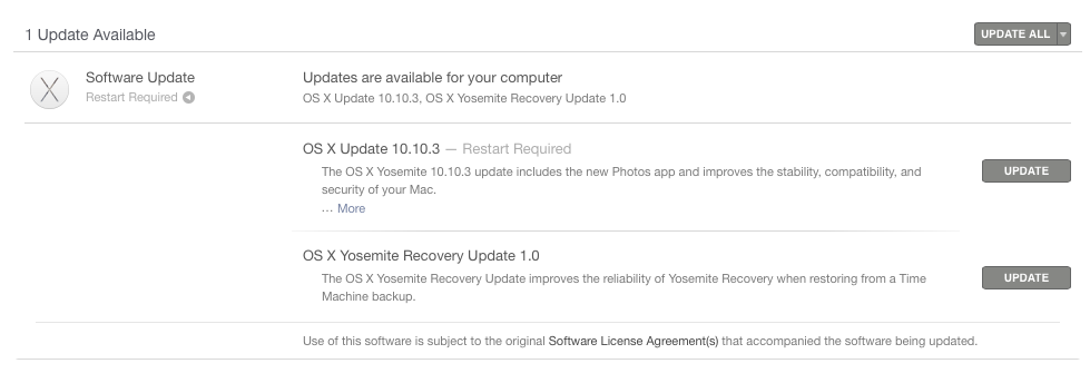

ITS safe to upgrade to 10.10.3 and Recovery Update 1.0
Today apple have 2 Software updates Mac Os and Extras:
ITS safe to upgrade to 10.10.3 and Recovery Update 1.0 ?

I installed 10.10.2 by following the instructions here. Just updated to 10.10.3 with no problems. Did not see the second update people are mentioning i.e. the Yosemite Recovery.

I got similar one. And I clicked update all and now I am using 10.10.3.
No problem at all. I updated them at the same time.
