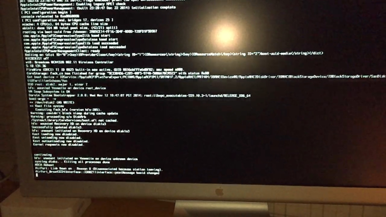

I tried to delete the bootcache.plist and the problem doesn't occur anymore. However I decided to investigate a little bit and with the help of a slow motion video taken with the iPhone I managed to capture the instant just before the first reboot.
Apparently the problem is that boot.efi is not in the boot cache, prelinked kernel or something like that.
I played a little with kextcache but I haven't figured out how to solve the issue yet.
I finally managed to solve the "double boot" issue by simply booting OS X into safe mode and then restarting (keep pressing shift until you get to the login window, even during the reboot, you should see "Safe" something written in red in the menu bar).
It seems that this procedure invalidates and rebuilds all the caches the system uses, including the boot cache that was my issue.

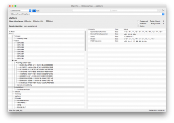

Guys, those who have flashed 1.1 to 2.1 and have Messages running fine:
could you try to run ImessageDebug tool:
http://mac.softpedia.com/get/System-Utilities/iMessageDebug.shtml
and tell me if it shows "System-ID: failed" or not.
It shows Failed on my mac pro
==============THIS IS HOW IT SHOWS UP AT MINE ==========
Model: MacPro2,1
Board-id: Mac-F4208DC8
SerialNumber: CK70904MUPZ
Hardware UUID: 00000000-0000-1000-8000-0017F2071DCC
System-ID: failed
ROM: 0016cb790f4e
BoardSerialNumber: 9N705006FVNBA
Gq3489ugfi: 28f0b13d1f7352966e38f95f24744e0619
Fyp98tpgj: d5531b0be2e851c0d76612aa86e8db5dd0
kbjfrfpoJU: c454b9af0ee0d6302dbcfdaa6cda4f1cae
oycqAZloTNDm: 837784632293e03a5055587aaf4e027828
abKPld1EcMni: 1c56124cd2bb3ed8a877fb13551b8144e3
it looks like my UUID is weird : too many zeroes:
and IORegistryExplorer can not see/show system Id property
That looks like what my Mac Pro UUID looked like. A bunch of zeros followed by your MAC address.
