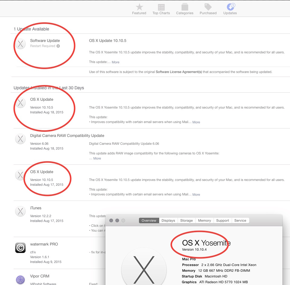

Updated twice via ApStore to 10.10.5. finished the download, installed the update normaly
and the version is still at 10.10.4, and the ApStore insists to update to 10.10.5
