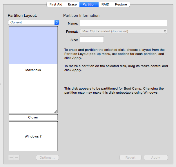

Here is my diskutil list:
Code:
/dev/disk0
   #:                       TYPE NAME                    SIZE       IDENTIFIER
   0:      GUID_partition_scheme                        *500.1 GB   disk0
   1:                        EFI EFI                     209.7 MB   disk0s1
   2:                  Apple_HFS BOOT                    942.7 MB   disk0s2
   3:                  Apple_HFS Installer               8.0 GB     disk0s3
   4:                  Apple_HFS Yosemite                490.0 GB   disk0s4
   5:                 Apple_Boot Recovery HD             650.0 MB   disk0s5
/dev/disk1
   0:      GUID_partition_scheme                        *1.0 TB     disk1
   1:                        EFI EFI                     209.7 MB   disk1s1
   2:                  Apple_HFS Mavericks               700.1 GB   disk1s2
   3:                  Apple_HFS Clover                  939.5 MB   disk1s3
   4:       Microsoft Basic Data Windows 7               298.7 GB   disk1s4
Clover is the partition I am using to boot Yosemite. The BOOT partition is what I was using but it is currently empty. NOTE: disk1 is actually in slot one but the machine identifies the disk in slot two as disk0.

1. I have been using the version of disk utility that is part of Mavericks. Disk utility can non destructively resize HFS+ partitions on a GPT.
2. I think I am using Clover r2774, I will double check that on my next reboot.
3. Yes that is where the SSDT-1.aml file goes.
That one definitely adds CoreVolume, even if you just format one of the partitions. So that does not seem to bother Clover?
Darn, just realized, my Boot Camp disks already have 4 partitions (they are all 4TB) - which is the max for legacy MBR boot to work.
Honestly, I have never encountered core storage. I do not use the bootcamp assistant utility provided by Apple. I partition my disk using disk utility and then add the hybrid MBR myself. Now this might only be because I am not using any disk larger then 2.2TB (the MBR limit).
I added that Clover partition last week and it did not add any CoreStorage. Here is a screen shot of the partition in disk utility:
You can use larger disks as long as the Boot Camp partition is below the 2TB boundary and you do not have more than 4 primary partitions.
